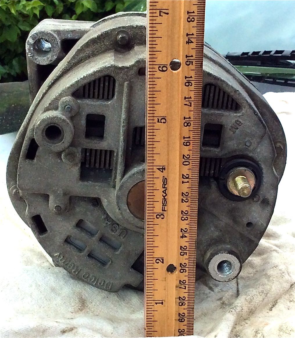

Well, I took the Monster alternator back and looked for a DR44G again. Learning from other members threads is often a great opportunity to learn from their mistakes and choose well (I hope.) Now that I know what they look like, I guess I just have to find one with a 4 pin regulator. During the course of my search I rolled a little one off of a blazer and cut the plug to test fit with.
Since I was just there a few days ago I didn't expect much but I expanded my search to include ALL GM trucks, vans and SUVs. I found another monster on a Chevy Express van and other big ones that had no labeling on them. I found a 2002 GMC Envoy fully loaded with a DR44G. It was hung all wrong from what I expected. The belt didn't follow the path I'm used to seeing at all. Since it was not on a van; I can't understand why they mounted it on the drivers side under something else. The mounting bolts don't even go in from the front. They are short and mount from the right side.
The yard closes at 5 and it was 20 mins til; so I decided to come back when I was more sure of taking it. I may have to untangle it from all the other appliances and pull it just to test the Regulator plug and look for "standard" front mounting holes to see if it will mount "normal".
This little upgrade is becoming a project of it's own and I still can't even get in my back window. I gotta re-prioritize. lol

Which alternator is that a picture of? If it has DR44G stamped on the front that is the one you want (as long as it has the 4 pin connector).
