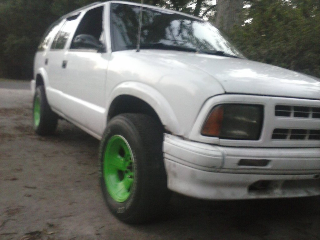

So they came out a little blurry, need to invest in a new phone next. But, here is the paint work I was talking about. Not very traditional, then again I've never been either. I like the look a lot, while I know that others may not, it's fine. That's the joy of it, everyone has their taste. Next up, interior modifications.

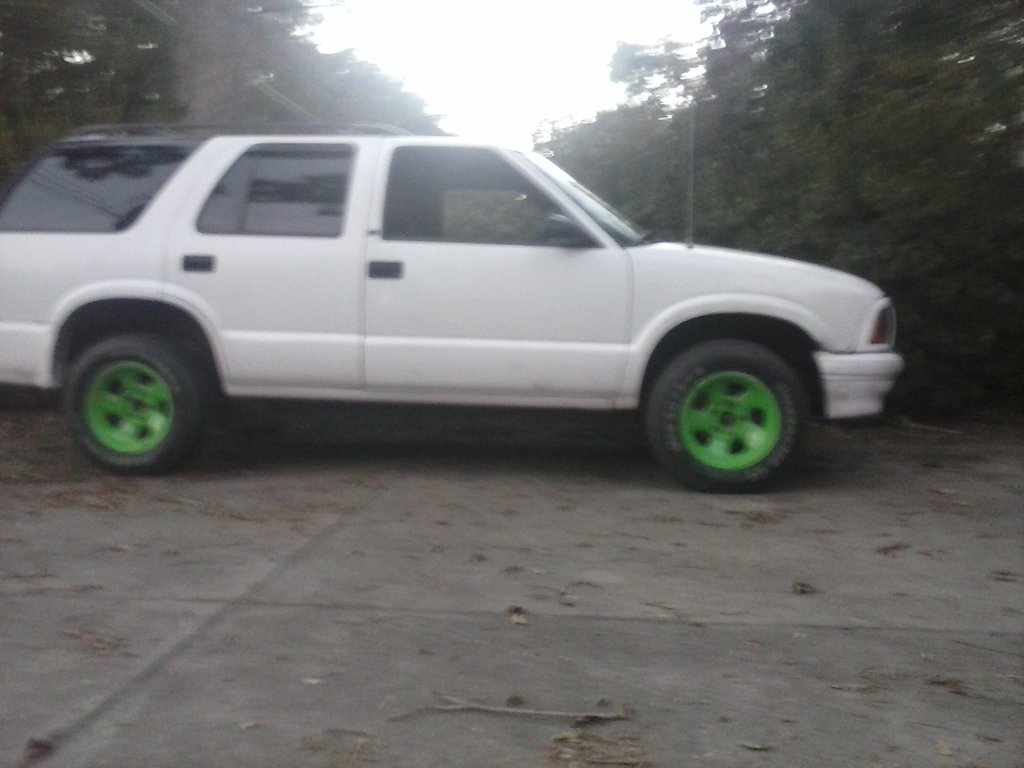

I will try to get some no blurry ones tomorrow when it's cleaned up and aligned. You can tell the caster is way off.
