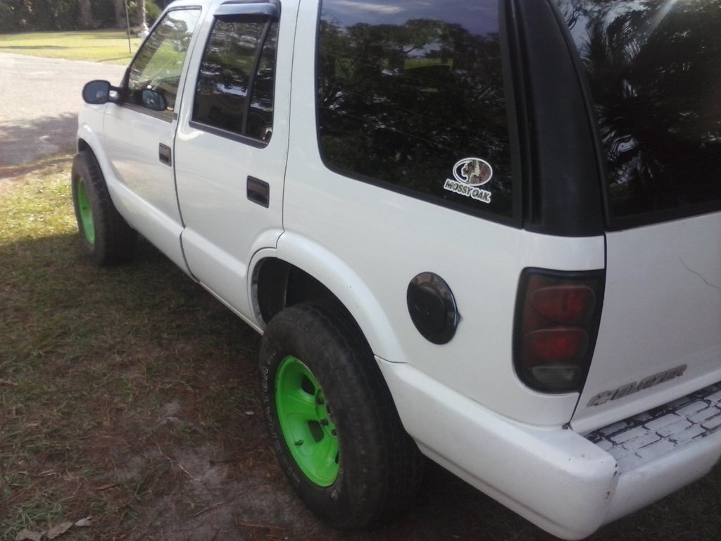

I have also decided upon a name. "Swamp Thing"

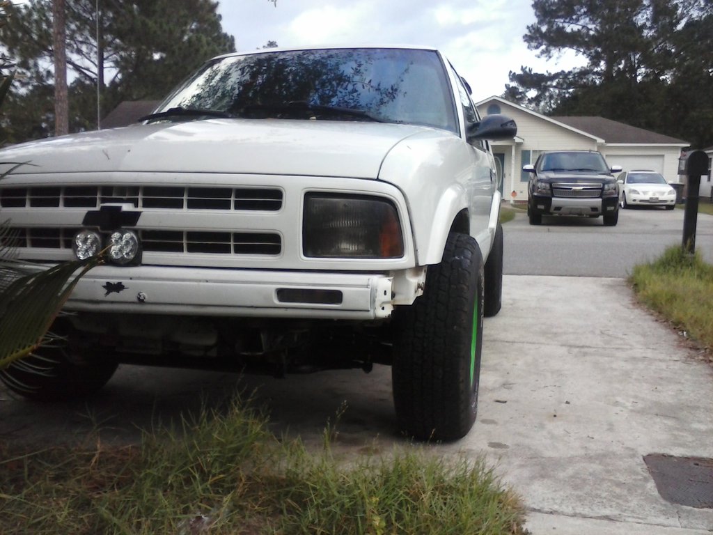

Cleaned up and got rid of that ugly valence finally. Also took off the bumper sides, being the blow out destroyed the one on the passenger side.

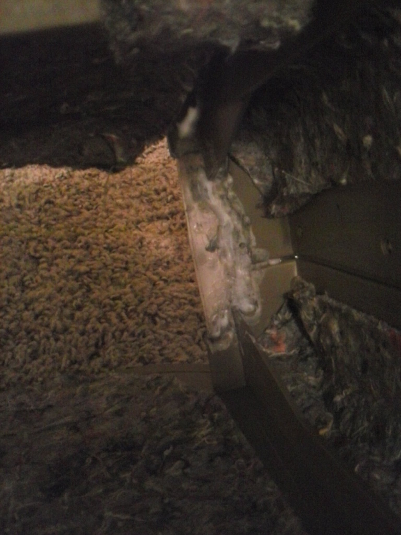

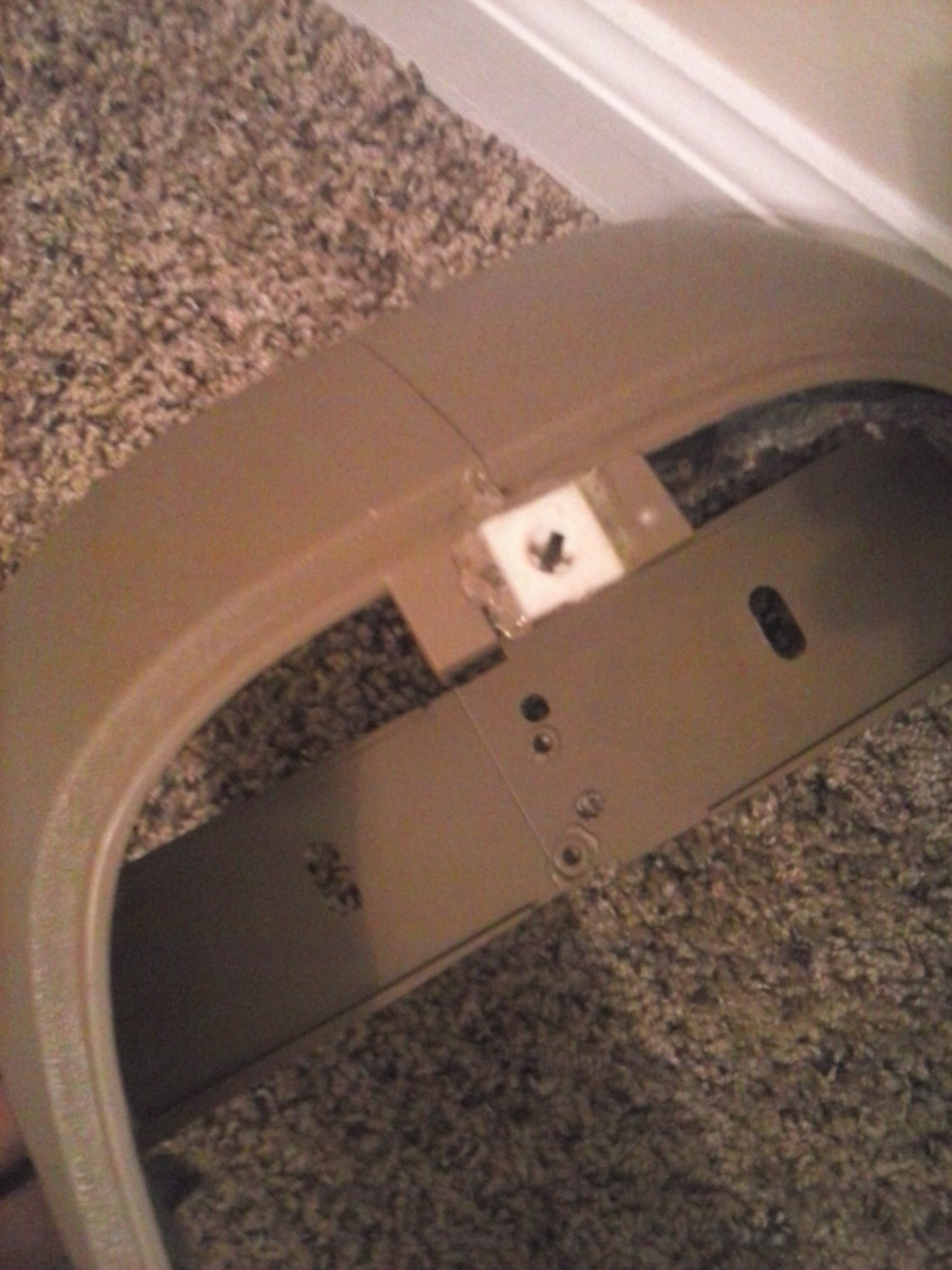

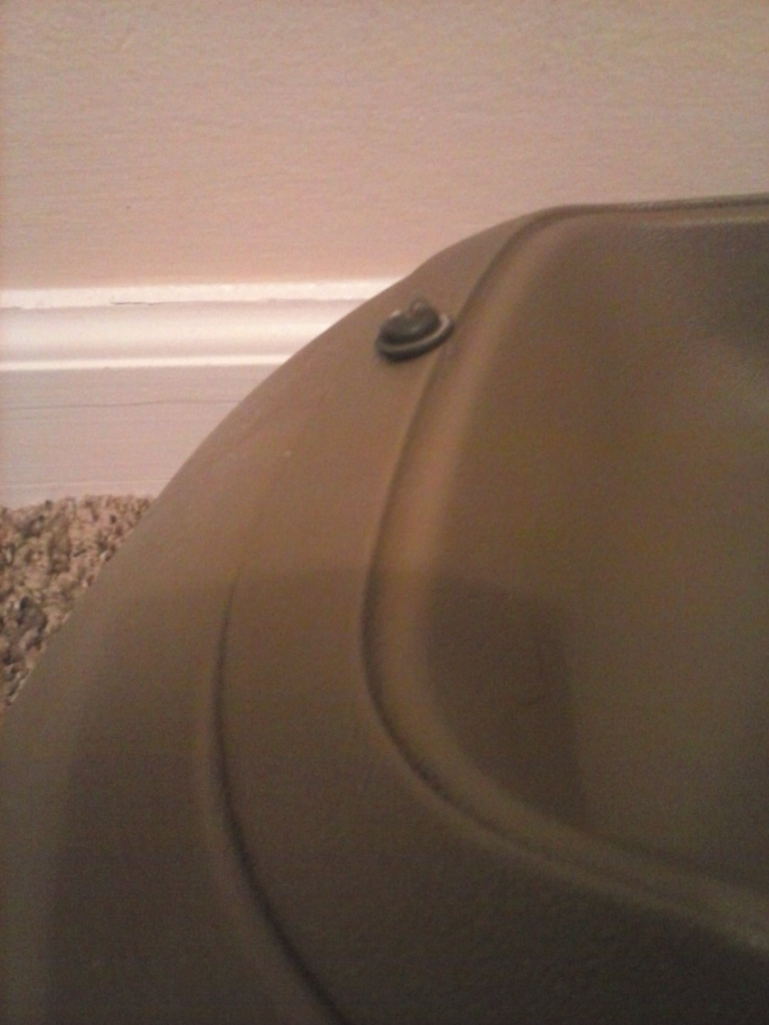

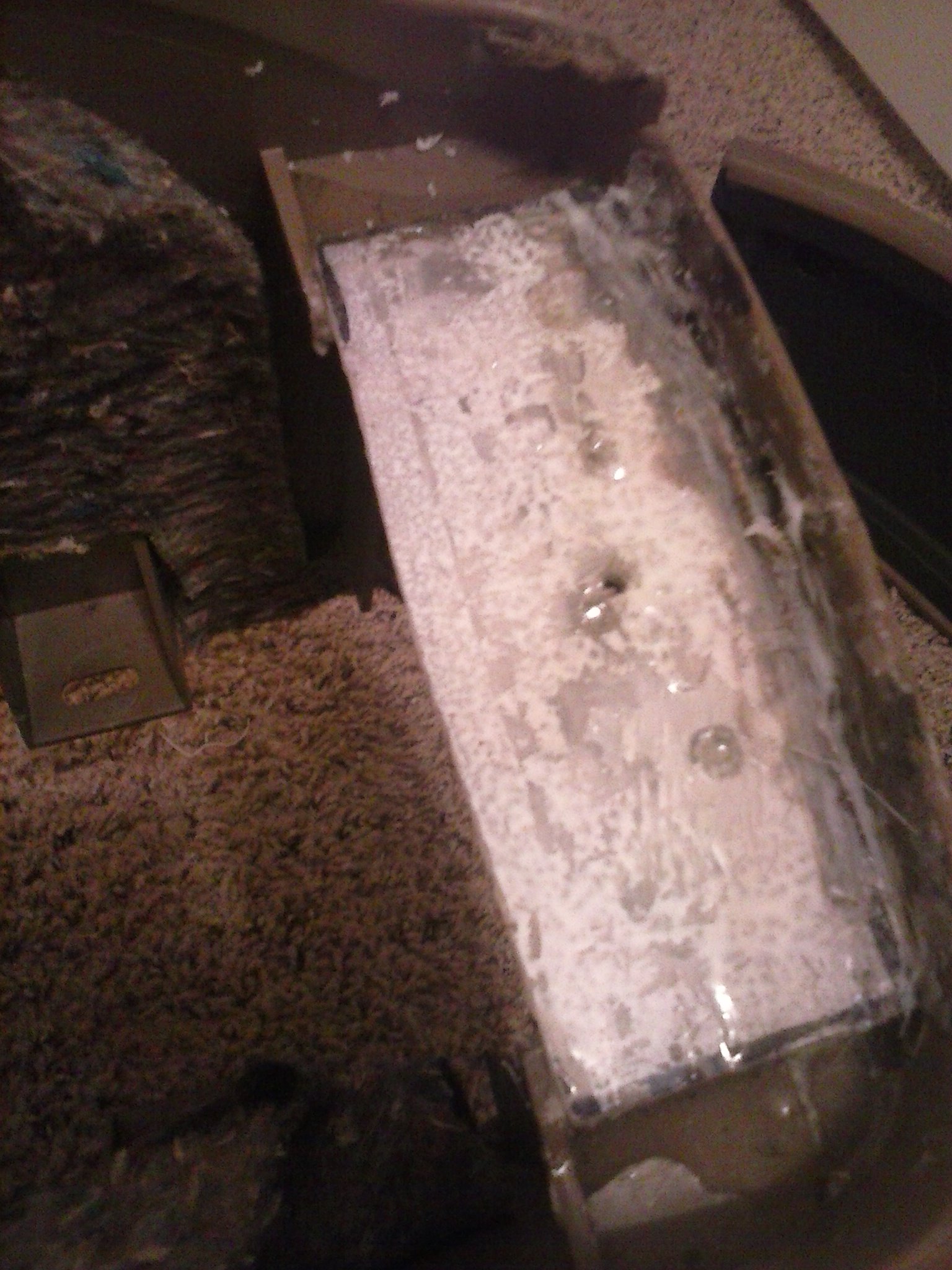

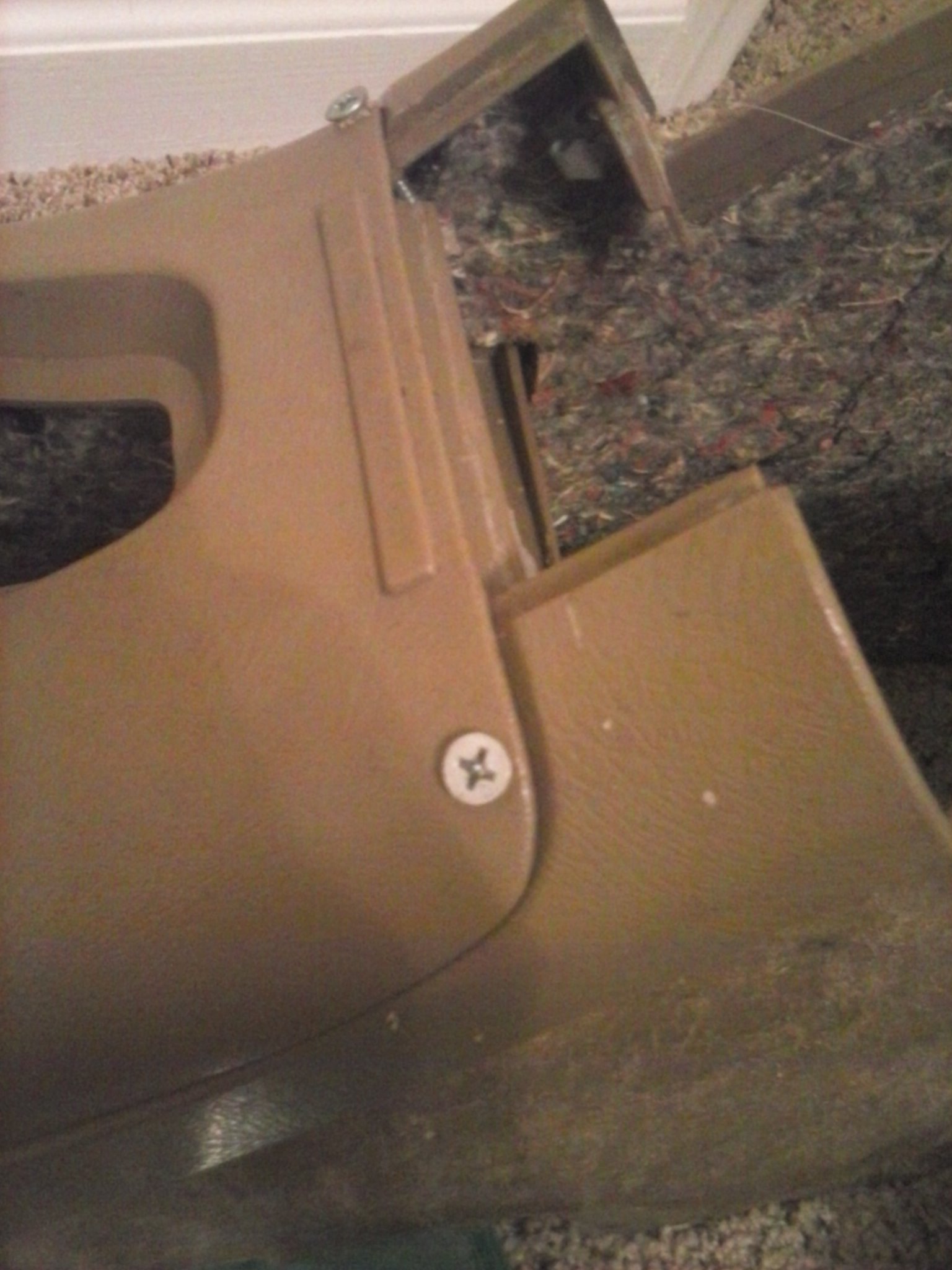

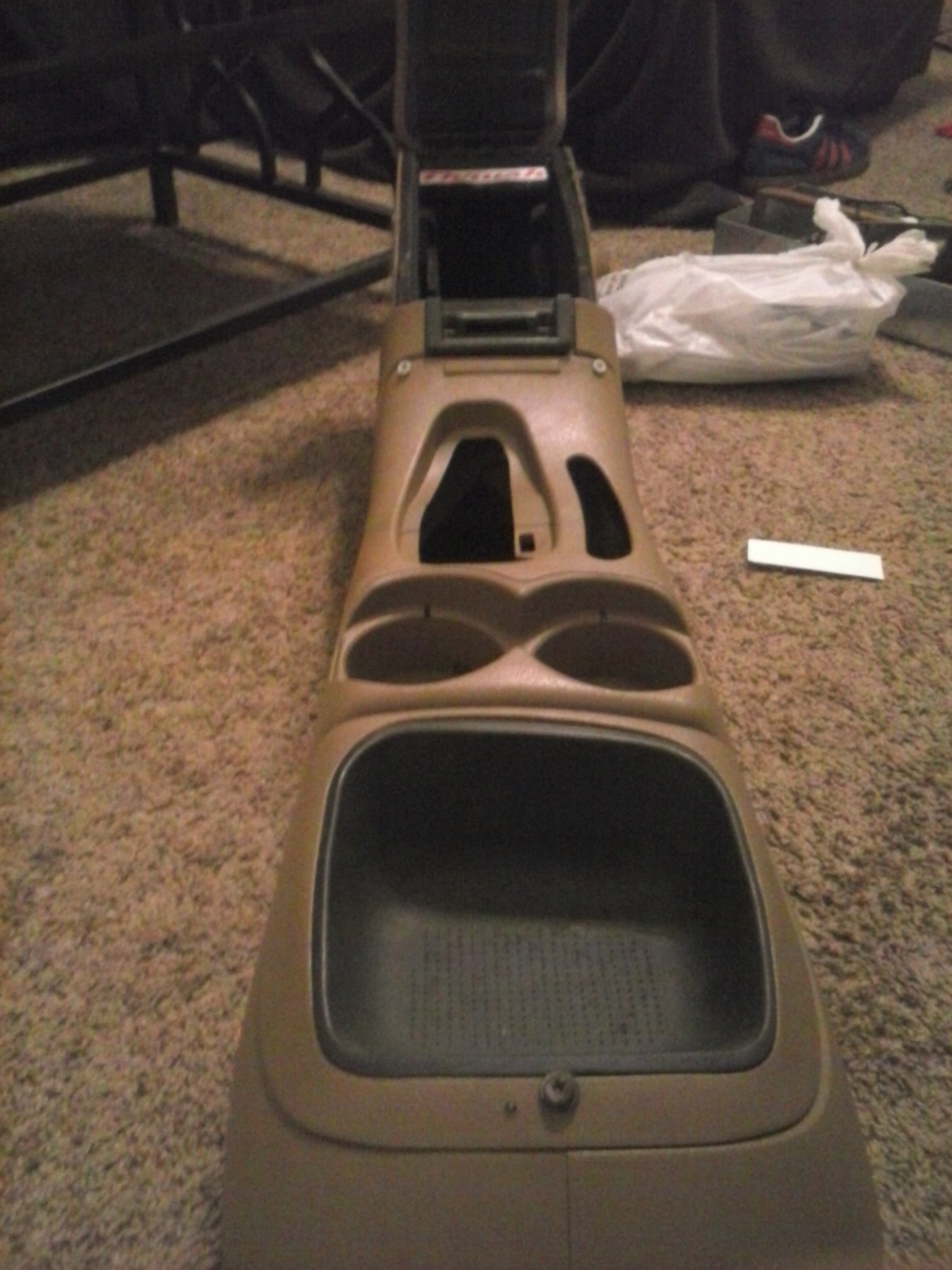

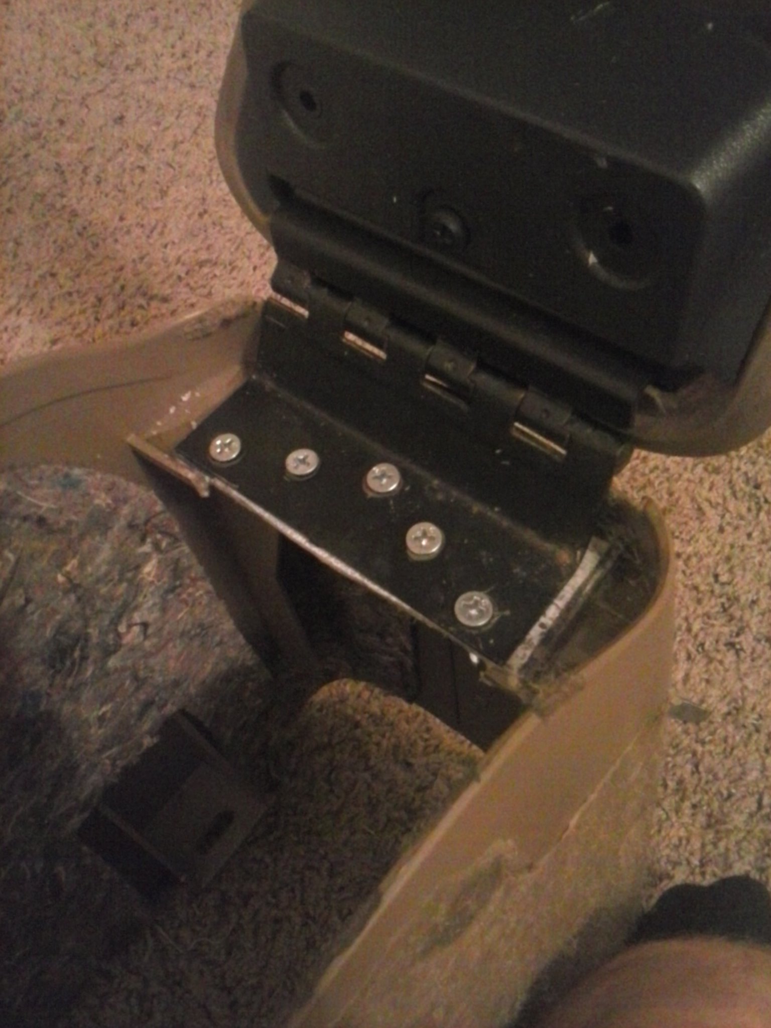

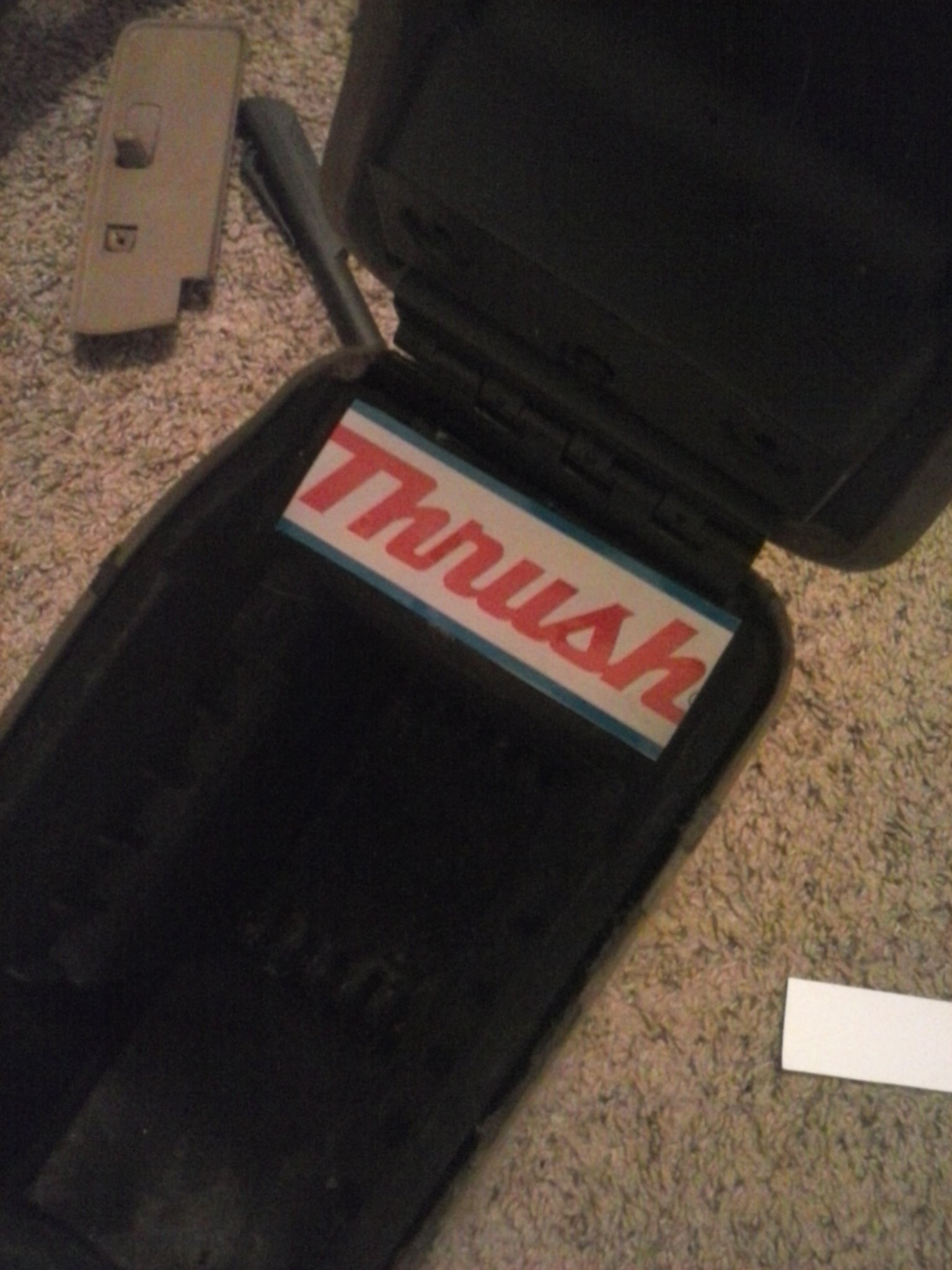

I finished the center console. What I did: (Pictures below)
This time I took the two prior pieces of plastic and super glued them on. Then, took some new epoxy and reinforced the edges. Then, I took a plastic coat hanger (bare with me here) and a lighter. I cut of the bottom longest portion of the hanger and set it ablaze. I let the hanger burn until it started to drip molten plastic. I got close as if stick welding and practically welded the two pieces top and bottom to the console. Had to relight a couple times. I know this sounds "shady", but hey, it worked. The floor shift bezel fix pretty much speaks for itself. If you wanted you could go buy the license plate screws that come with chevy logo caps that fit over the heads for a cleaner look.
