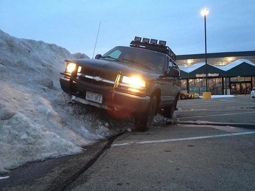

I got tired of the brush guard and not having front hooks to pull my buddy's Toyota Pickup out of giant snow banks he attempts to go through, so I did some front D-Rings (I got the idea from Rexmburns build thread)

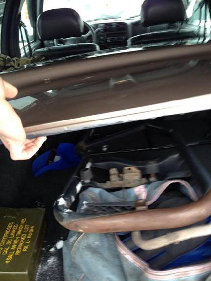

I eventually went to the junkyard even though it was 0* out to try and find some ZR2 flares and a rear tire carrier. The Flares were a total bust, but I found the tire carrier and this little jewel.
and everything got crammed in the back of the truck

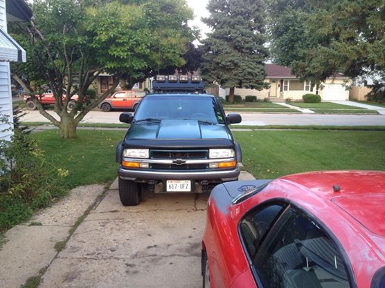

After paint I got it on the truck, nice 2" cowl hood
and that's where she sits right now, but I'm hopefully picking up some ZR2 fender flares and aluminum skid plates in the next day or so. So that will be the next project

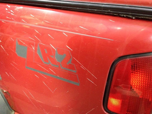

But last night, I drove up to Iron Ridge, WI and picked up a 95 ZR2 rust bucket.
The fender flares are hardly on anymore, but plans are to put the flares and skid plates onto the Blazer and possibly the visor depending on how I like the look. Its got the the 3.73's and I've got the 3.42 gearing. Which I would like to put on my truck, but is it possible to directly swap the rear end and front diff/trans over onto my Blazer so that I've got 3.73 gears? Since its a 95 and I've got a 98 (they're both the three button so NP233 case I think)

Everything should swap over without to much hassle. The rear axle will be a bit wider. You don't have to swap the trans and transfer case for the front just the diff which will swap over. The only advantage of swapping the tcase would be if the Z had a 231 manual shift.
