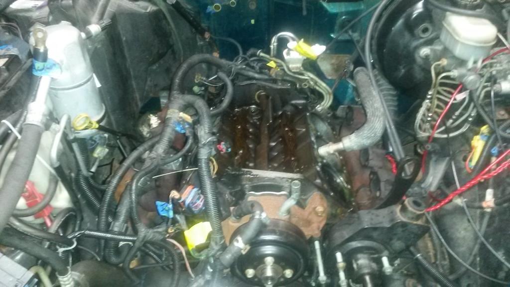

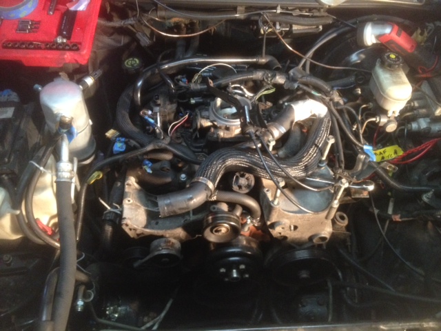

So its been a while, things have been progressing slow between subzero temperatures and being just plain busy. So this is her when I parked her in the garage right next to my Celica (note: the plow is not attached to the Celica lol).
Started pulling all the top end stuff off to get the lower intake removed.
After removing the intake, I also pulled the heads cause I wanted to check them out closer. Removing them with the engine in the truck was a huge pita but I did get them out.

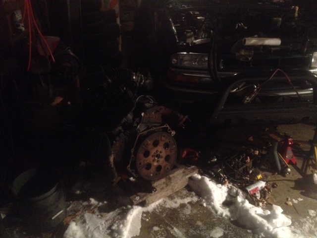

After I got that far I went out ice fishing for a few days and when I got back I found a 5.7L engine out of a suburban with 150k that I picked up for dirt cheap. The worst part about the whole trip was trying to remove the engine from the back of the pickup that was lifted 4" and has 33s because the engine hoist wouldn't reach high enough. I also had to get another engine stand to bolt it onto since the only stand I had has a Lexus V8 bolted to it currently lol. So this week the plan is to start disassembling the 5.7 to look at it closely and get the 4.3 block outta the Blazer since I won't be using it anymore.
And it sits right next to the Blazer in the garage for now until I get it on the stand and free up some extra space to work on it.
