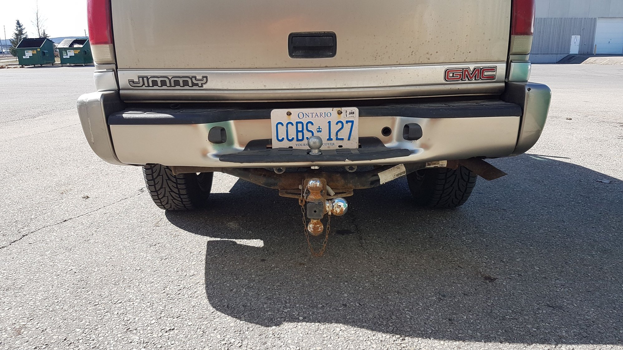

Default Work on moms jimmy
Old plastic
New to mom aluminum
Old rusted
Cleaned up yard bumped freshly painted
The plastic piece on the fender was missing since purchased a year ago, so finally installed the piece i grabbed from the scrap yard.
