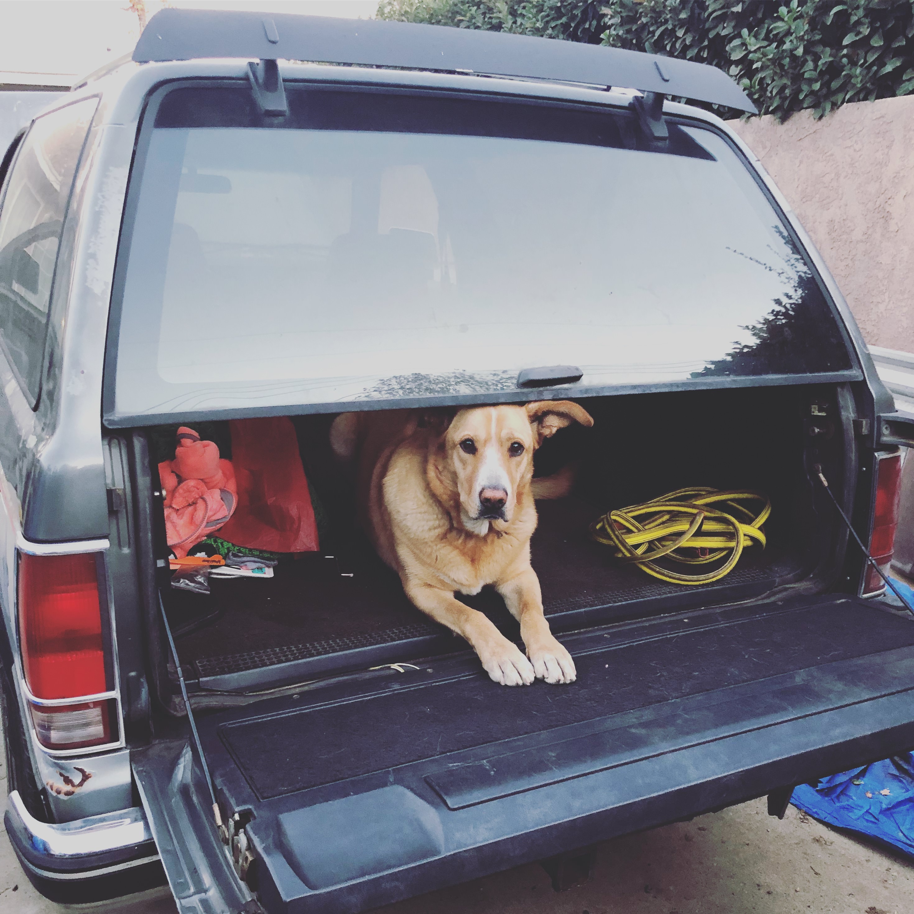

The pupper already loves it
The rear window shocks hold maybe 1/20 times lol
