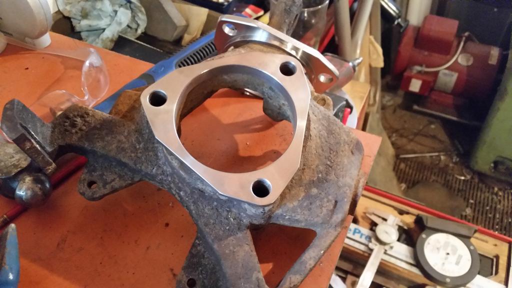

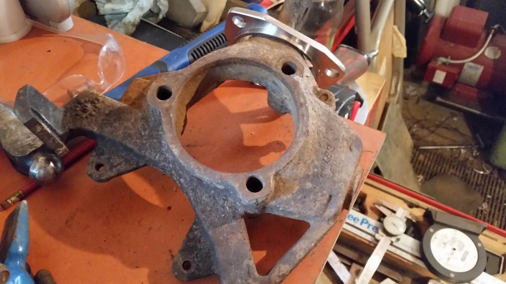

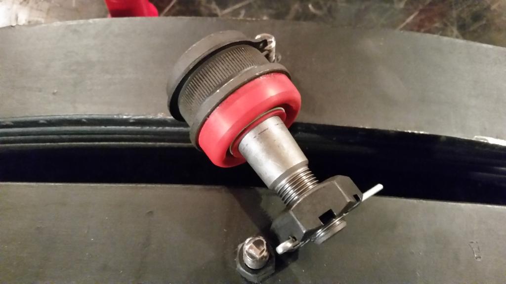

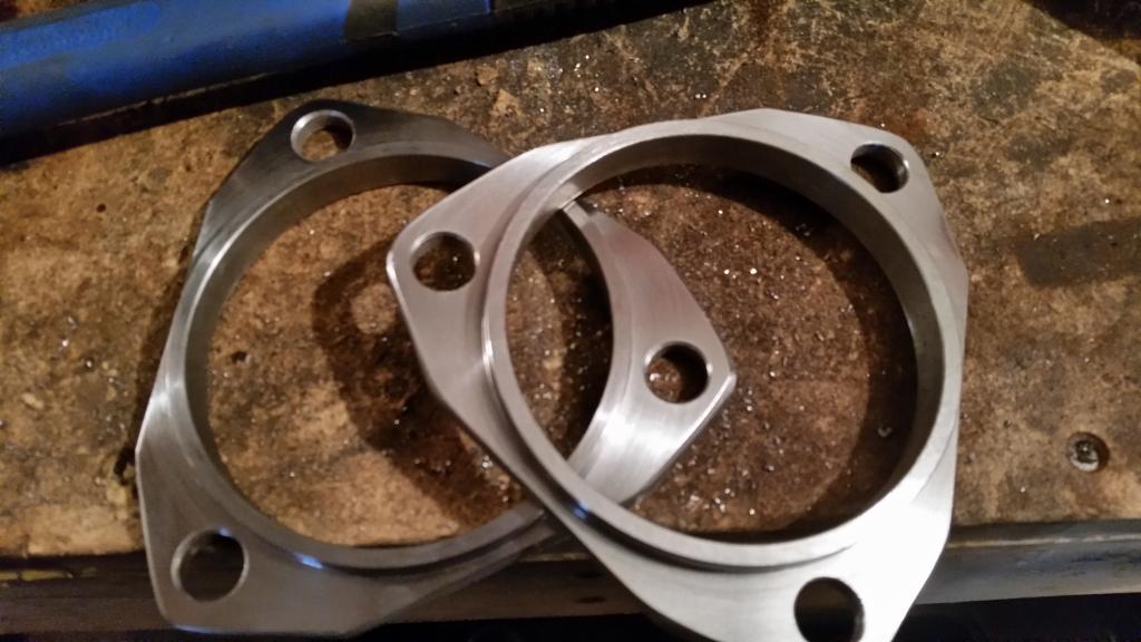

This is to adapt an s10 unit bearing to a dana 30 to keep the ABS happy.
dana 30 knuckle.
adapter
installed
Attached Thumbnails Blaz's 05 blazer-20140708_143645_zpslwuykaeb.jpg   Blaz's 05 blazer-20140708_143706_zpsui0zh1sn.jpg   Blaz's 05 blazer-20140708_143637_zpsjnmn0068.jpg

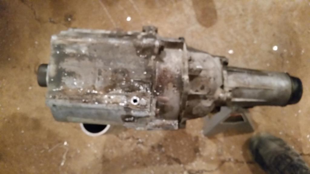

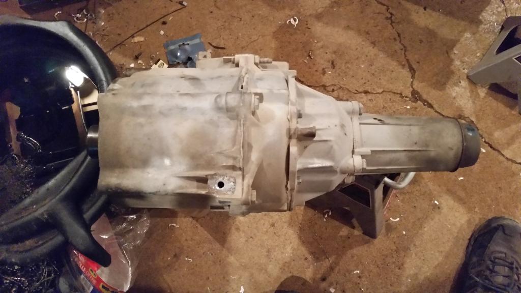

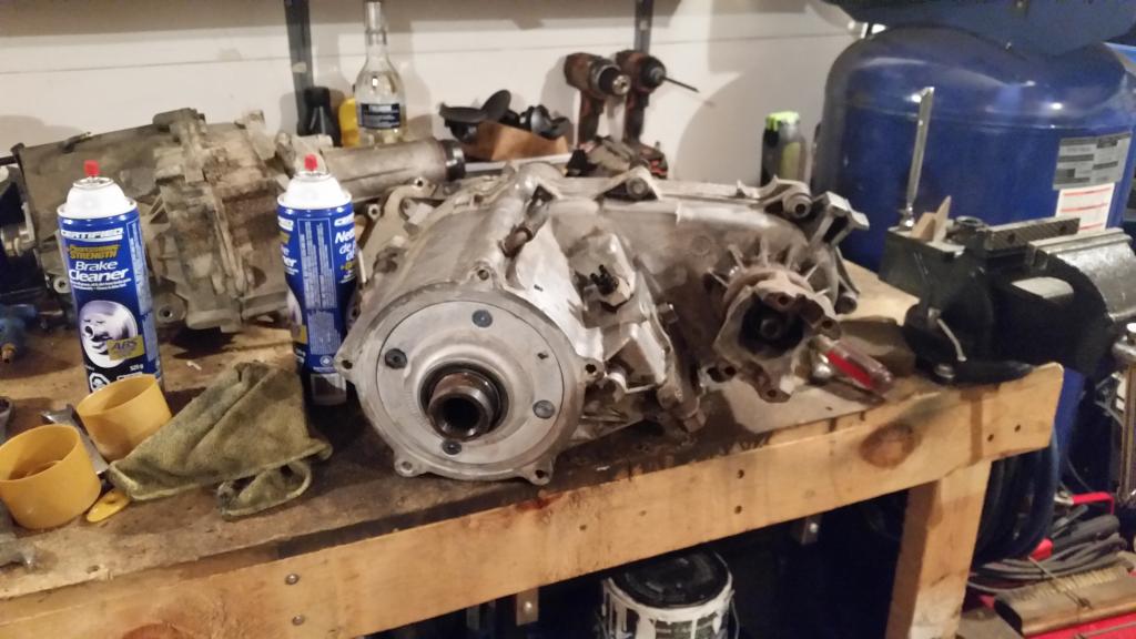

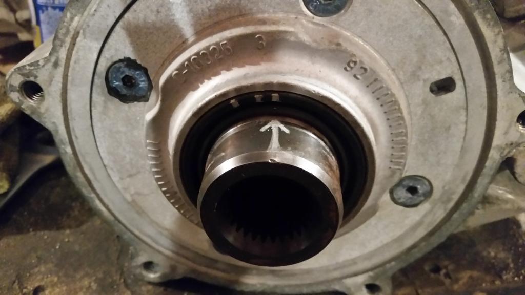

Cleaned the t case.
I had a question as to how much play should be between the input and front output shaft so I checked a t case with only 50 000 kms and compared it to this one.
This is what I found. The current point is the starting point with the front output fixed (unable to move). The second mark is where the arrow went to in 4 hi The third mark is where it went to in 4 lo.
Both T cases had the same amount of play so I will install the 233c with the fixed yoke. I also checked the oil condition and it looked used but good. No recent oil change to hide problems.

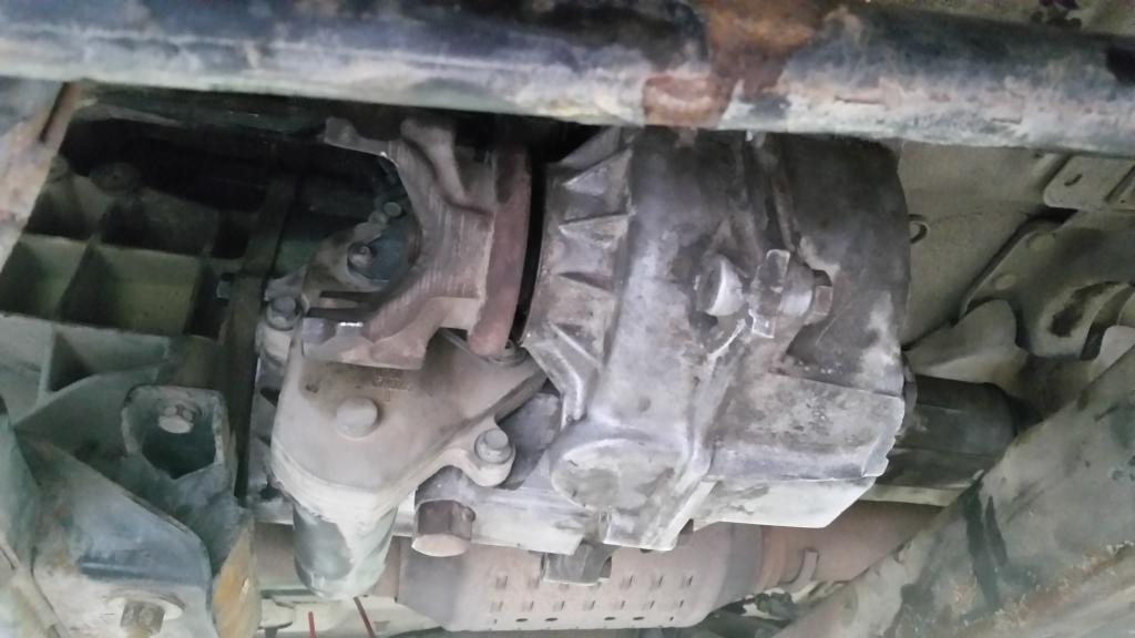

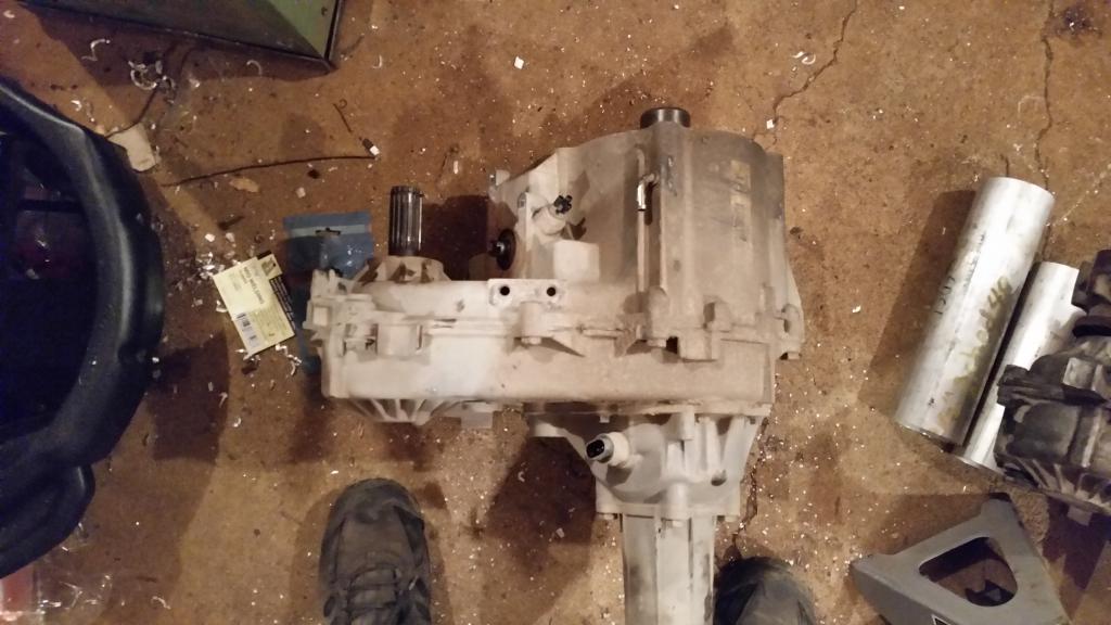

One of these things is not like the other.
It is now.
I had to do these holes too.
The holes were to mount the stiffeners that run from the engine back. The first gen t case had the bosses, just no holes.
First gen t case with the fixed yoke is now installed.
I also found a bad u joint on the rear drive shaft. I will deal with that later, but soon.

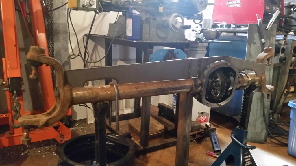

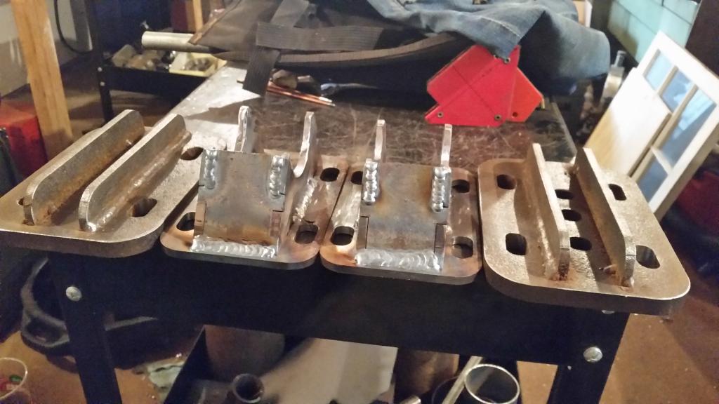

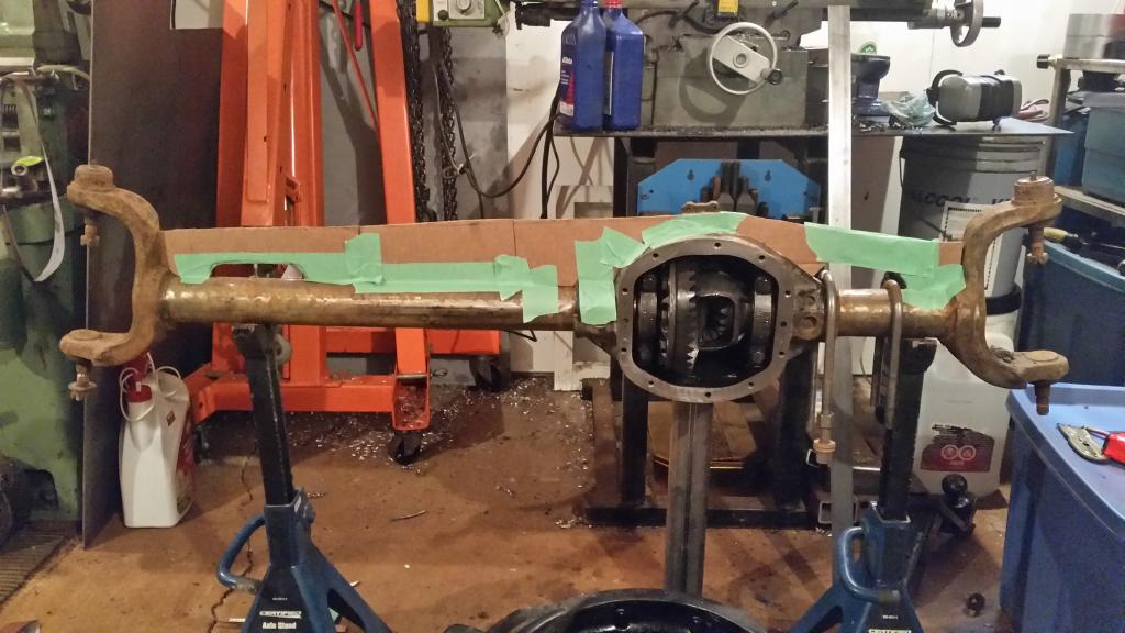

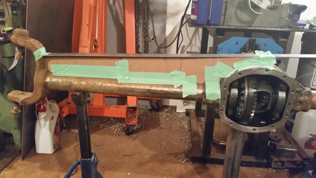

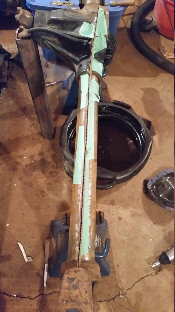

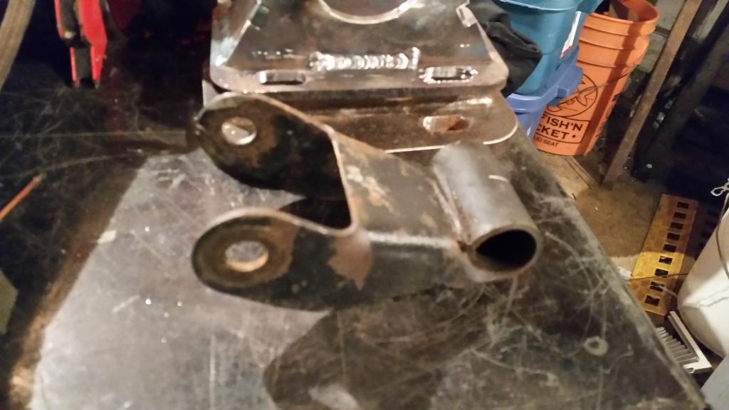

Started playing with spring hanger designs. Bolt up is the plan for now then weld when the springs have settled and I am happy with shackle angles.
I also started the template for the dana 30 truss.
More parts are supposed to be arriving this week end. I hope to get this done quickly when i get the parts.

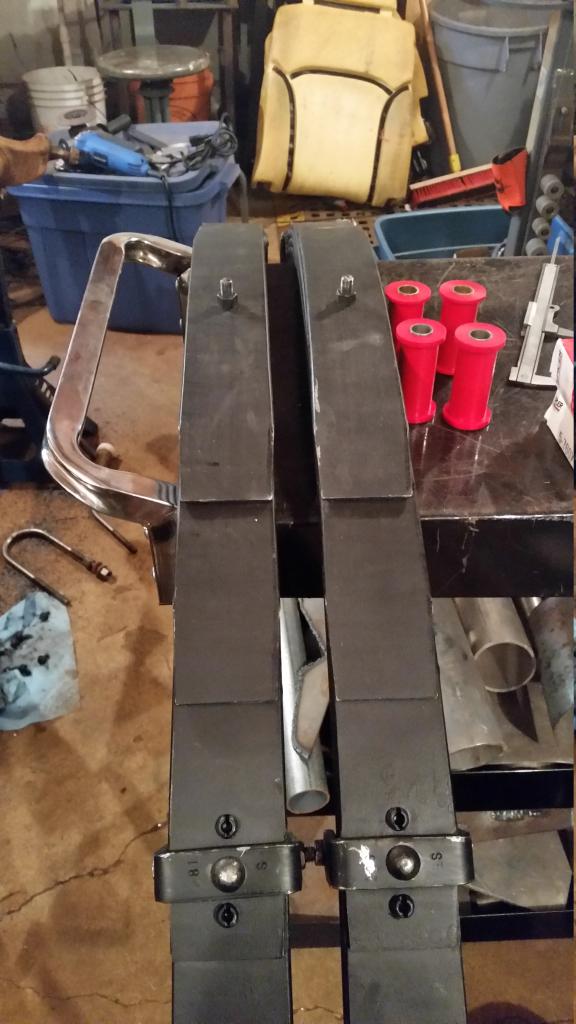

And the required parts.
Attached Thumbnails Blaz's 05 blazer-20140719_164158_zpsleguhkcz.jpg   Blaz's 05 blazer-20140719_164238_zpsk1uqzlhl.jpg   Blaz's 05 blazer-20140719_164305_zpsfrg0acwt.jpg

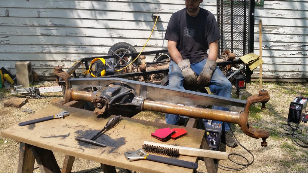

Had some great help today.
