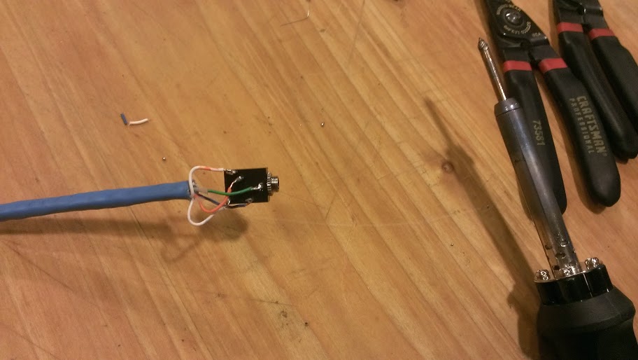

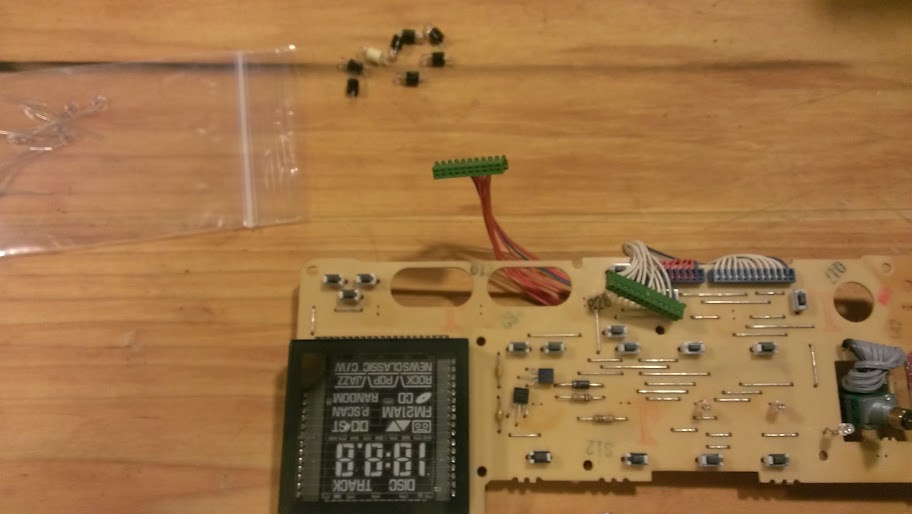

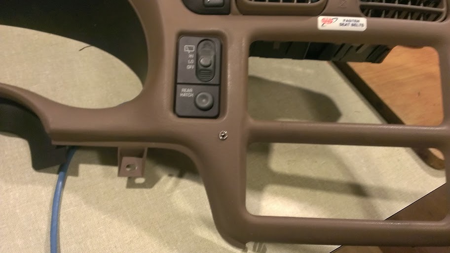

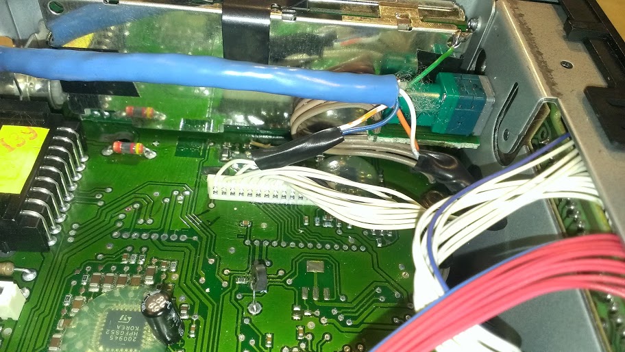

I received my replacement bulbs for the radio yesterday and was able to find the below linked write up online which matched my radio internals so I decided to rip the radio out again tonight and go to it.
http://ls1tech.com/forums/stereo-ele...t-adapter.html
All the old bulbs desoldered and waiting replacement:
Audio Jack soldered:

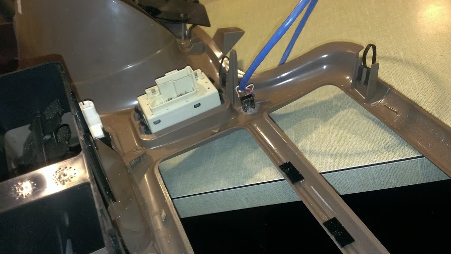

Wiring spliced into CD cable:
Audio Jack mounted to back of bezel:
Audio Jack test fit:

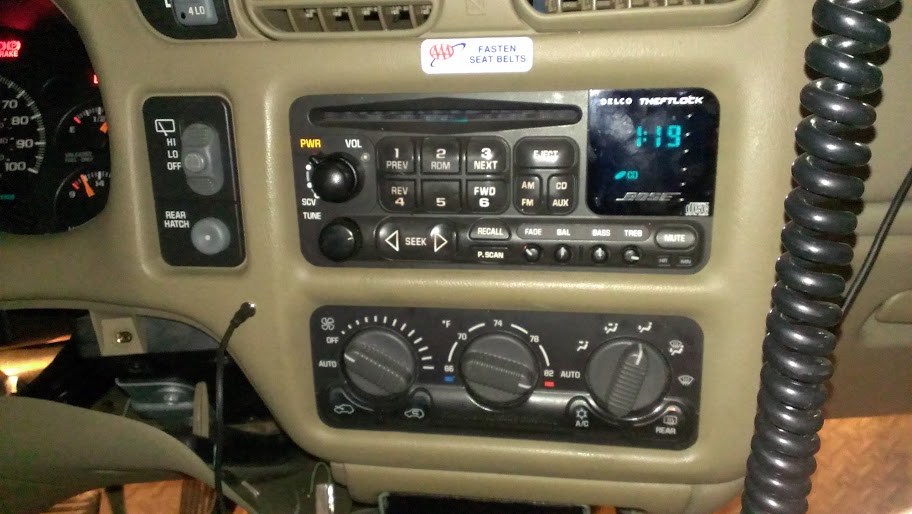

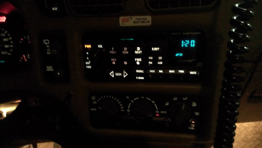

Reinstalled and working with audio jack:
All lights functional on radio, I should have thought about it but it didn't occur to me till I saw that the lamps I ordered online were brighter then the ones I got in radio shack, at least it works:

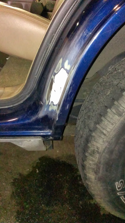

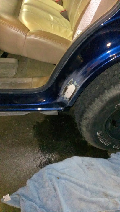

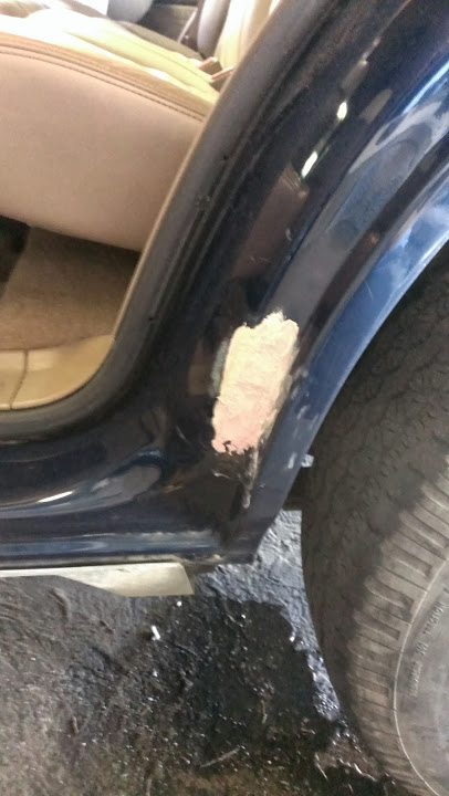

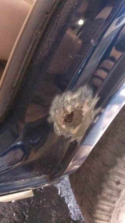

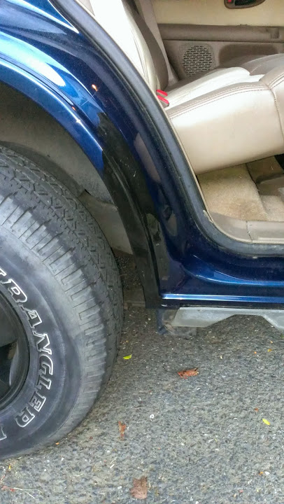

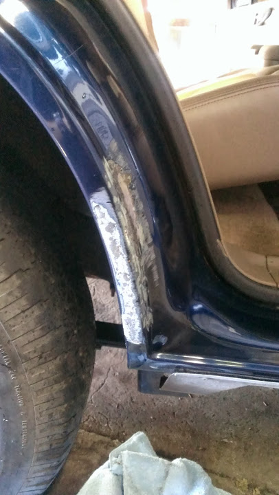

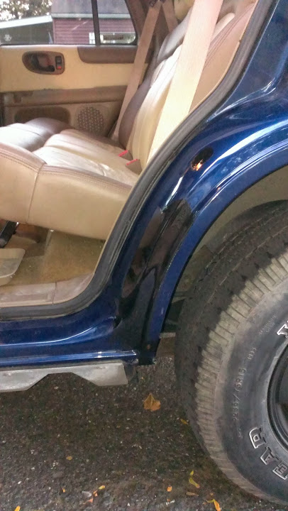

Took care of the rust in the rear on both sides this weekend. The drivers side ended up being a little more then surface rust so I had to reinforce that and bondo it, then prepped it and painted it with POR-15.
Both sides sanded down:
Drivers side bondoed and sanded:
Prepped and Painted with POR-15:

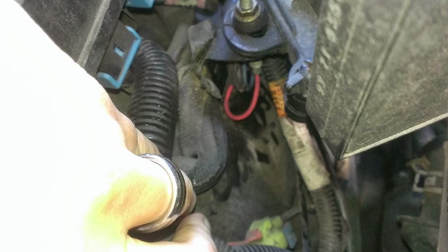

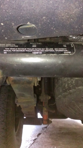

I installed by brake controller this weekend but discovered that the factory hitch replaced the rear bumper supports completely when I went to remove it, so now I have to send the hitch back and get a weight distribution system for the trailer. Well I don't have to, but I feel more comfortable not being so close to the limit of the hitch.
Hitch rating with and without weight distribution:

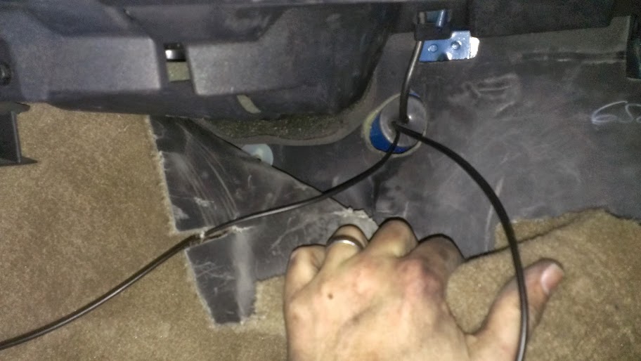

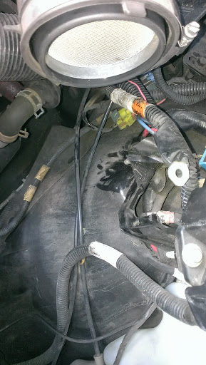

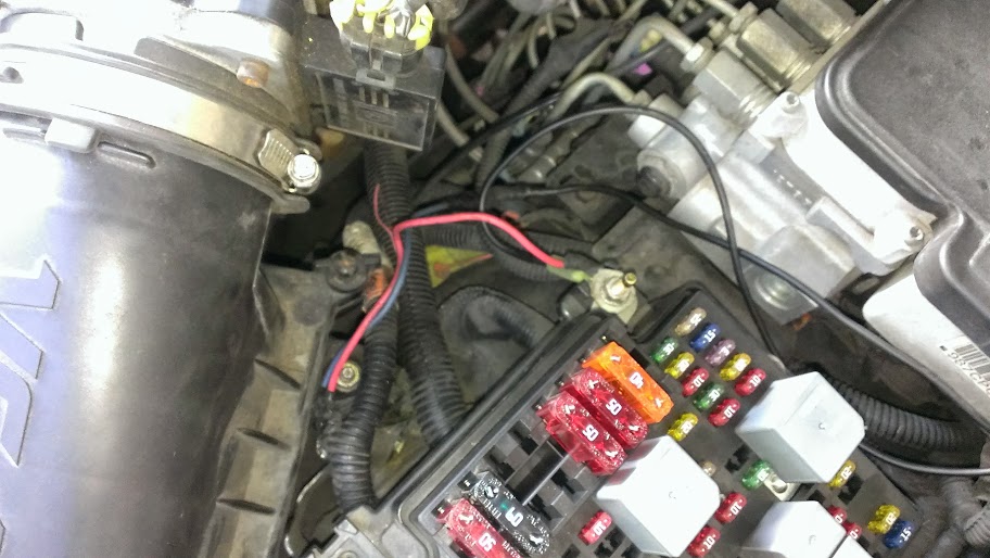

Aux power and brake controller line that Chevy pulls from the wiring harness in the rear into the front engine bay(found under the airbox):
Wires after removed the airbox:
Wires hooked up, airbox back, and wires run through firewall:

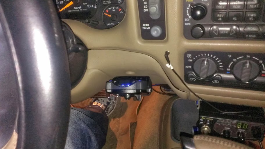

Power and brake coming through firewall into cabin on passenger side:
Brake controller installed and mounted:
