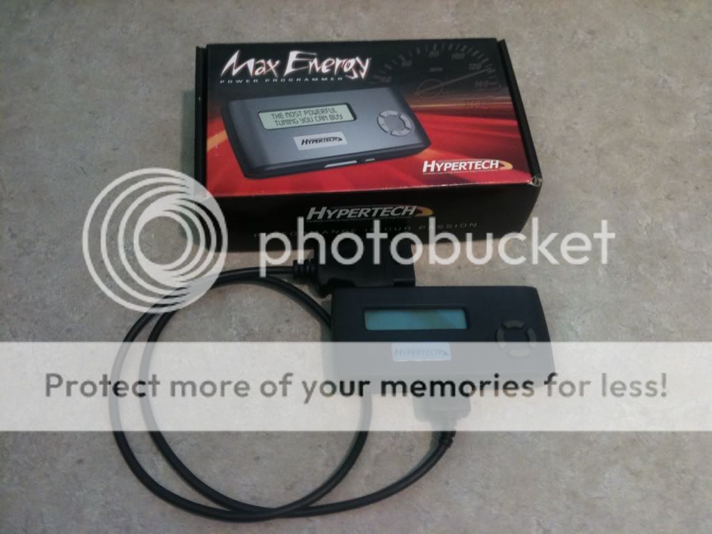

Well, here's another quick update. I still haven't gotten my 31" spare tire mounted. Hopefully this week. I did however find a pretty good deal over the weekend. I found someone selling a Hypertech Max Energy power programmer.
Being very poor, I offered him $100 for it, and luckily he accepted. Now my truck is programmed with the correct tire size and gears, and the shifts are a lot more firm. I can't say that I've noticed any real change in power, and I haven't had it long enough to determine if it will affect fuel economy. It did make the shift points much nicer, and firmer, and it doesn't feel like the engine has to race before it shifts. All in all, it was a good Canadian Thanksgiving weekend.
