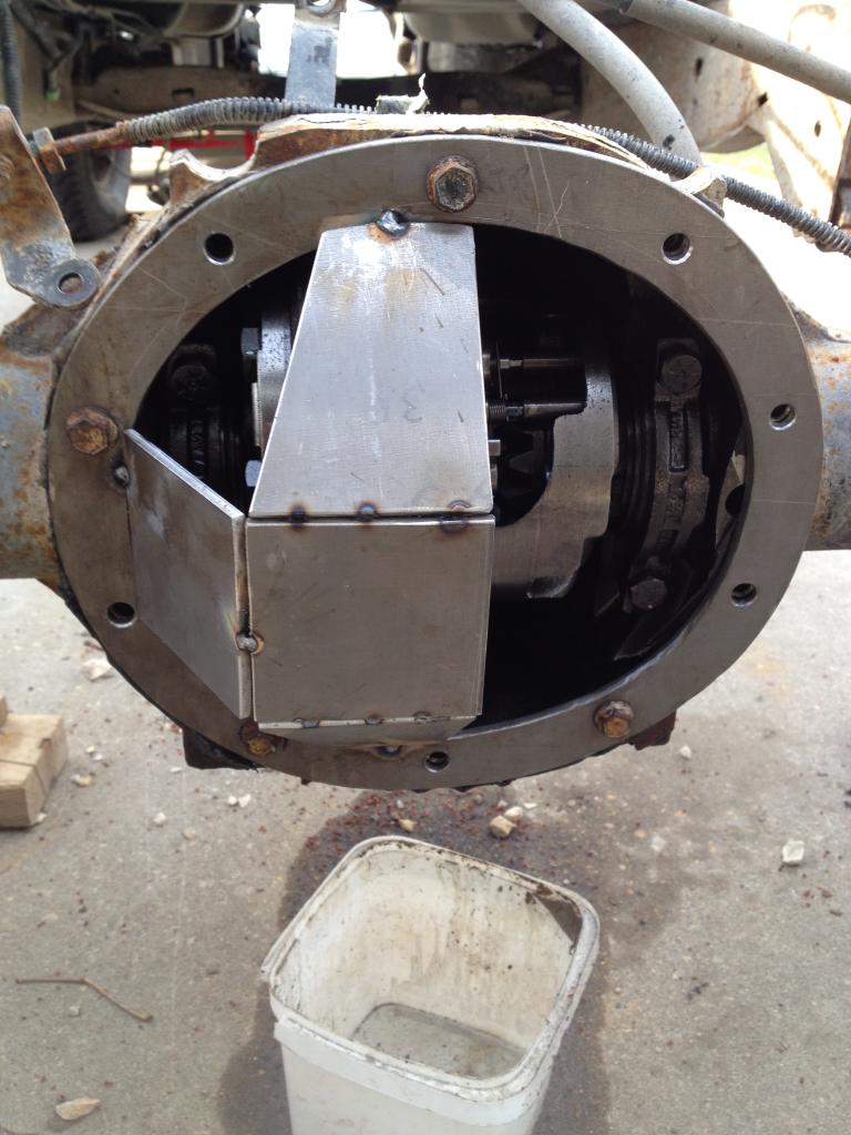

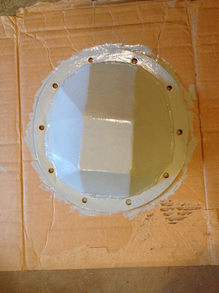

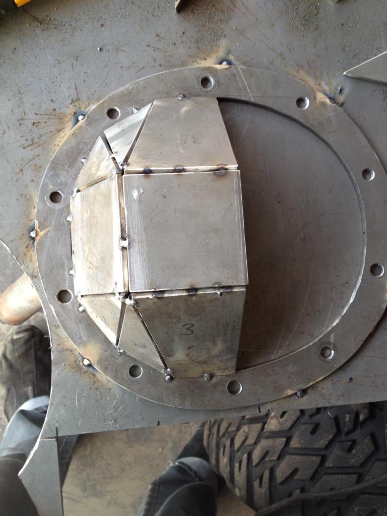

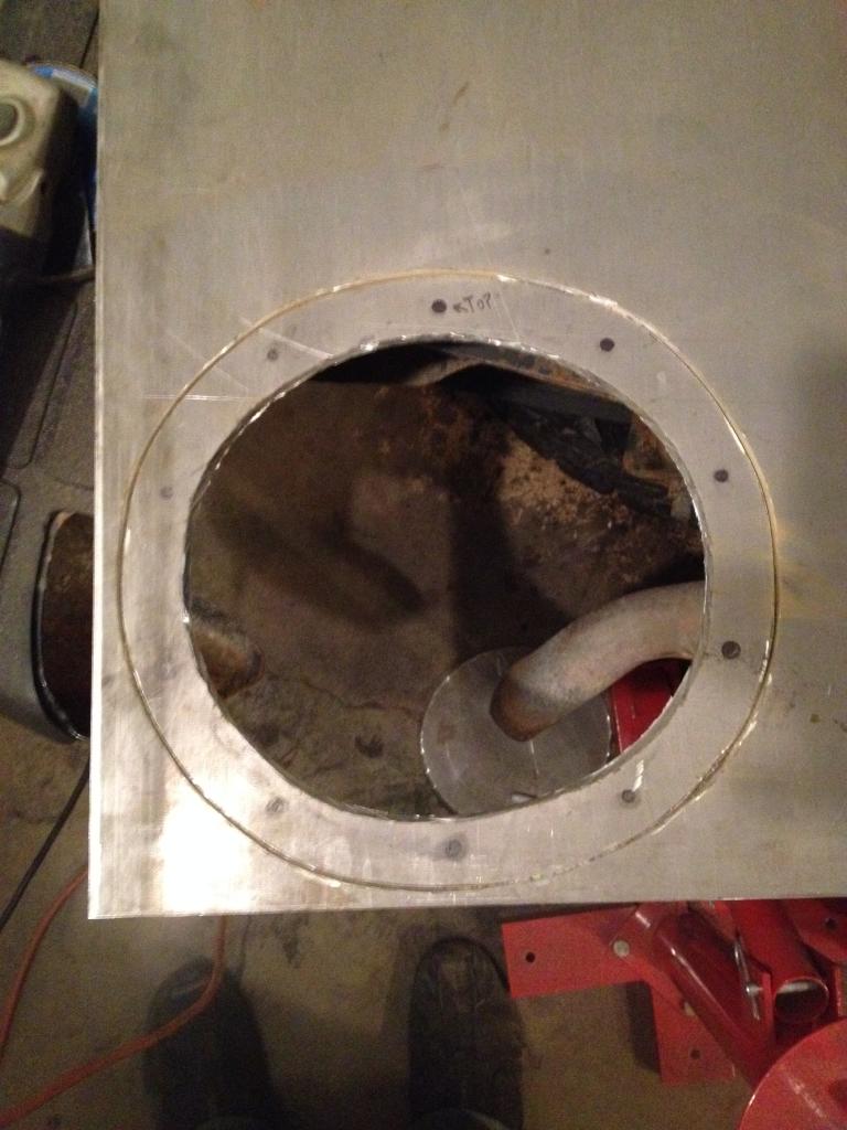

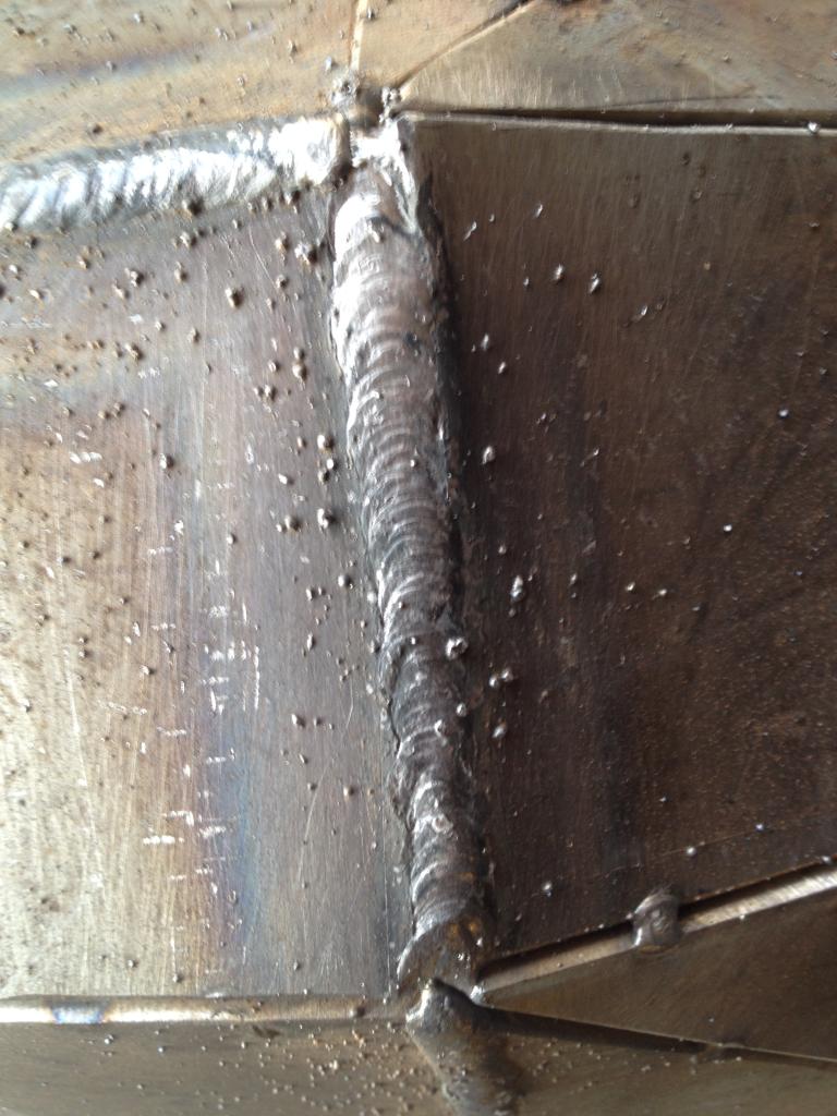

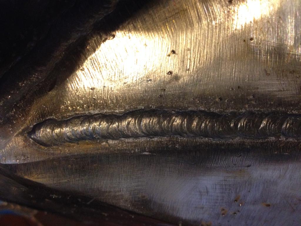

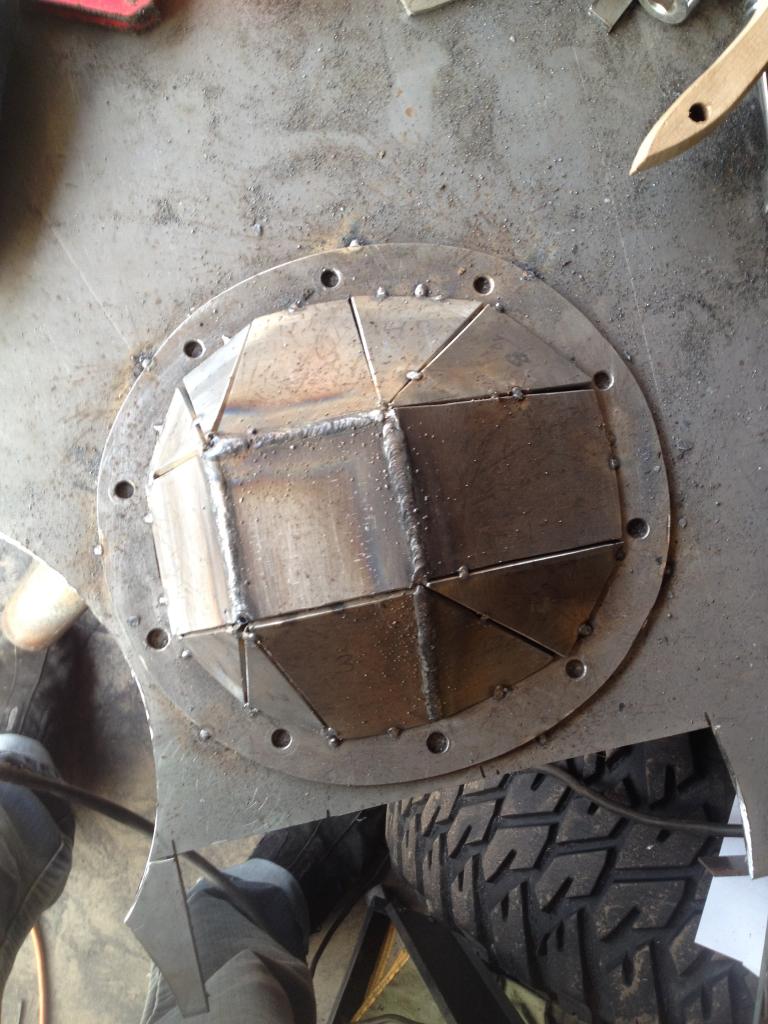

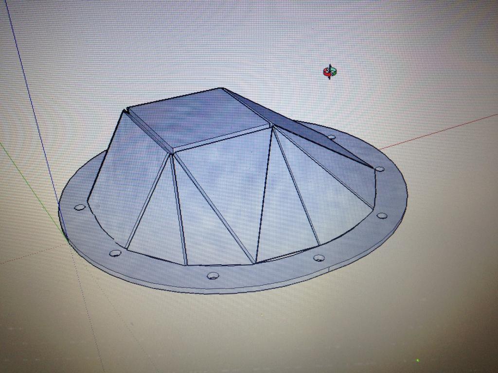

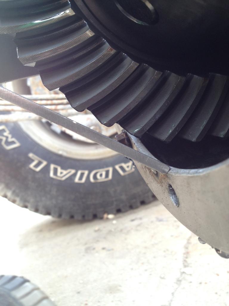

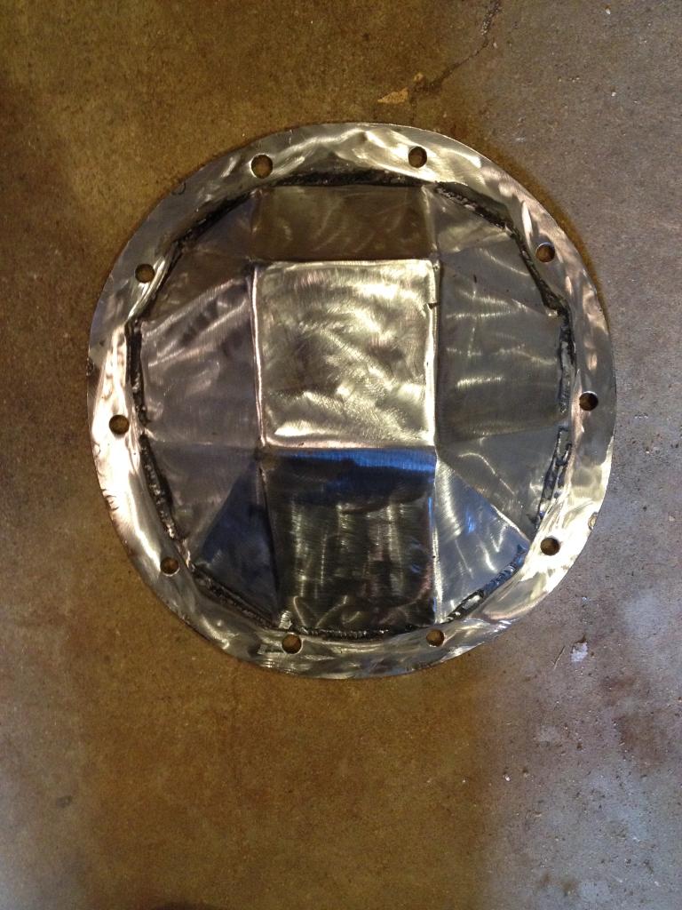

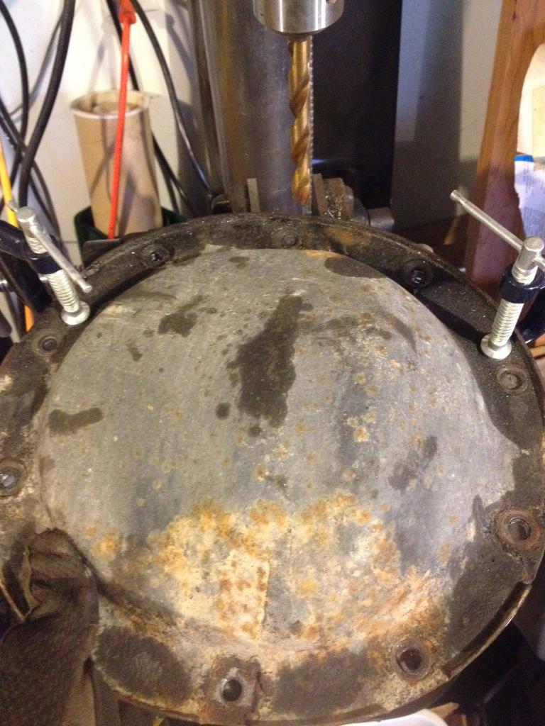

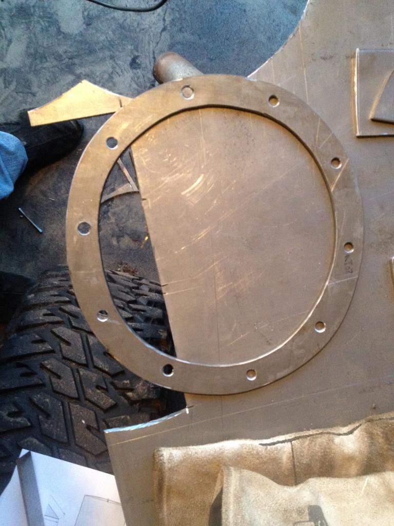

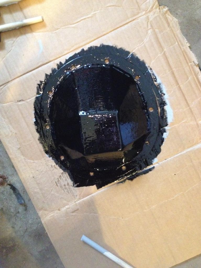

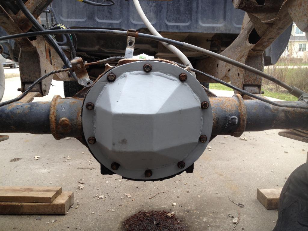

Wanted a break from working on the Sonoma for a bit so I've been working on a diff cover for the last little while.
Started with a model in Sketchup to get all my pieces figured out and dimensions for cutting

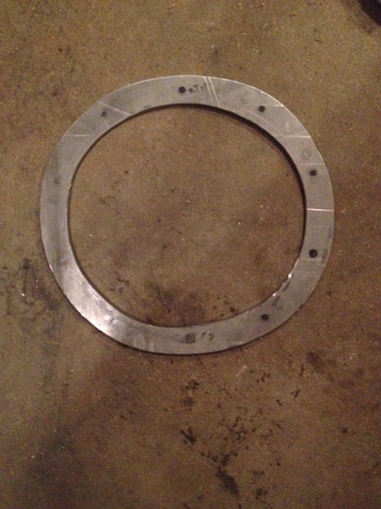

Then cut everything out
Drilled the holes

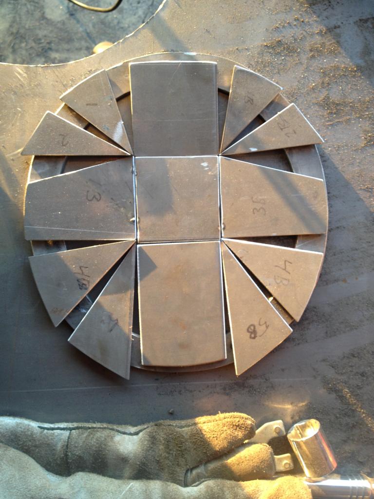

Making sure everything clears
Fitting the rest of the pieces together

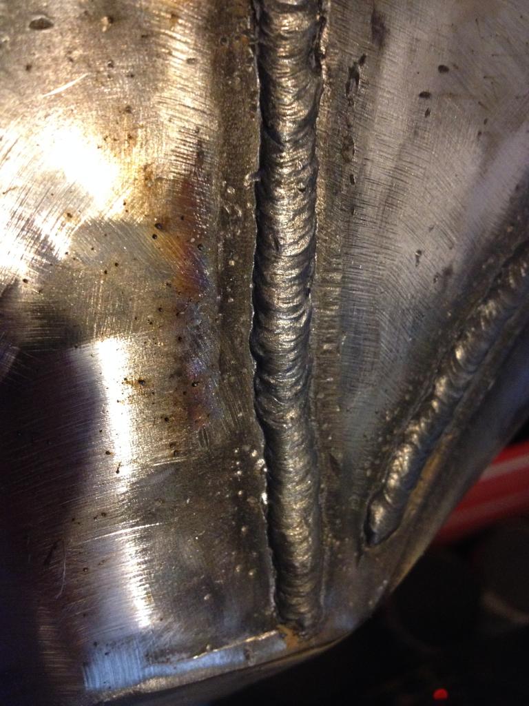

Starting to weld
And weld and weld and weld... Inside and out.
All smoothed out
And in primer
Attached Thumbnails Jamaroon's ZR2-5ade59c0-afdb-4c6c-8ef2-d0d1ad890534_zpsnn7clxku.jpg   Jamaroon's ZR2-e8000206-9588-4722-b1ea-13a69a5872e3_zpsw1bhu9hh.jpg   Jamaroon's ZR2-1daeef6e-c74b-4532-9aed-08e4552469a3_zpsfaibholg.jpg   Jamaroon's ZR2-48b8d86d-1c17-4f95-8216-f95cac8867ad_zpsz7igkouv.jpg   Jamaroon's ZR2-7b22f171-f468-4029-94f5-36b140f3fc0d_zpszlk0jhl5.jpg

Nice work! What did you use to cut everything out?

Thanks, 4 1/2" angle grinder

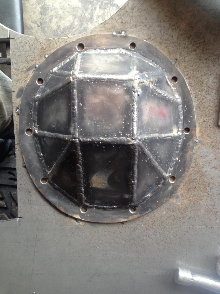

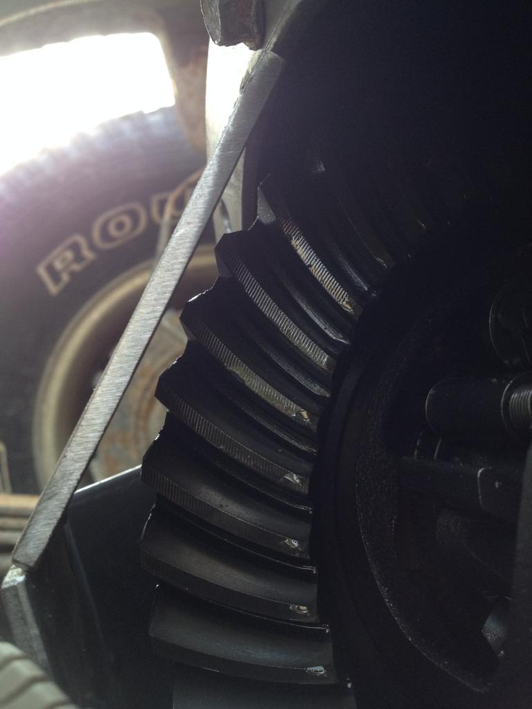

Final test fit, had to make a bit more room for the bolts
And coat of black paint
Attached Thumbnails Jamaroon's ZR2-5716e206-eafb-4f01-affb-7e68f3a9745b_zpspiwtl9p2.jpg   Jamaroon's ZR2-77d4e271-ac7a-4c0f-9eeb-44b97a823c6a_zpsi7dtyg7p.jpg
