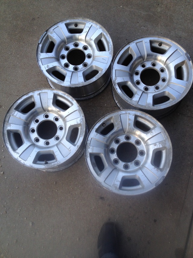

Same cars.... same bodies.... no frames.... different option packages. Those wheels didn't come on the iroc package. They came on the z28 and rs package. That's what my point was.

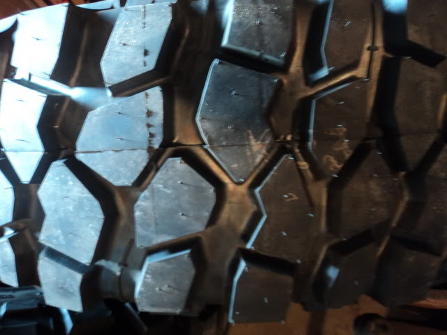

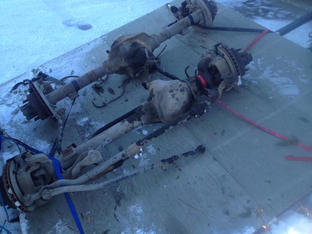

But for everyone to be up to speed, here's the plan for the SAS on the Blazer (rest of this post is copy and pasted)
There are a few of the details in there already but not laid out all nice and tidey.
So, the truck is a 1999 ZR2 Blazer, 4.3/4L60e/np236.
Plans are:
- D60/10.5 from a 2004 F-250 - Purchased
- D60
. - Grizzly Locker - Purchased
. - Warn Hubs - Purchased
. - 5.13 gears - Purchased
. - Need to buy install kit
. - Planning on shaving it
. - Hubs turned down and converted to 8x6.5
- 10.5
. - Welded for now, would love a selectable, might leave it welded or go with an auto locker. depends if I come across any good deals
. - Not shaving it but, maybe smooth it out a bit
- Wheels and tires
- 5 - 39x13.5R17 BFG Krawlers - Purchased
- 6 - Factory Silverado 2500 Wheels, Painted - Purchased
I'm hoping the wheels will work out, if they don't then I'll have to go with a soft 8 type wheel.

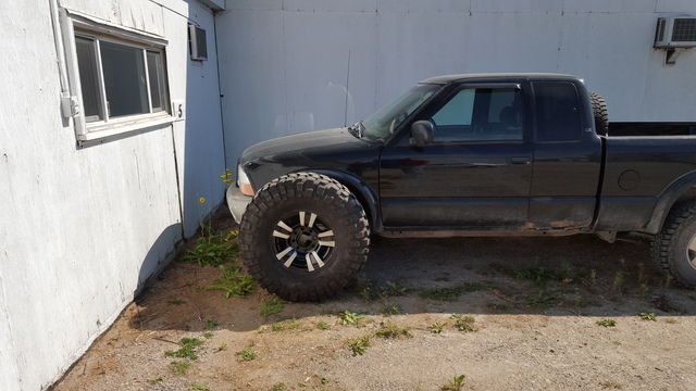

Yup, there will be a lot of cutting. And yeah I know about his blazer. It's awesome lol.
Took a pic of the tire against blaz's blazer last time he was over.
So it'll be tight but looks doable.
