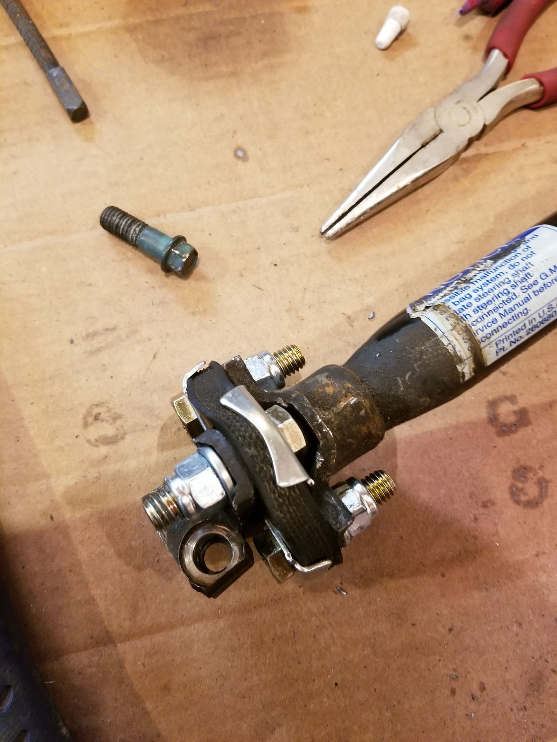

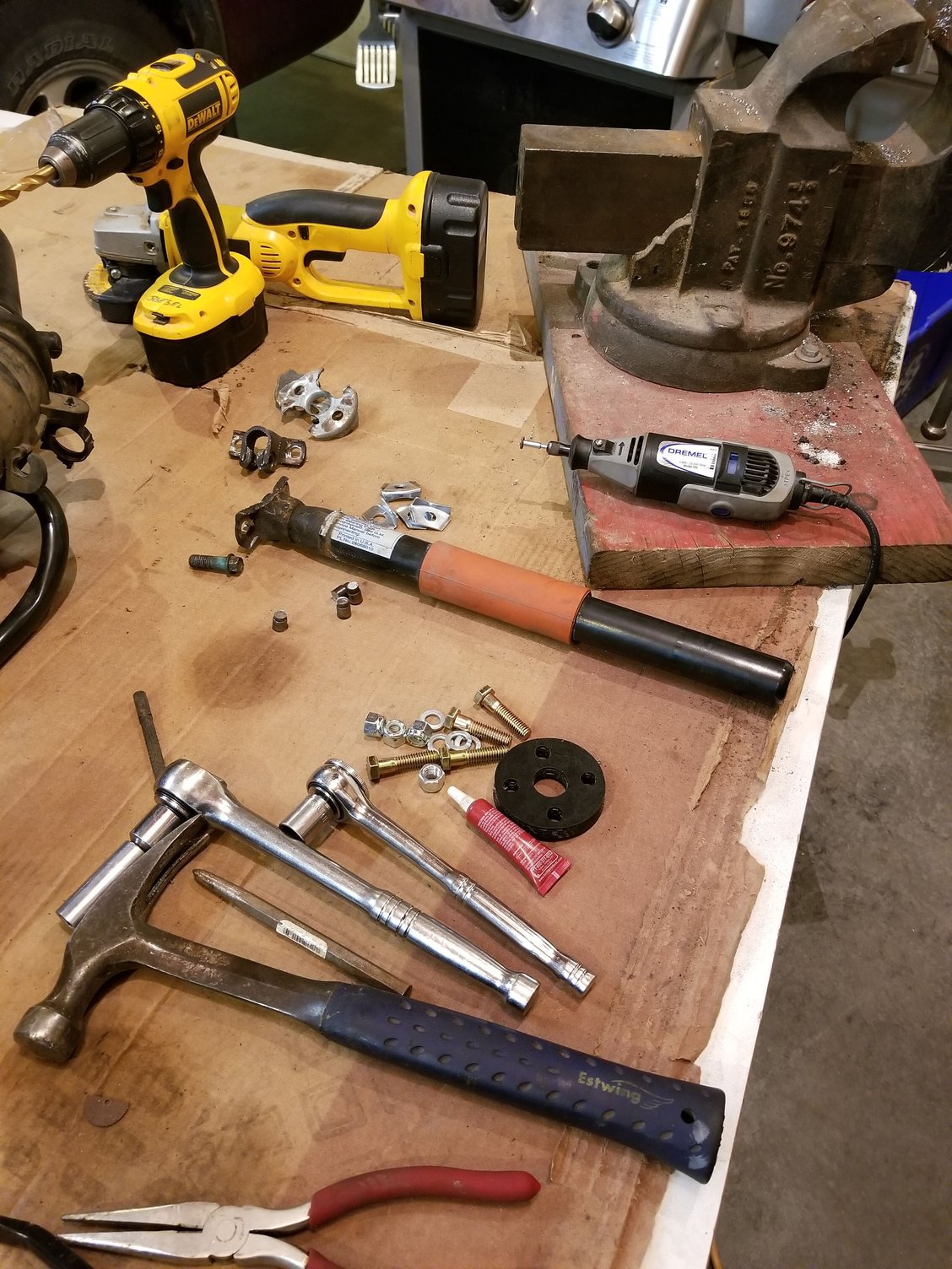

5. Loose steering/wandering +/- 5deg PARTIALLY RESOLVED
-Thinking rag joint at this time but haven't looked into it yet, other that visually looking at pitman arm, idler arm, tie rod ends, and center link ball joints which are kind of ugly but didn't seem to have play in them.
edit 1-18-18 Definitely found plenty of play in the rag joint. Bought a new rag and Grade 8 hardware to replace it, steering has improved but still has some movement.

Removed the cover for the rag joint, and it obviously had some pretty good play in it. Just going to replace the rag joint, looks like fun to grind off the rivets. I have a short vid, but don't know it it will load, we'll see----nope, I guess not, I'll have to try to convert it to AVI.
Attached Thumbnails Just another 2000 Blazer LT repair build-26840971_1515304278589065_4624317563508167235_o.jpg   Just another 2000 Blazer LT repair build-26805069_1515304148589078_4033321637191089676_n.jpg   Just another 2000 Blazer LT repair build-26731685_1515304038589089_2283573556825402627_n.jpg

Rag Joint replacement is complete. It was a bear grinding off the rivets to replace with bolts. Ended up using my dremel with small grinding disc. It took some time. Hammering them out wasn't very easy, even after grinding them off. Has to drill out the holes a little bit for my 3/8" bolts. Wanted to put it back together with the bolts facing the same direction, but the nuts were in the way, so did them 50/50. So much less play than the old one.
