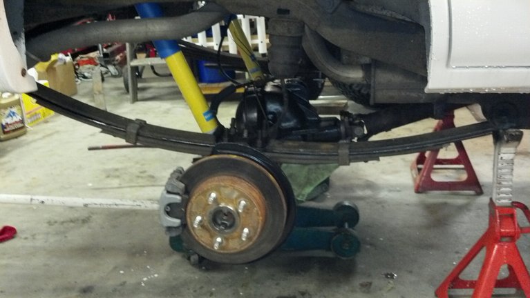

Well i changed the rear springs around... again lol.
The 63" chevy 1 ton leafs used in my rear pack ride rough as hell. Also they don't have as much arch as the s10 springs, so when flexed they would fan out giving practically no support to the main leaf... this is real bad and could have bent my mains pretty easily off road.
I still wanted a setup that would keep axle wrap under control, so this it what i came up with.
z85 (stock) main leaf, superlift long AAL, Zr2 2nd, Zr2 overload.
Ride is smoother... and actually wraps up less then with the 1 tons. I think that has a lot to do with the spring clamps in the front and the rear of the overload.

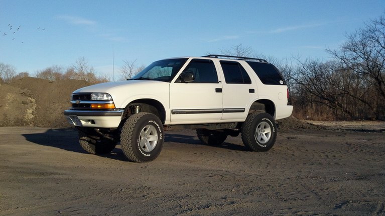

Haven't done much else to the truck, but ill ***** some recent pics...
