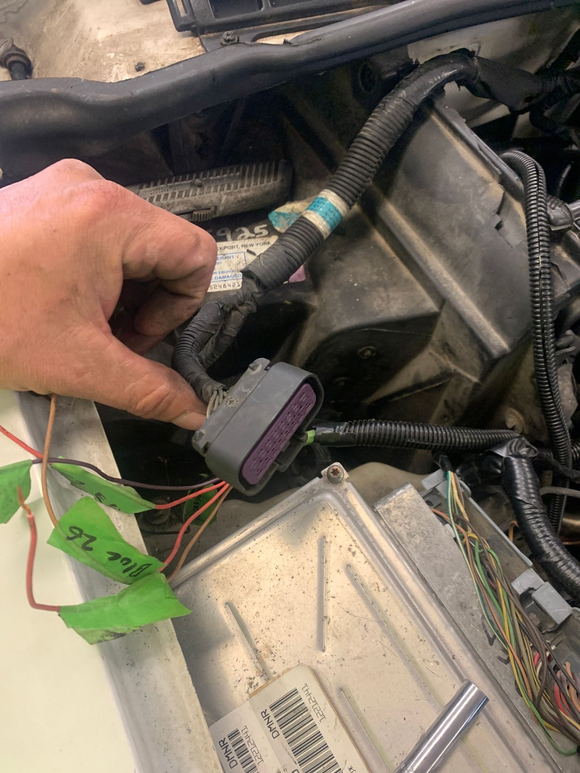

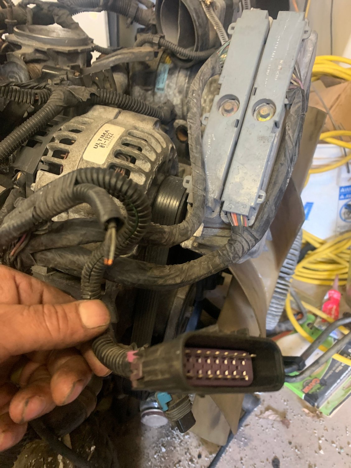

Drive shaft is connected to transmission. I’ll show what I’m doing for the steering shaft tomorrow. Basically cutting shaft and milling down an insert to get the smaller diameter to clear header. Now back to the gosh dang wiring. And I still don’t have a book to pin out what is what. I’ll post a pic. I’m guessing I need to find out what this controlled

Any help on what this controlled or a pin out it’s pretty much all I have not hooked up yet

Are you using a 'SpearTech' installation harness? they design harnesses to install V8 engines into other than the original car or truck.

No I made harness myself. So here’s where I’m at. Runs and drives perfect in reverse. Forward not so much. If someone can tell me how to show a video I have one

Looking at some pin outs it seems like some of the vital engine stuff runs through that C100 plug and may be the reason for fuel pump priming issues. Oil pressure sending unit, ignition voltage, ECM data, etc.
This may help you with the wiring harness pin outs.
pages for the 2002 harness
https://lt1swap.com/vortec_truck_pinouts/2002.htm
Page that has other years selectable on it.
Vortec 4.8/5.3/6.0 Wiring Harness Info
