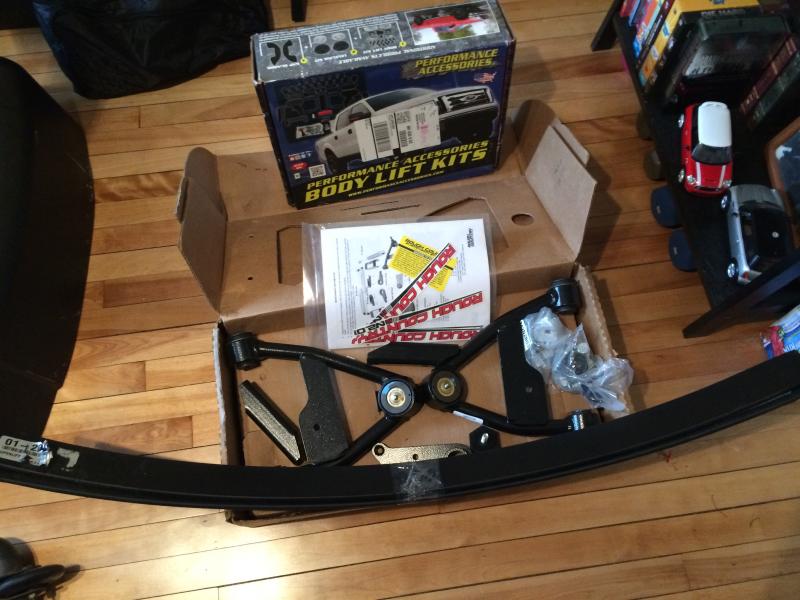

oh boy! I'm almost ready to go!!! Just waiting for the warm weather to hit. argh... sooooo far away... I got my body lift, RC 2.5" kit, superlift add a leaf springs. I figured i'd replace the lower balljoints when i do the lift so ordered some new Mevotech ones and scored a pair of torsion bars from a 1999 zr2 blazer. they look almost new and come with a set of keys (i won't be using). my front end seems a bit soft and my driver side torsion bar looks pretty scaled up with rust compared to the passenger side.

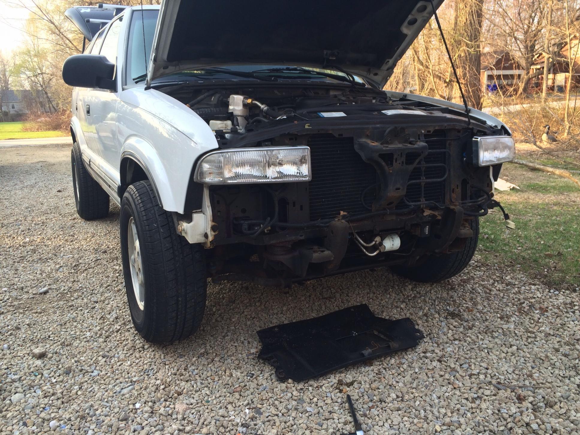

Got a little done after work today. If the weather is okay I will spend a little time on it again tomorrow.
