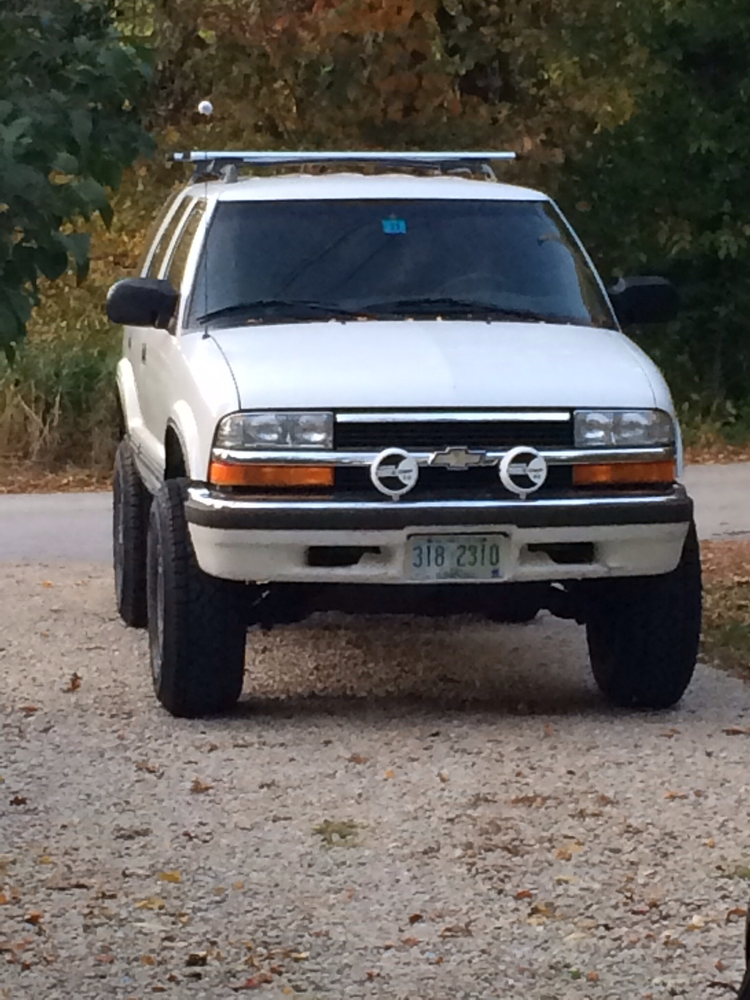

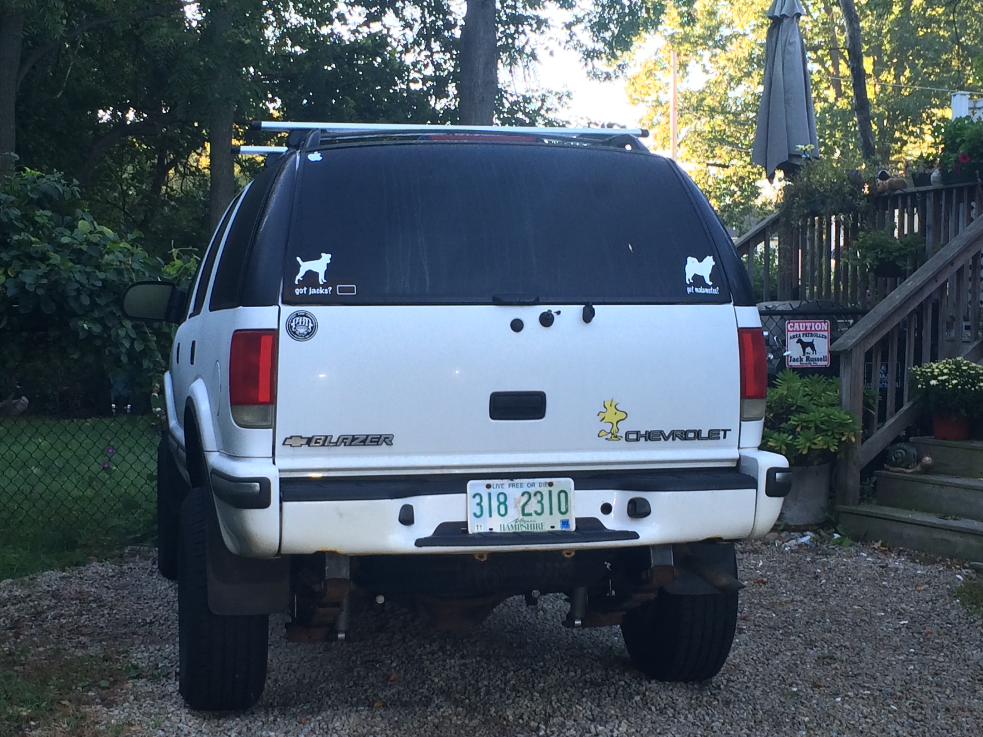

Finished up the lift yesterday. I got the add a leafs in along with the rear sway bar brackets and new shocks. I just need to get the new tires mounted up along with an alignment and i'm all done! i'm pretty happy with the way it sits. it's sitting on the stock 235 tires now. The pictures really don't seem to do any justice. i'm right arount 22.5" from axle center to fender well edge. The add a leafs gave it a nice stance on the rear end. I had a visitor stop by too as i was buttoning everything up.

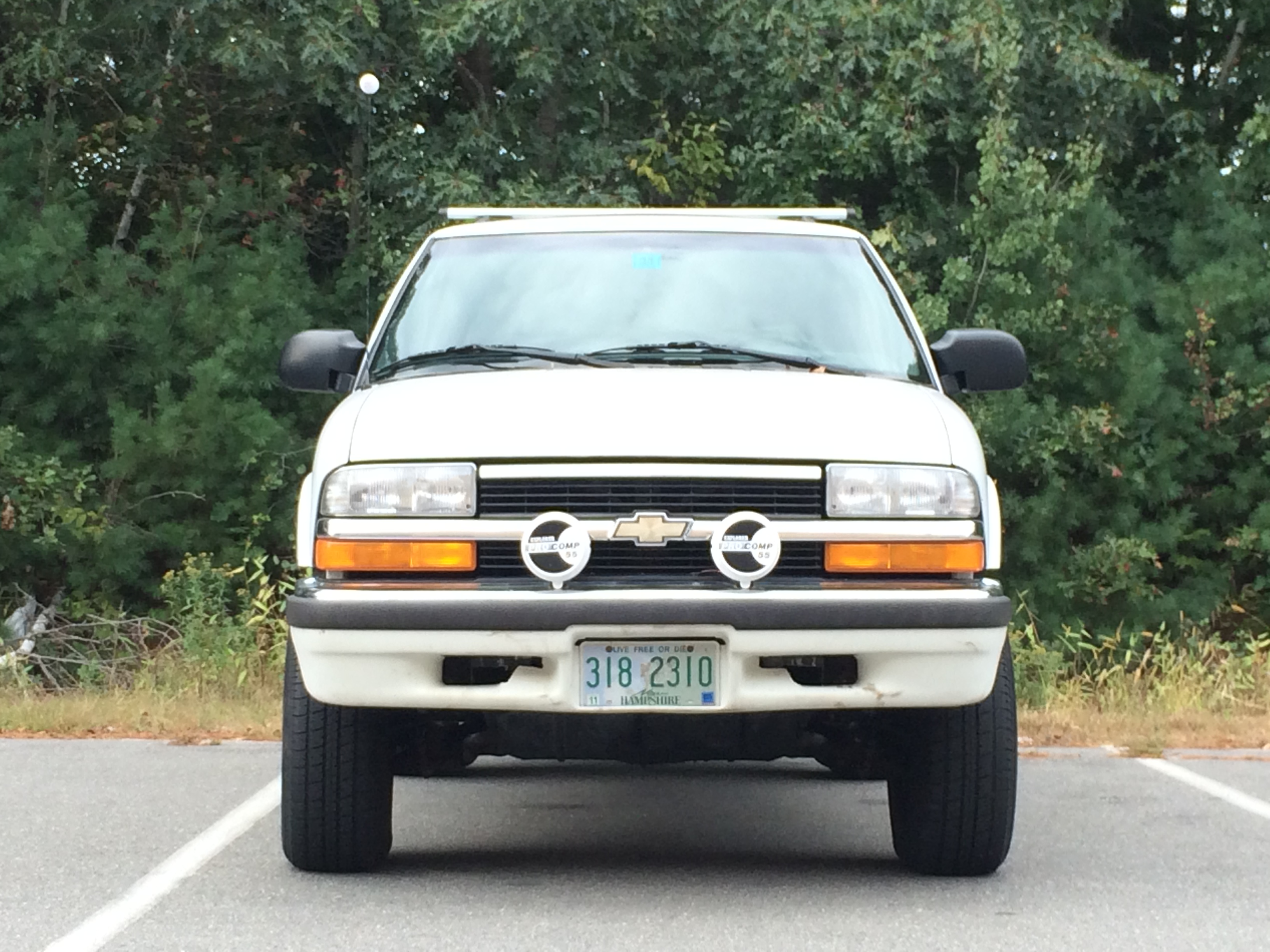

Blaze is getting it's front end straight today and the new shoes are going on as well!!! i'll post some pictures when i get it back this afternoon!!!!!
Old Oct 14, 2015 | 06:53 PM
  #39
madmaxxed's Avatar
Posts: 101
From: New Hampshire
madmaxxed is on a distinguished road
Blazer looks great! Better than I expected. I will have to trim or roll the back of the front fenders a bit as they rub when turning.
