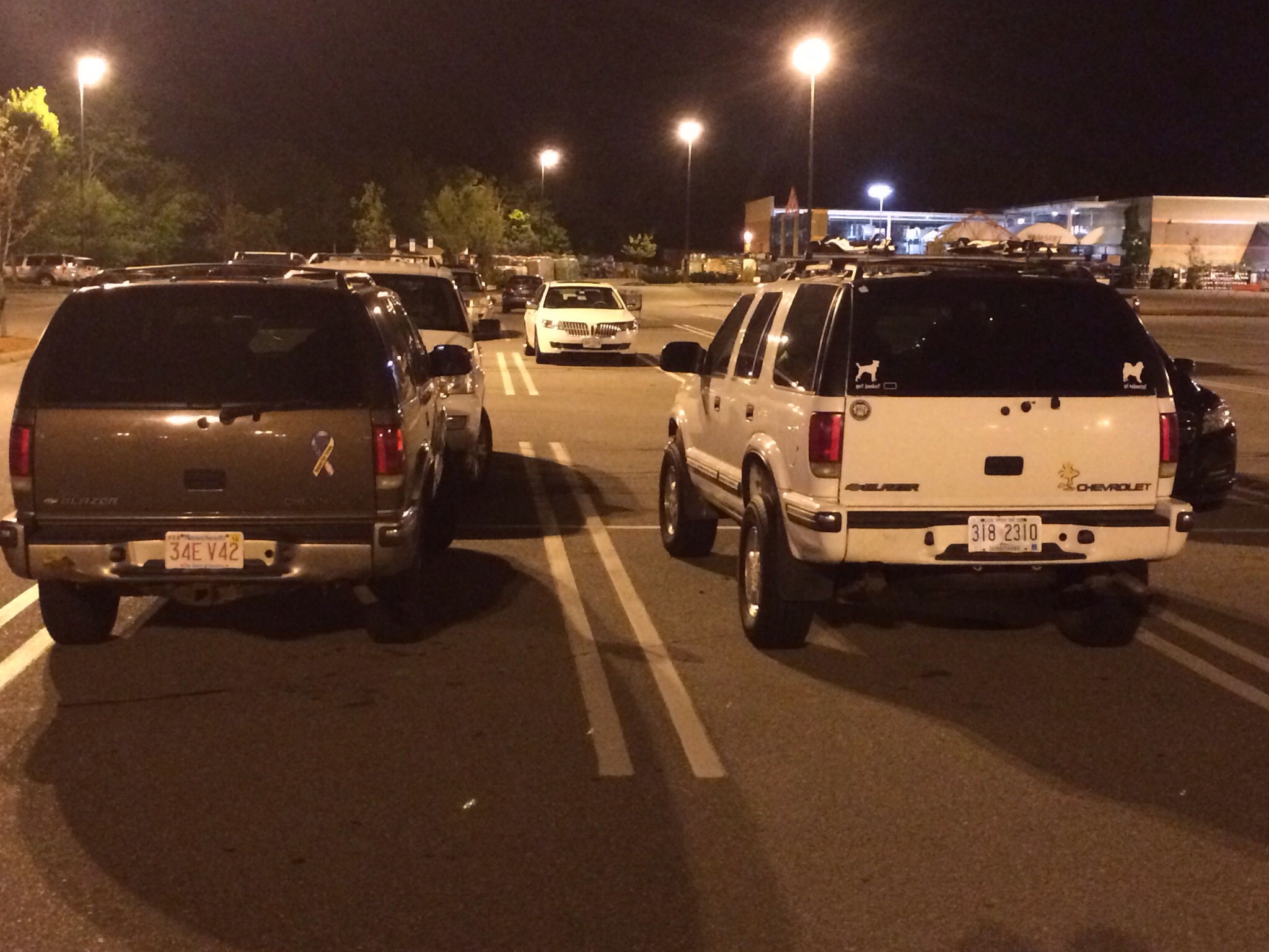

Not a great picture but does show some height difference. I was going to start on the suspension lift but unfortunately I was involved in a hit and run last week. We were forced right off the highway in my MINI Cooper by a guy towing a few atvs, he smacked his trailer into the side of my car. Car is going in for body repair so I will be using the blaze.

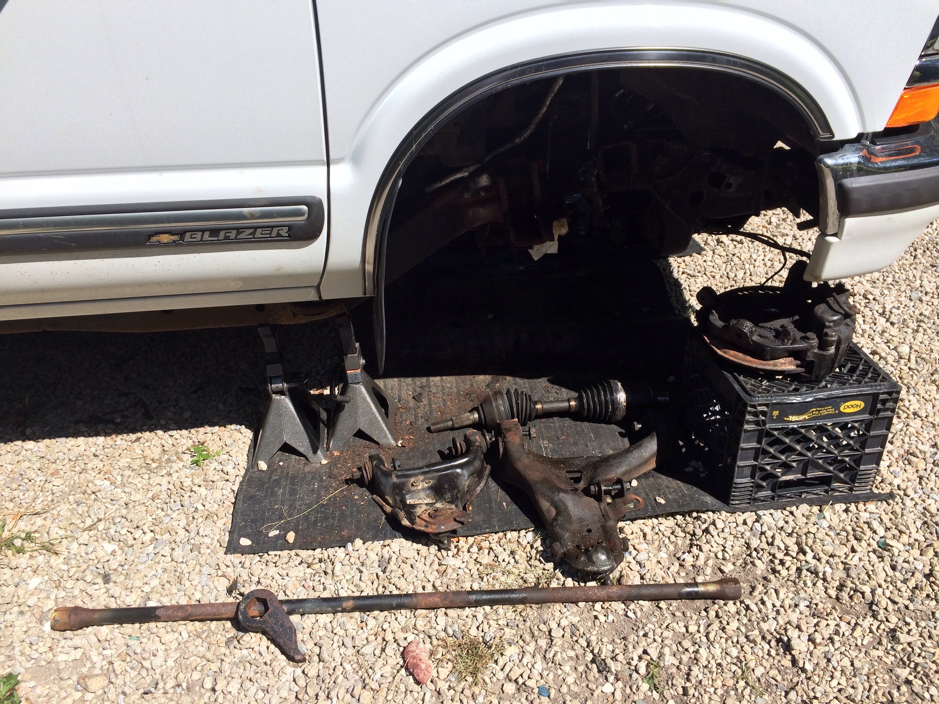

I finally decided to start working on the suspension lift yesterday. I got the upper control arms disconnected, shocks out, torsion bars unloaded. I see this taking a week or more as it's not a daily driver and I'm in no rush to get it done.

Driver side.

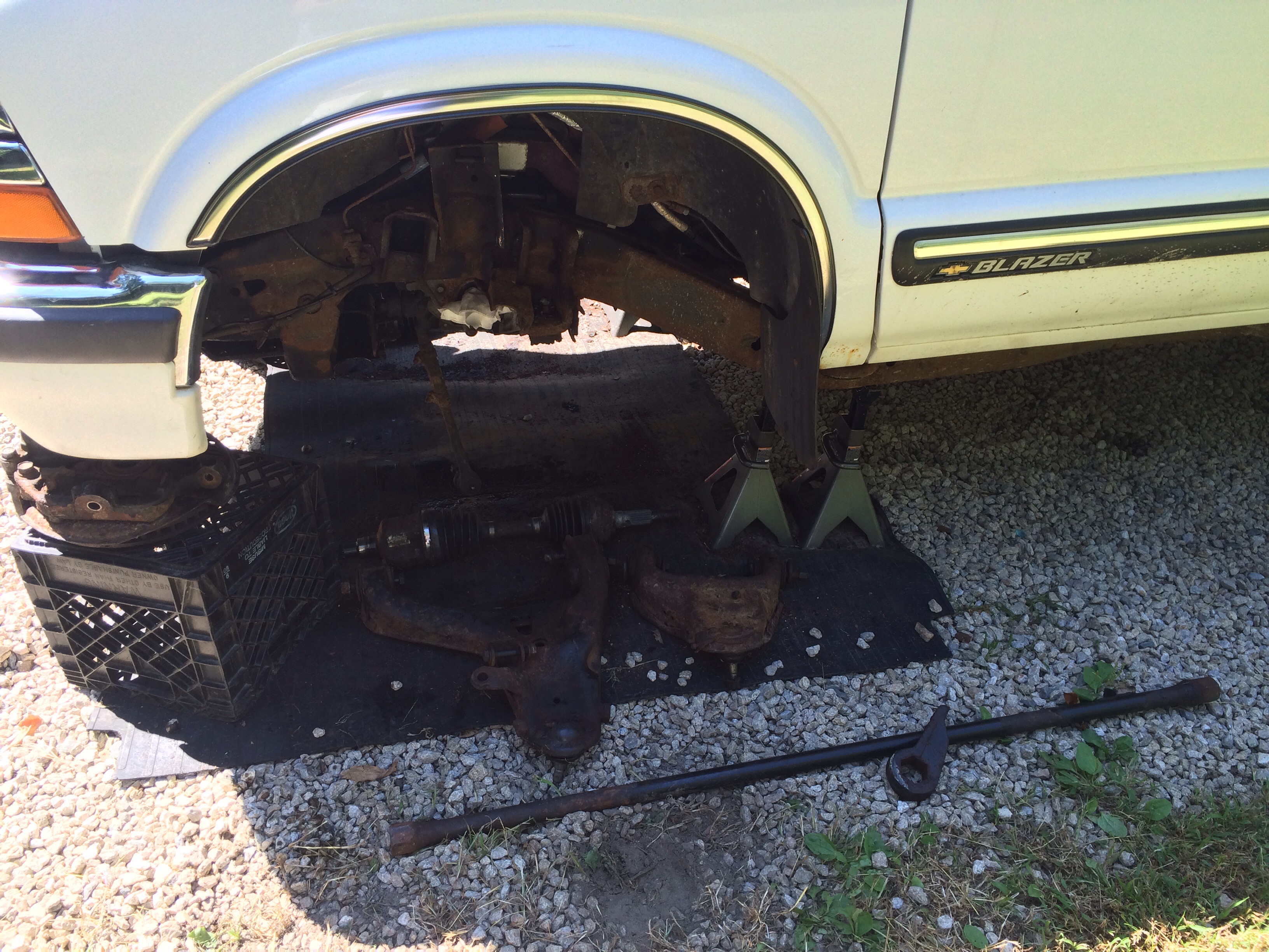

I made a little more progress on the front end. I got the axle shafts out, upper and lower control arms out, torsion keys and bars out. I am ready to drop the diff out! I removed the lower control arms to get the the torsion bars out as they were completely seized in the keys and arms. I am going to replace the lower ball joints, torsion bars with a set from a ZR2. I already have 2" shackles in the rear so I'm going with an add a leaf for the springs.

Passenger side.
