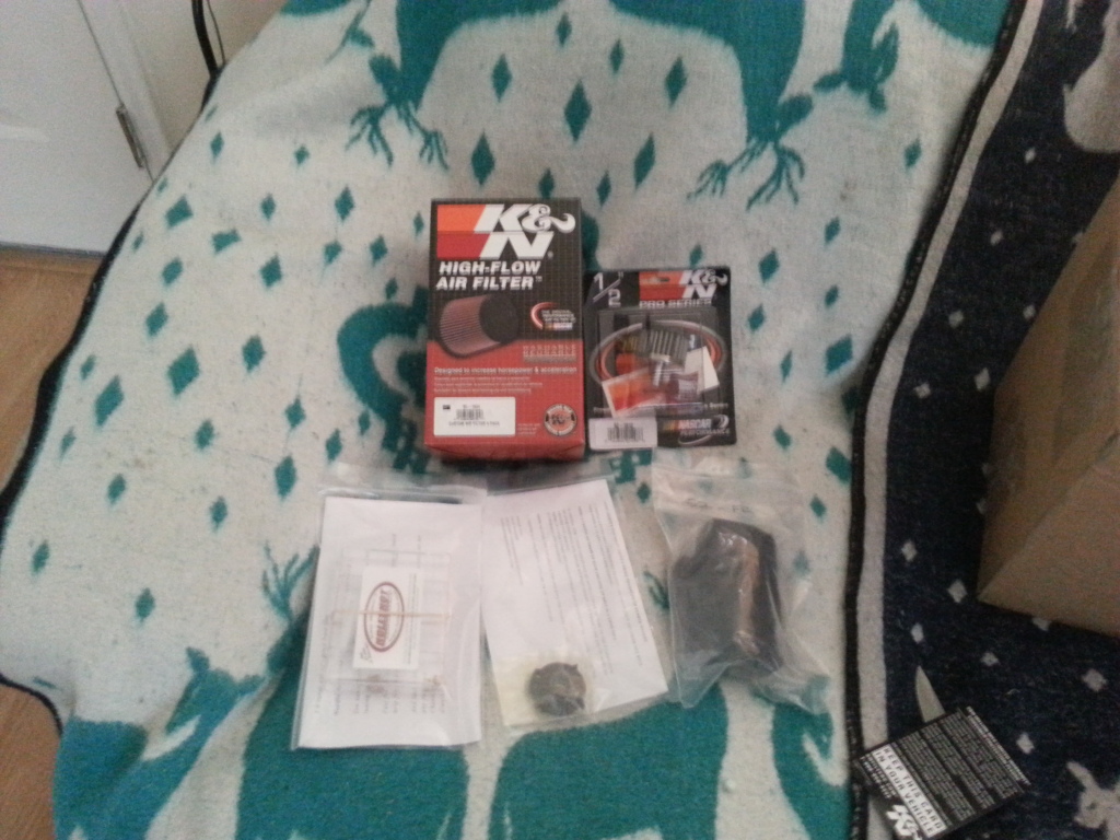

Well I ordered the jet kit today with the K&N pod filters and a water repellent filter cover for when I get caught in the rain.
Should look something like this.

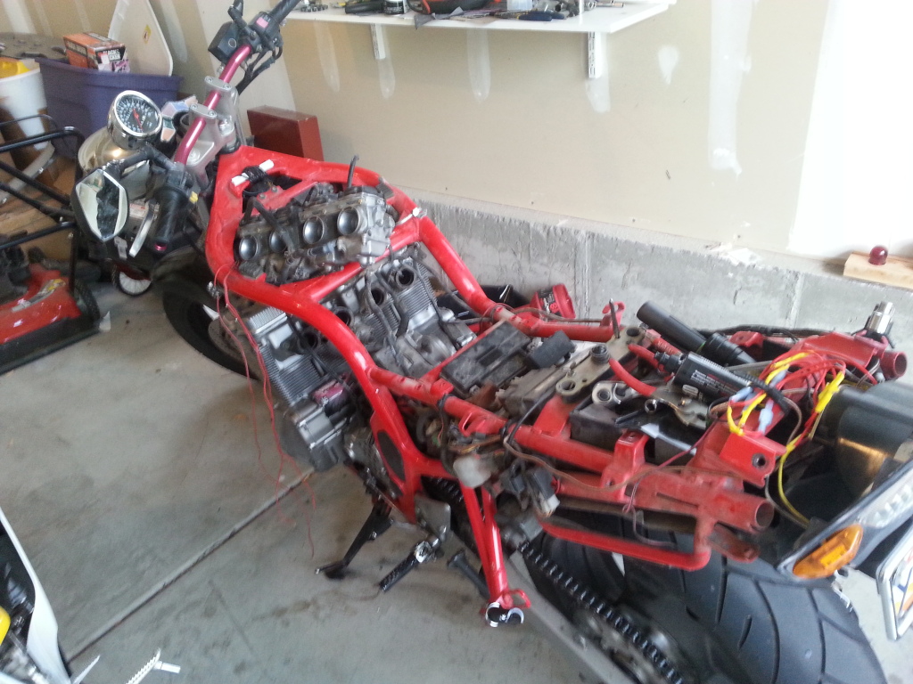

Sooo, I got this in.
Which led to this:
I got it together and took it for a spin and I must say the thing sounds awesome. It is running a little rich at the moment, so I need to remove one of the needle shims due to living at over 3000ft, but overall, $ well spent.
I'll get a pic of how the filters look tomorrow, and maybe a short vid if my phone will do it any justice.
