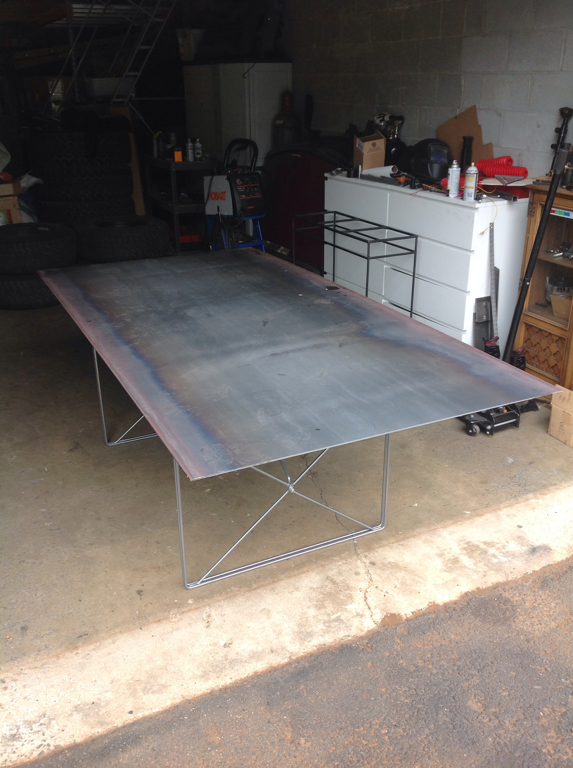

Picked up some steel for my next round of projects. I'll go against the norm and I'll start in the rear and work my way to the front!

What thickness did you get?

It's 3/16

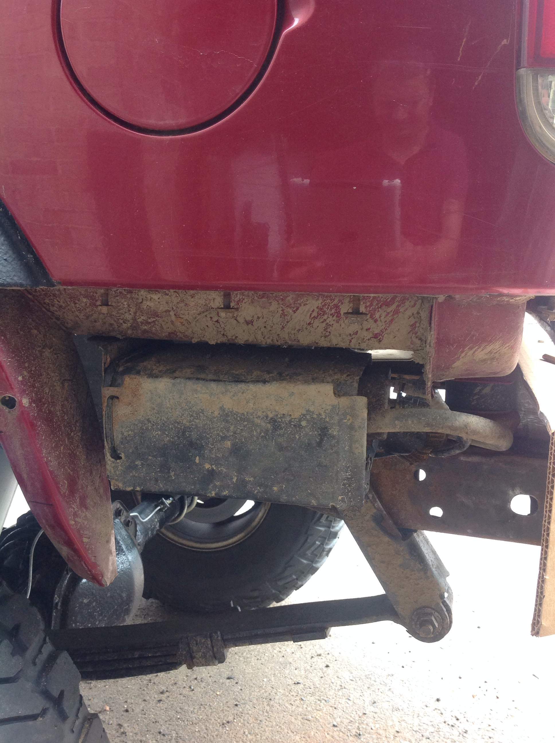

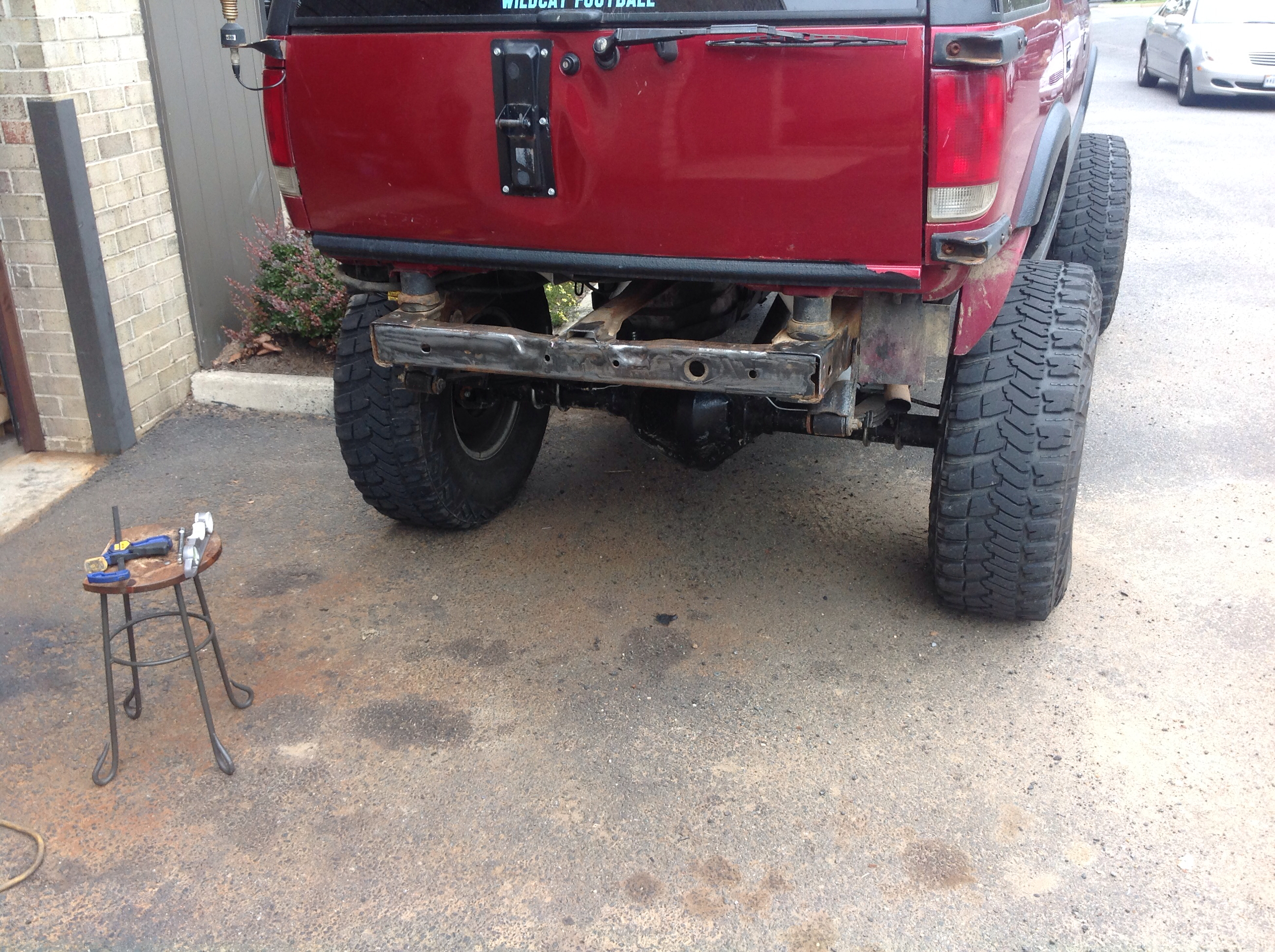

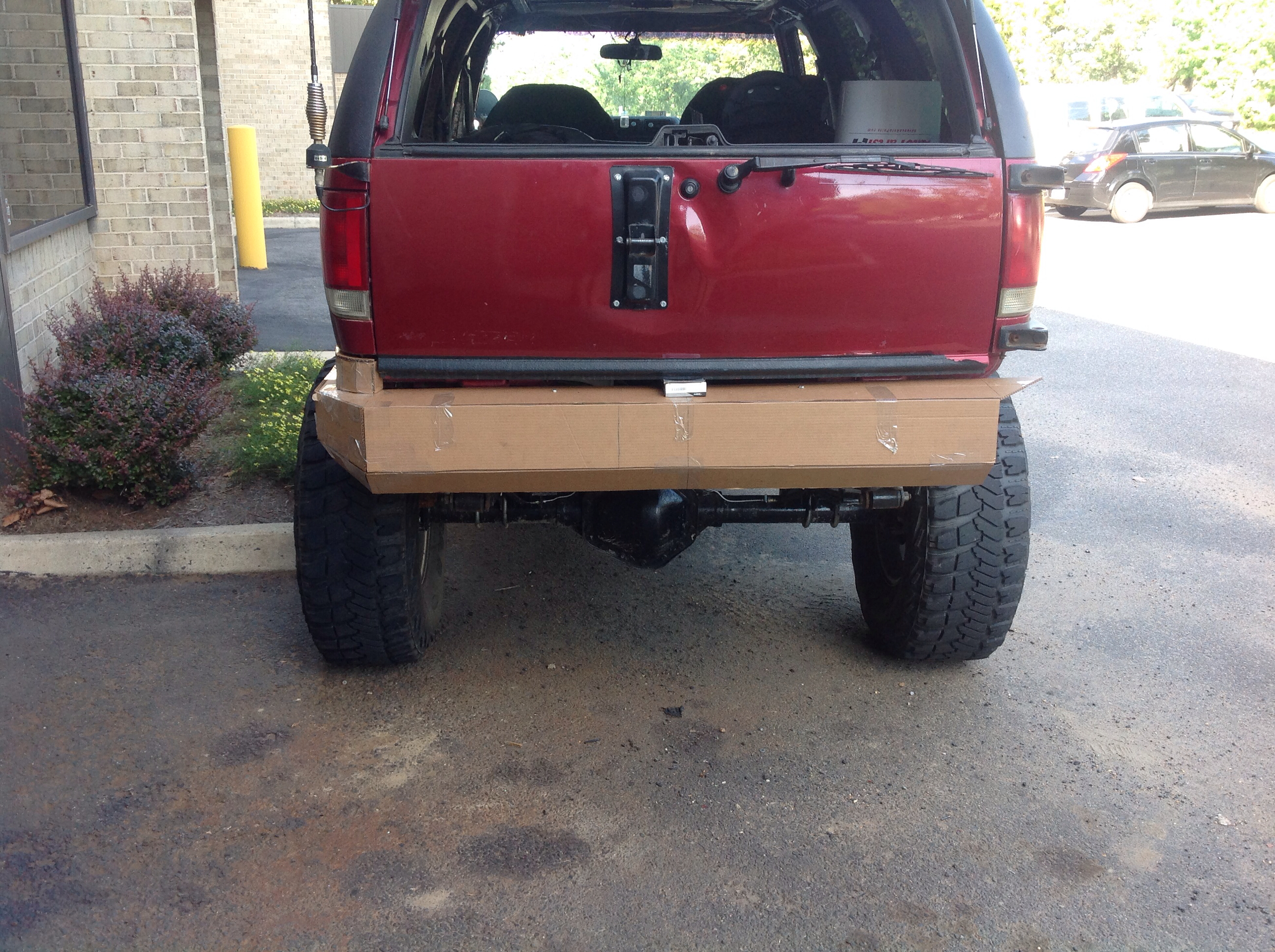

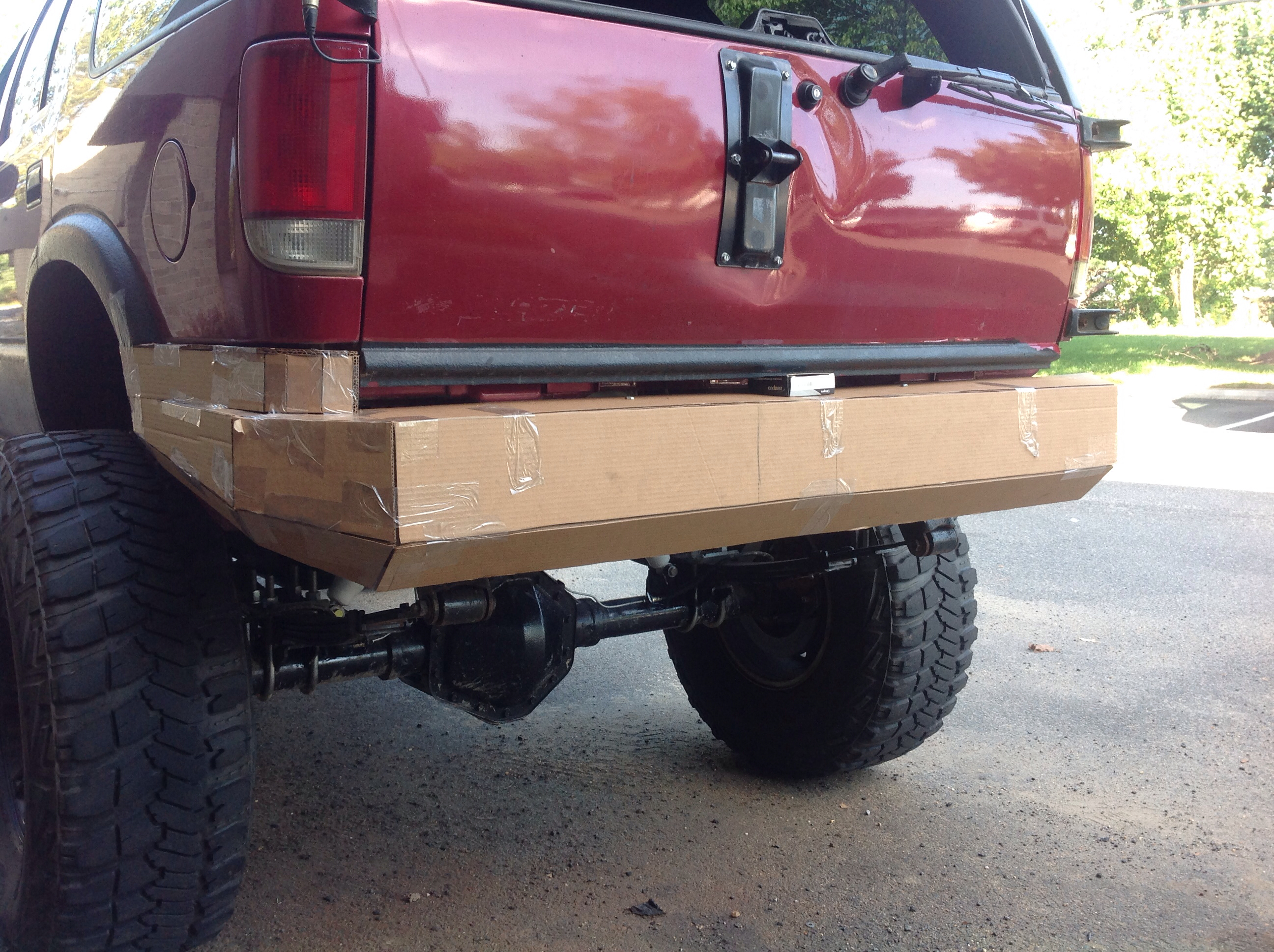

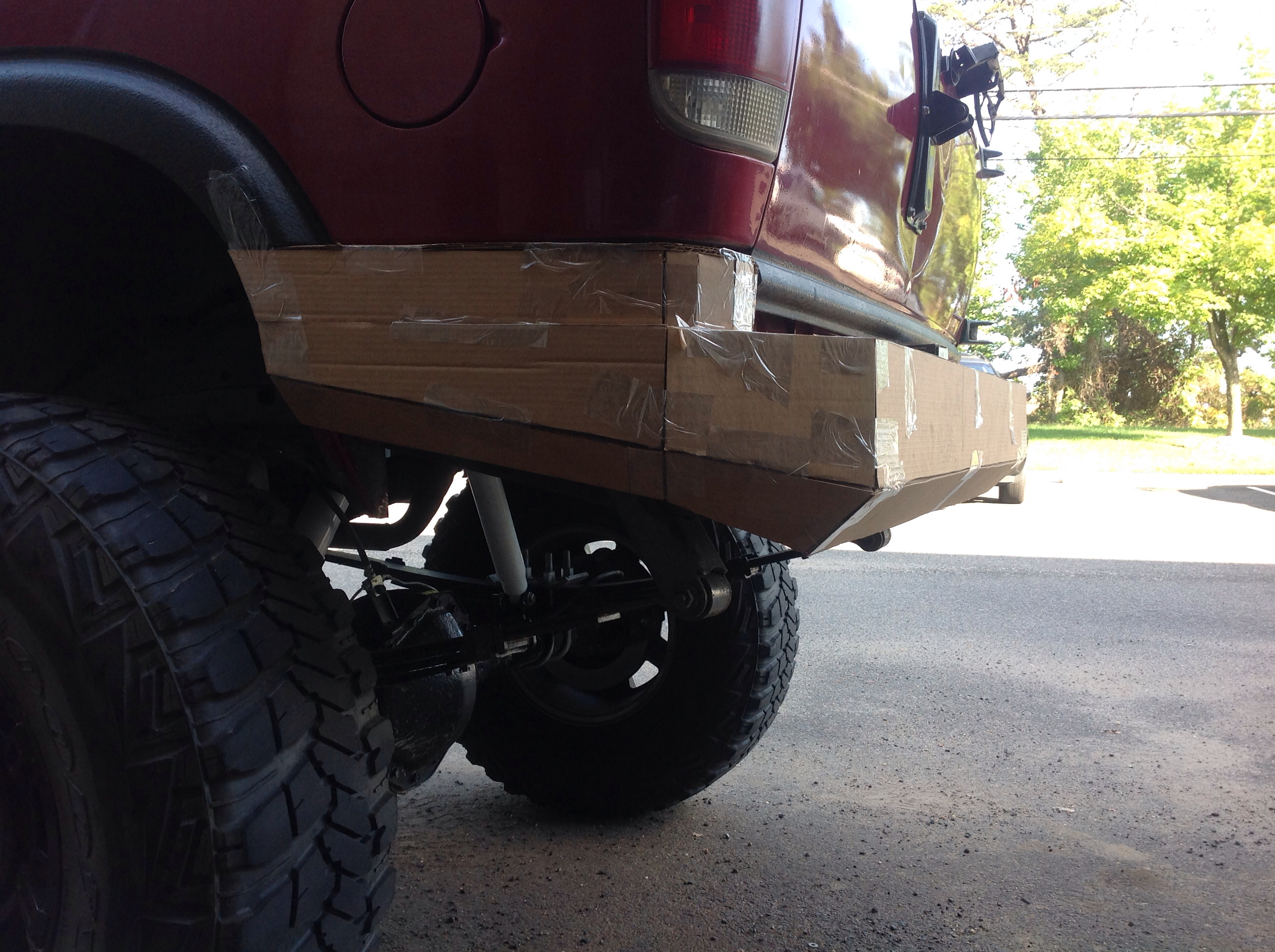

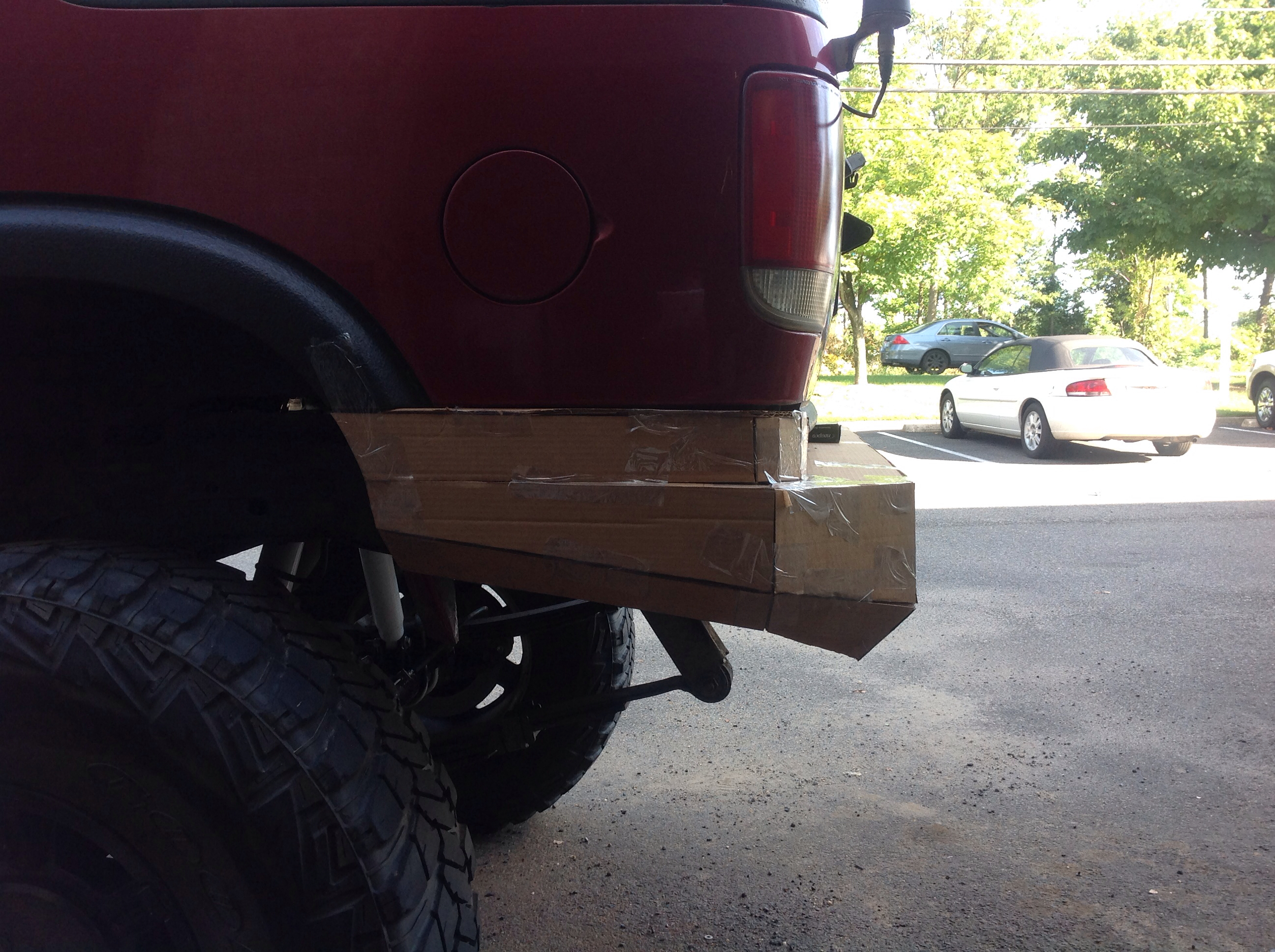

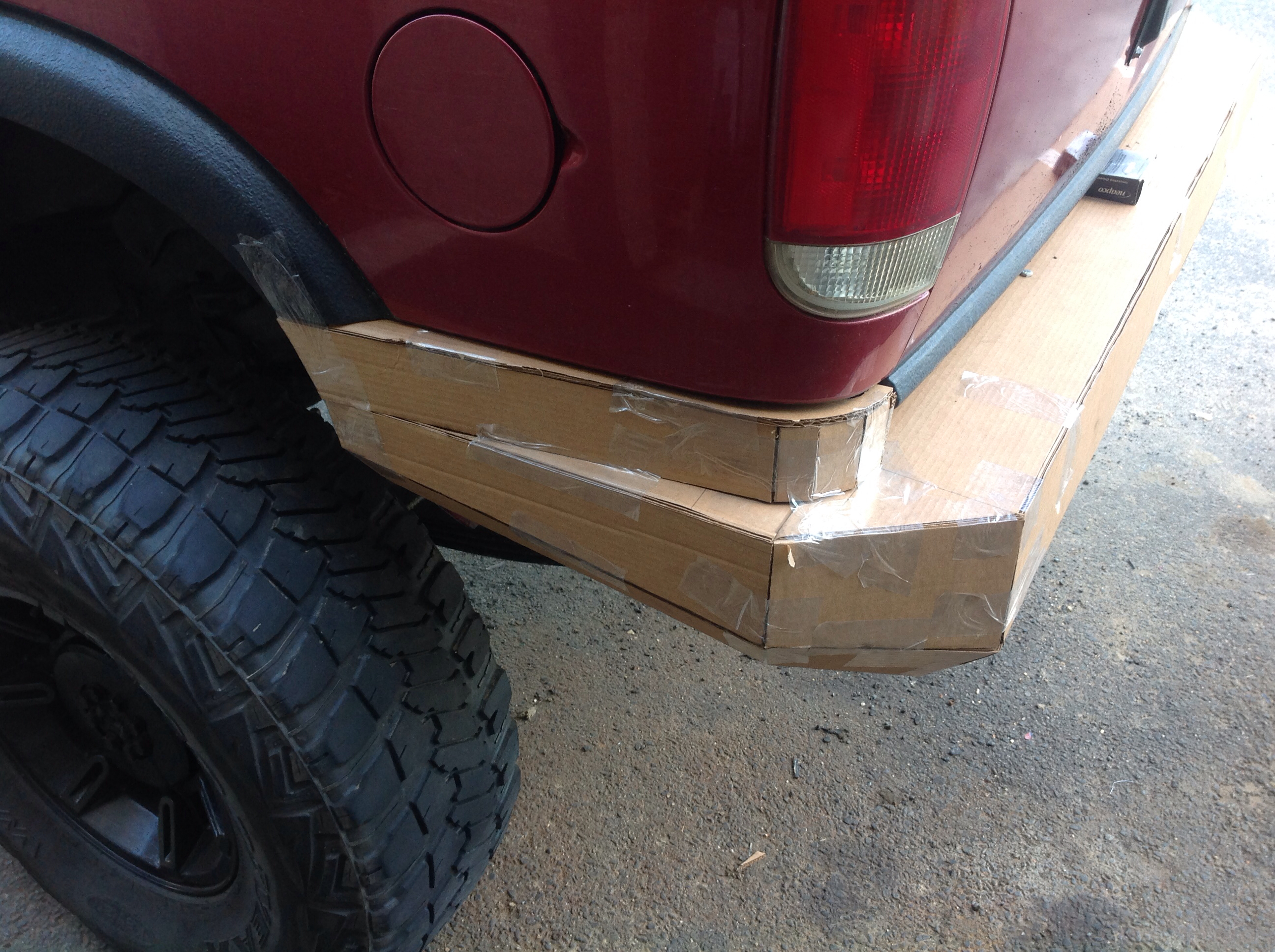

Got started on the rear bumper this afternoon. I think I'm where I want to be with it but I pulled it off to head home so I'll throw it on tomorrow and get a fresh look at it. The pics make it look a bit bulky but it's actually about an inch shorter than the factory bumper and a few inches shorter on the sides. If I didn't have the bl I would be able to make it 2" shorter but this is the best option in my opinion. Plus with not having the trailer hitch hanging down I'm gaining about 6" of clearance in the rear. I plan to build a receiver into it along with two clevis mounts for shackles. I also flipped my evap canister on its side and reattached it for more clearance. Let me know what you think anything you would change?
Evap canister

Naked and ready for mockup

And where I ended
