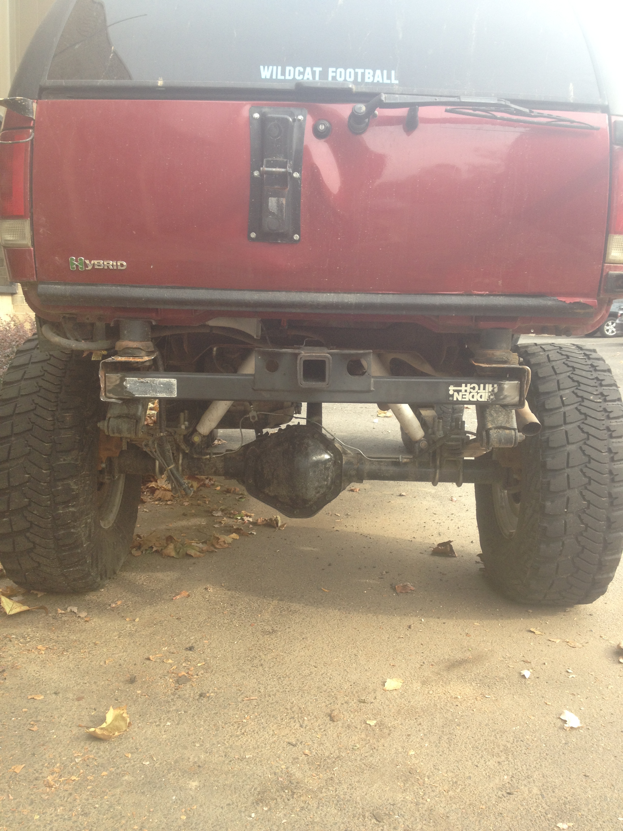

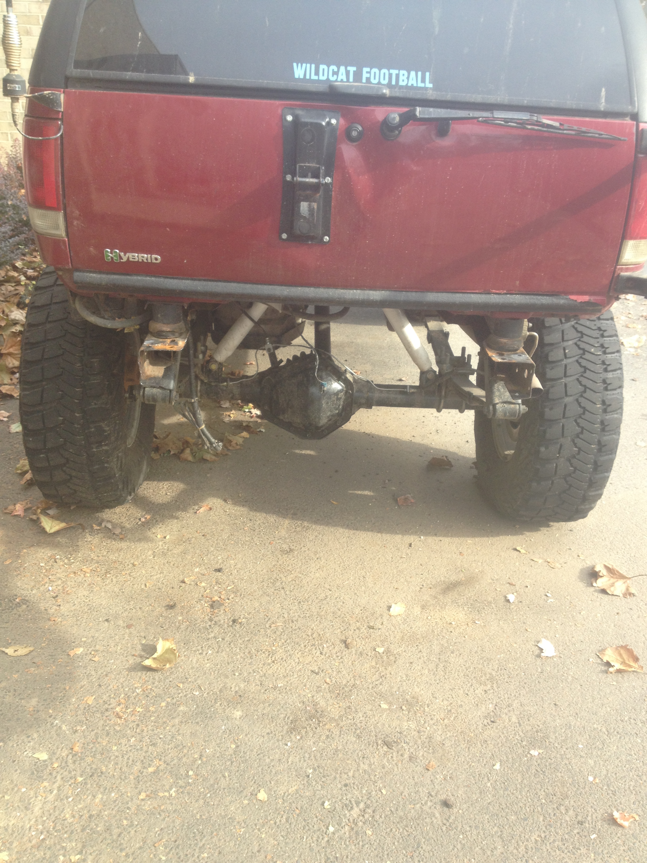

Got a good bit done on my bumper today. Rear crossmember cut out and gone. Sorry for the crap pics!

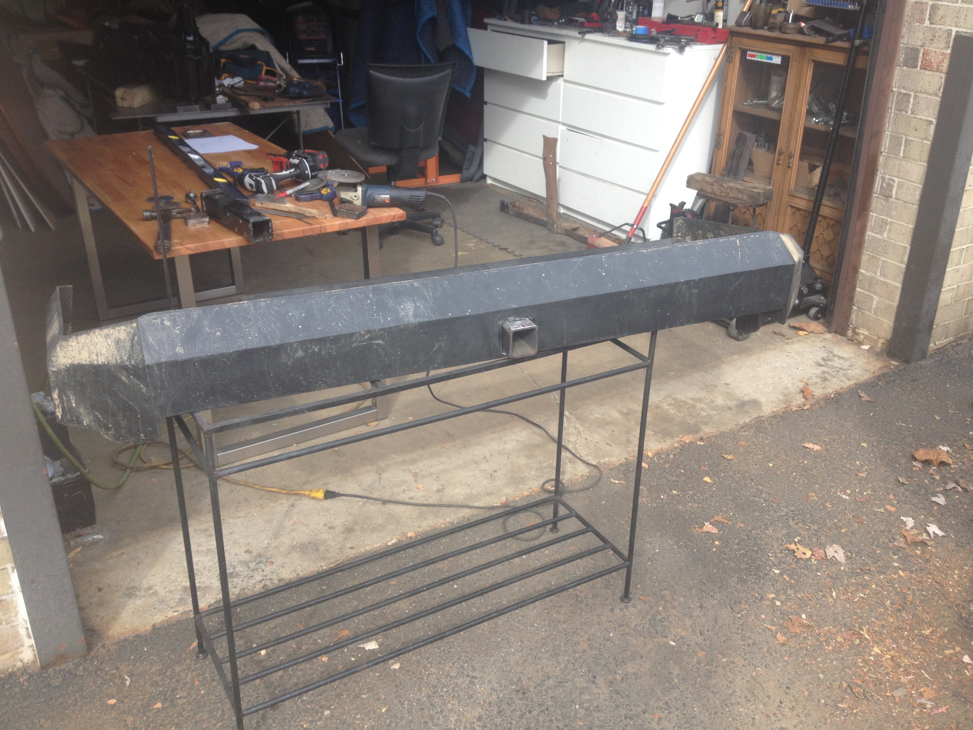

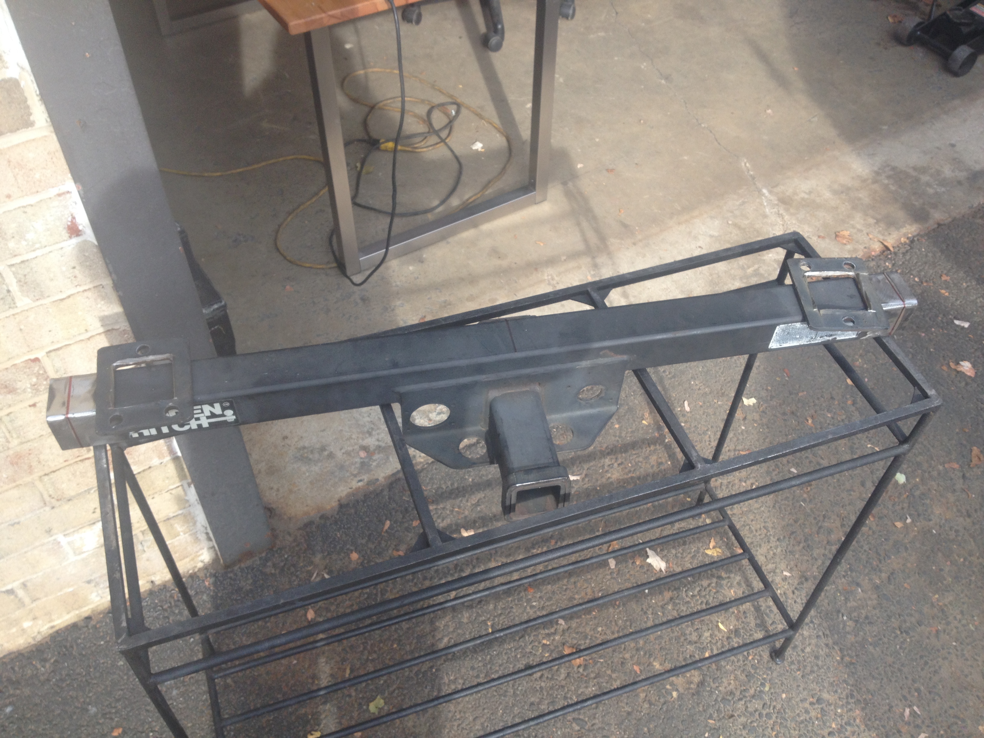

Cut the ends off the receiver and shortened it a tad to fit inside the frame rails

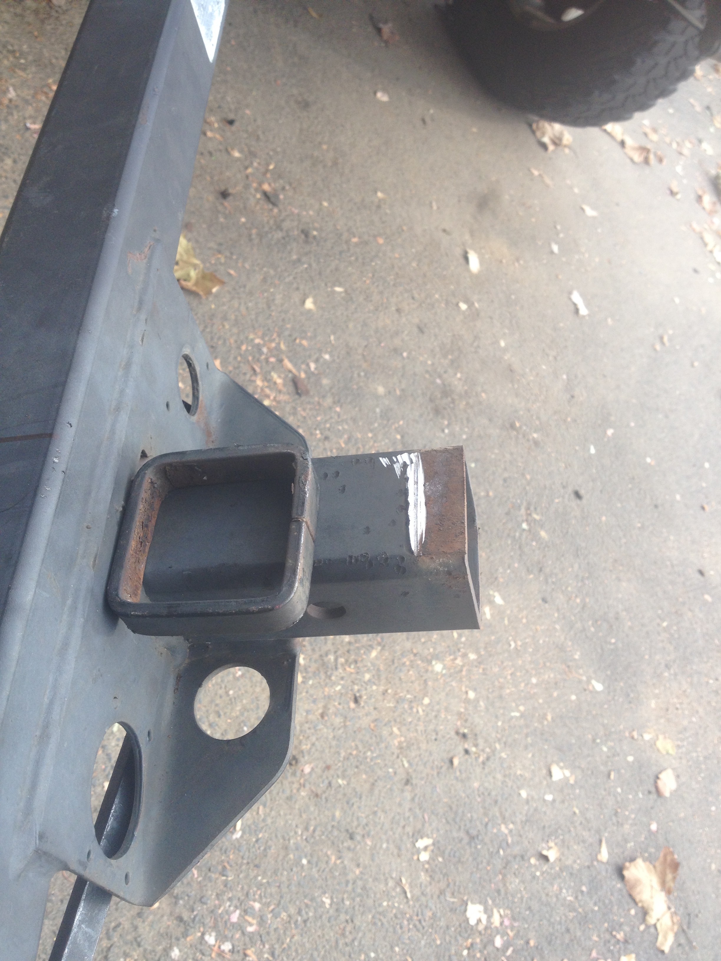

Cut what I guess is a reinforcement ring off the receiver it will go back on later.

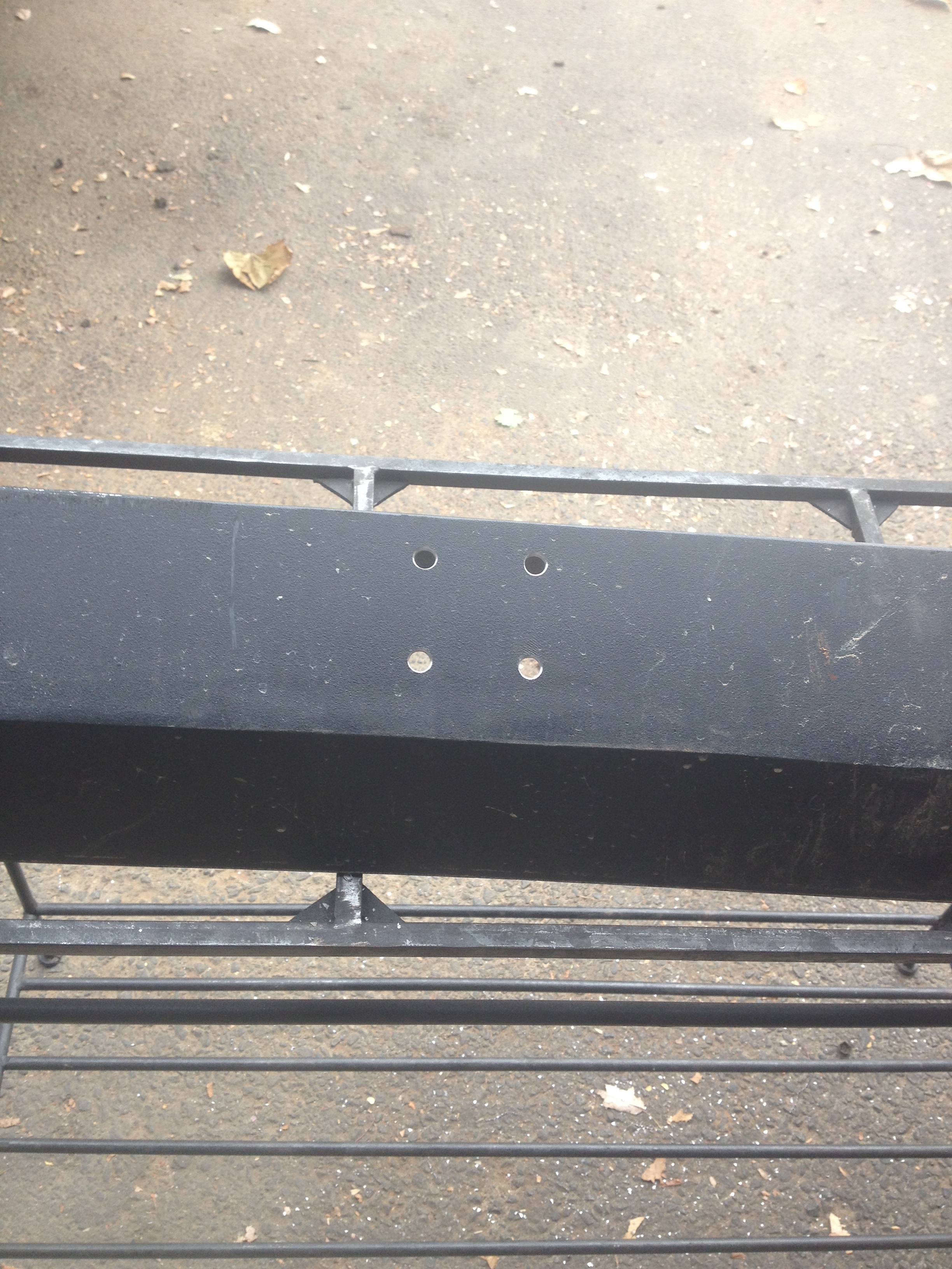

After a whole lot of measurements and test fits I drilled some holes.
Then I cut out the center for the receiver to slide thru. Now you see why I cut off the ring

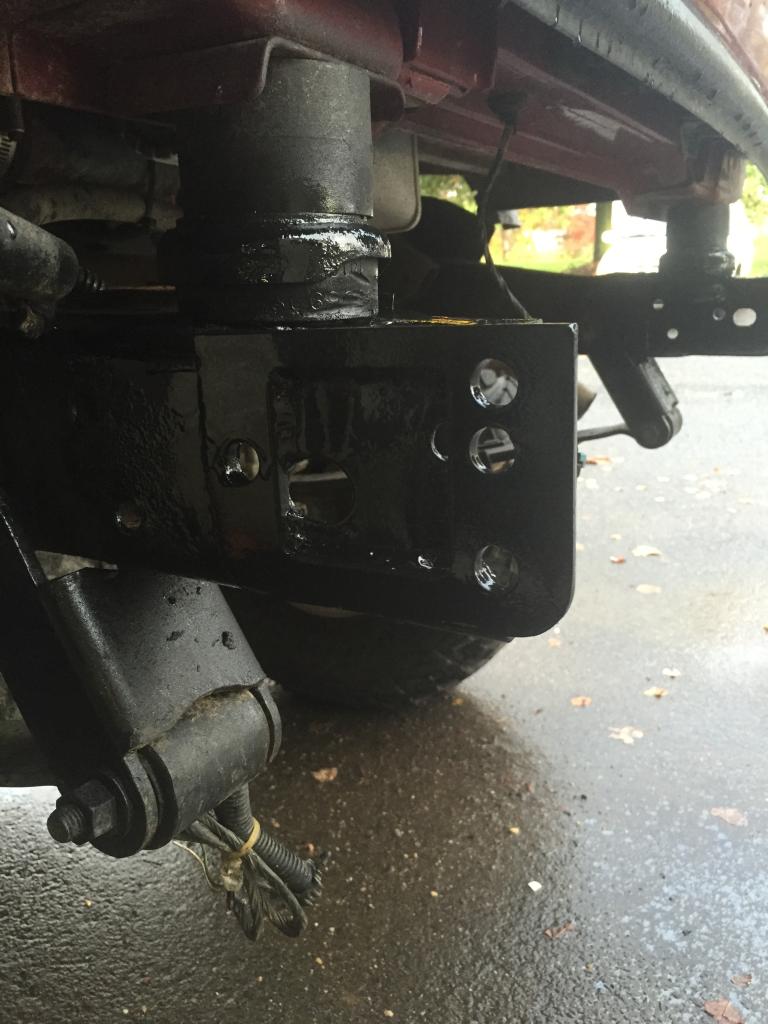

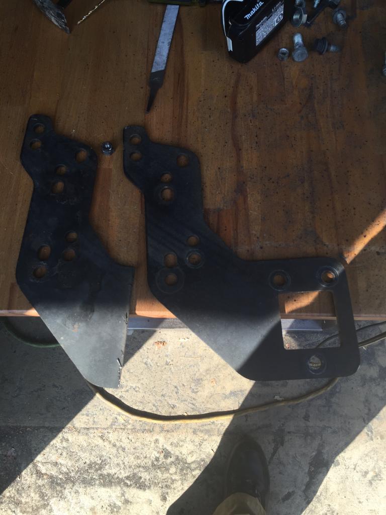

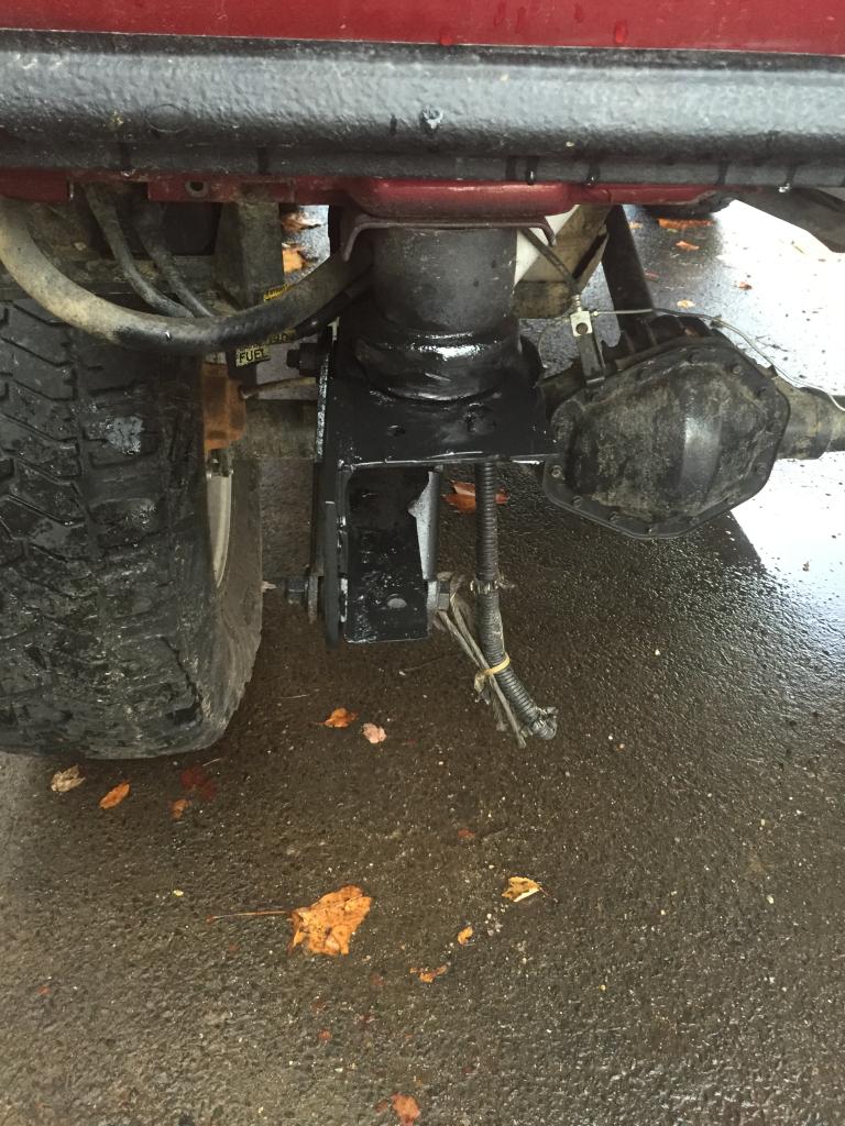

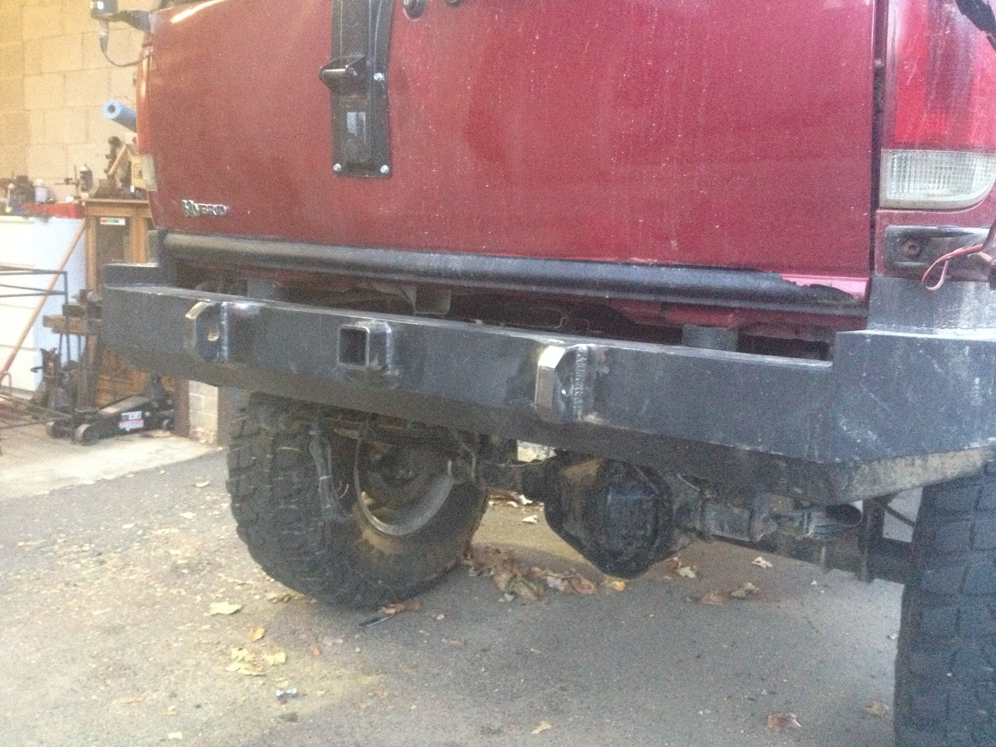

Bumper is finished and paint is drying! I'll get it put back on tomorrow and get pics but here's a couple to show how it will be bolted on. I think it's going to be more that strong enough and I am happy with how it has turned out!
For the frame side of things I cut the mounts from the hitch and welded them into the frame in the position I needed them. I was able to add allot of weld since they had hole through the middle so that added a solid 7-8 inches of weld to side for more strength
Not the greatest pic but you can see how they are attached
Good thick 1/4" steel as well for beef!
I'll get pics of the finished product up tomorrow.

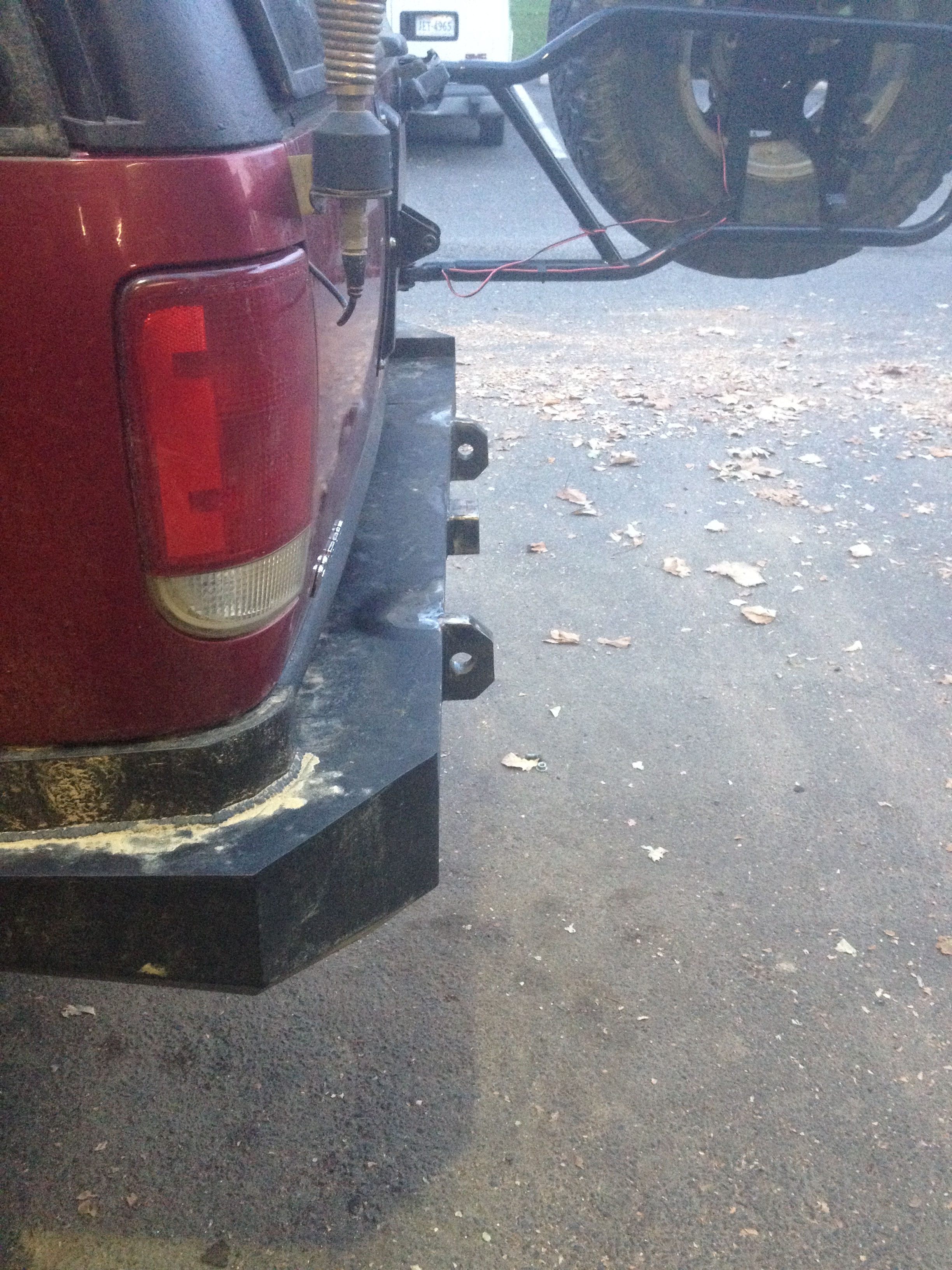

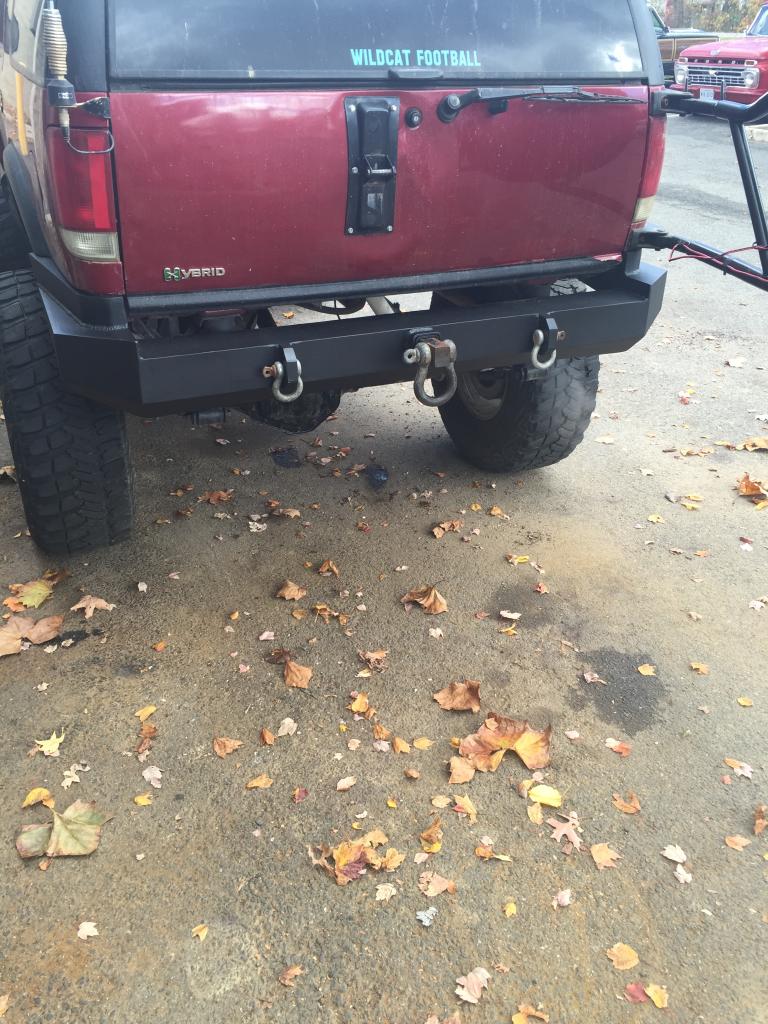

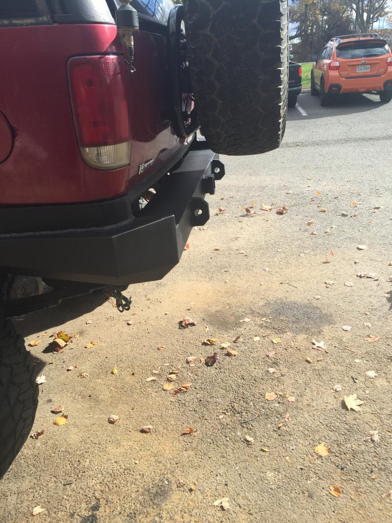

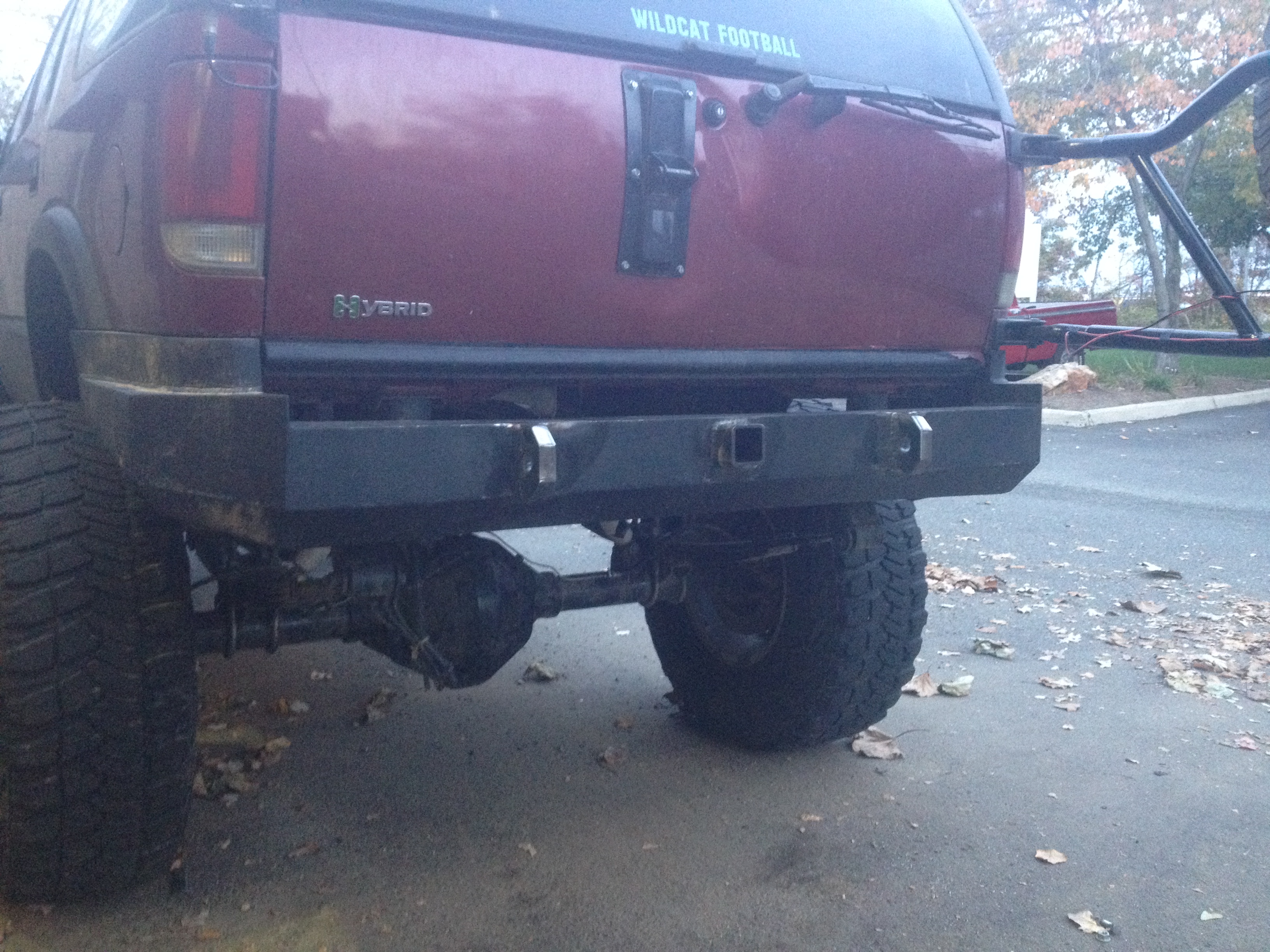

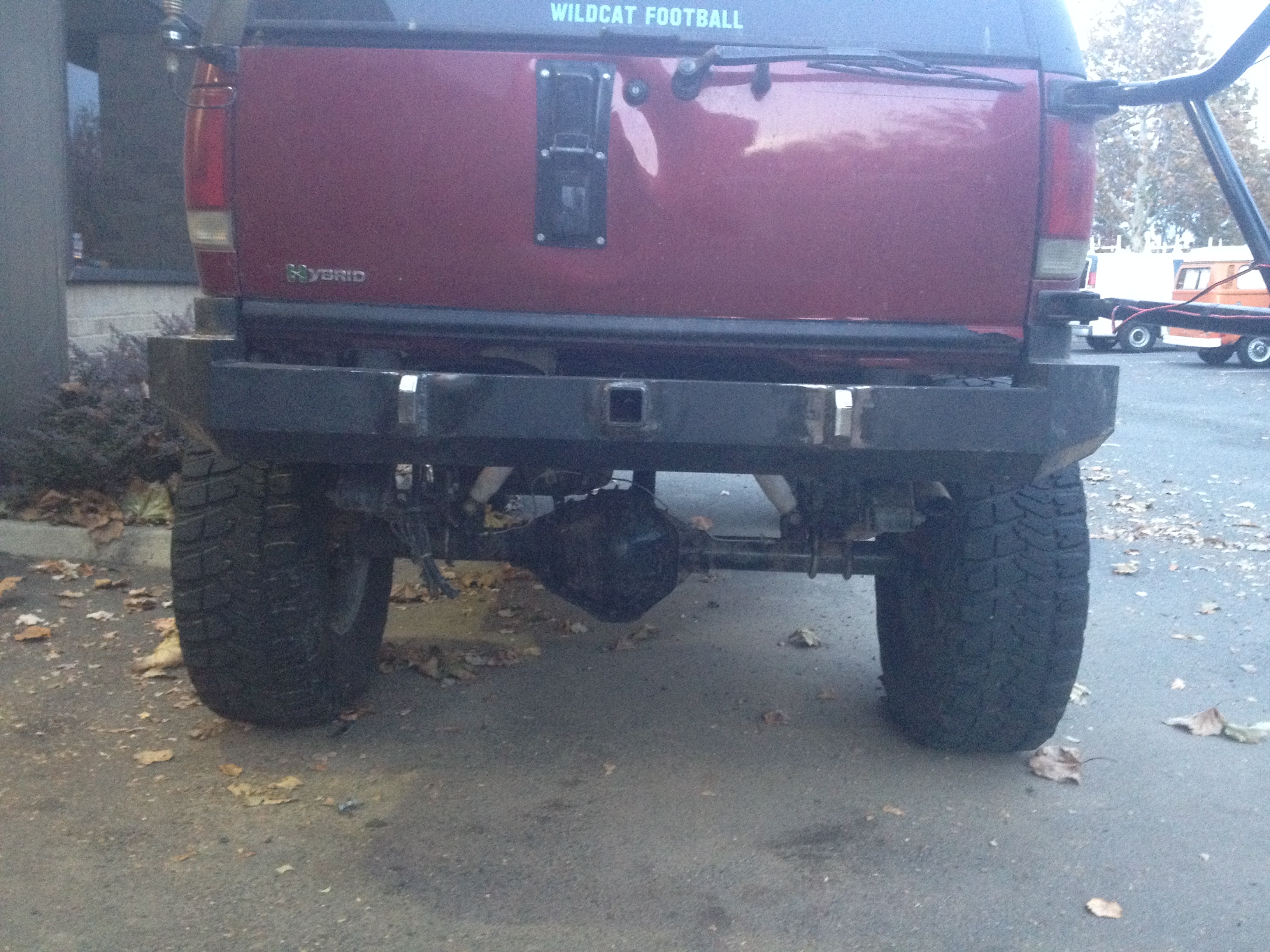

Bumper is finished!
I also spent some time messing with my gears and they are much quieter now but still not silent. I'm going to drive it for about a 100 miles and see if they quiet down any and if not I'll have a pro look at it when I have then install the front!
Attached Thumbnails My small 96 Blazer build-b2a6be5d-68b6-4766-9a34-694126c148c4_zps2pirnvpw.jpg   My small 96 Blazer build-e54d072b-3239-4bb7-a5d3-55ef6f99be6f_zps6d4fbfez.jpg
