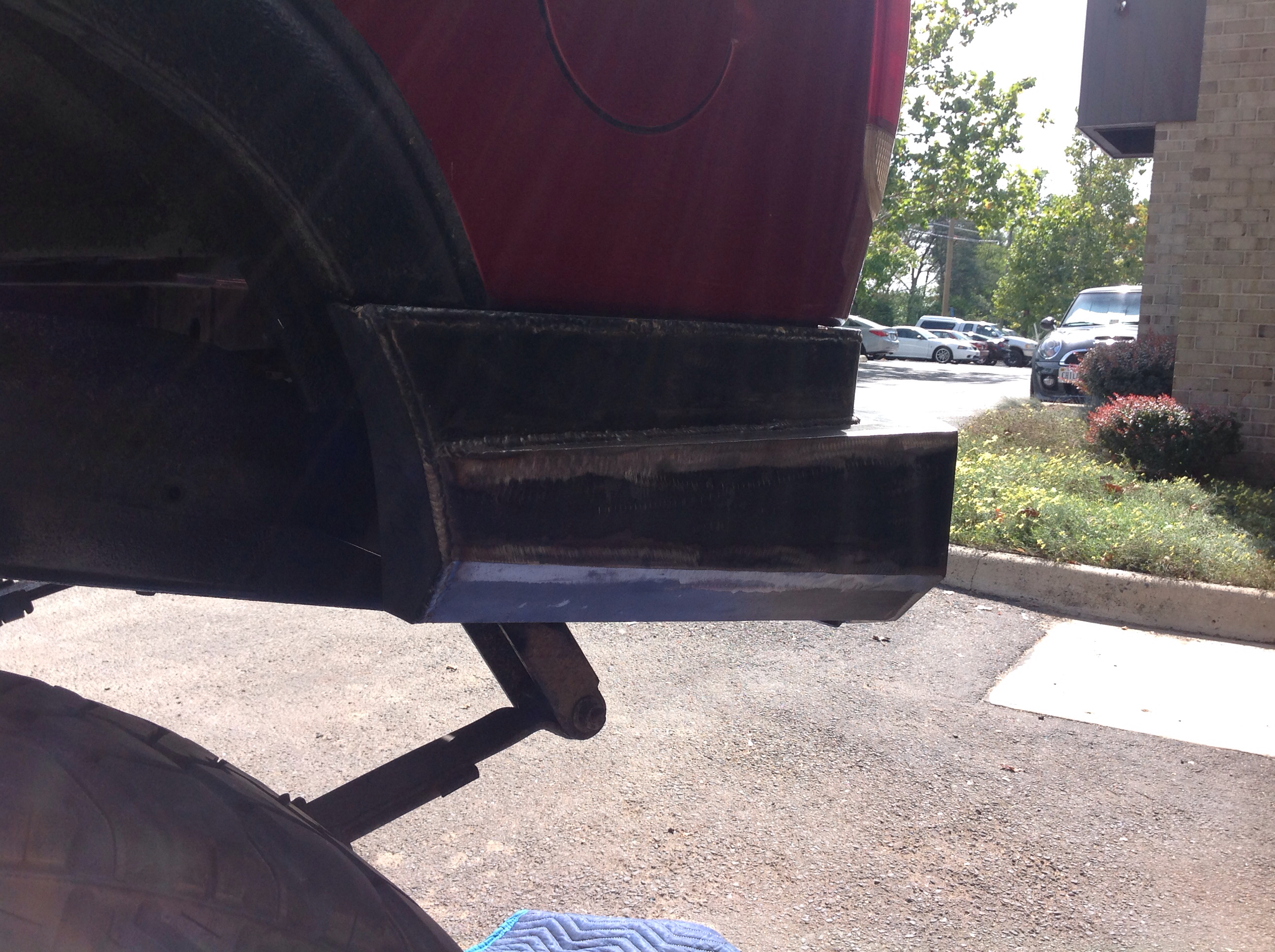

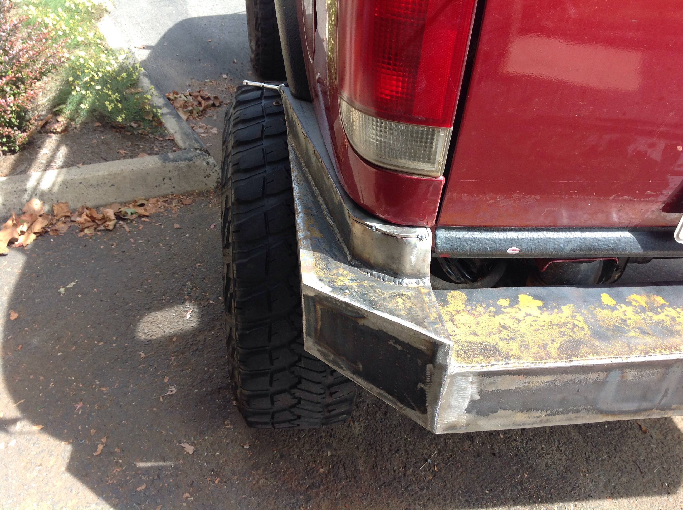

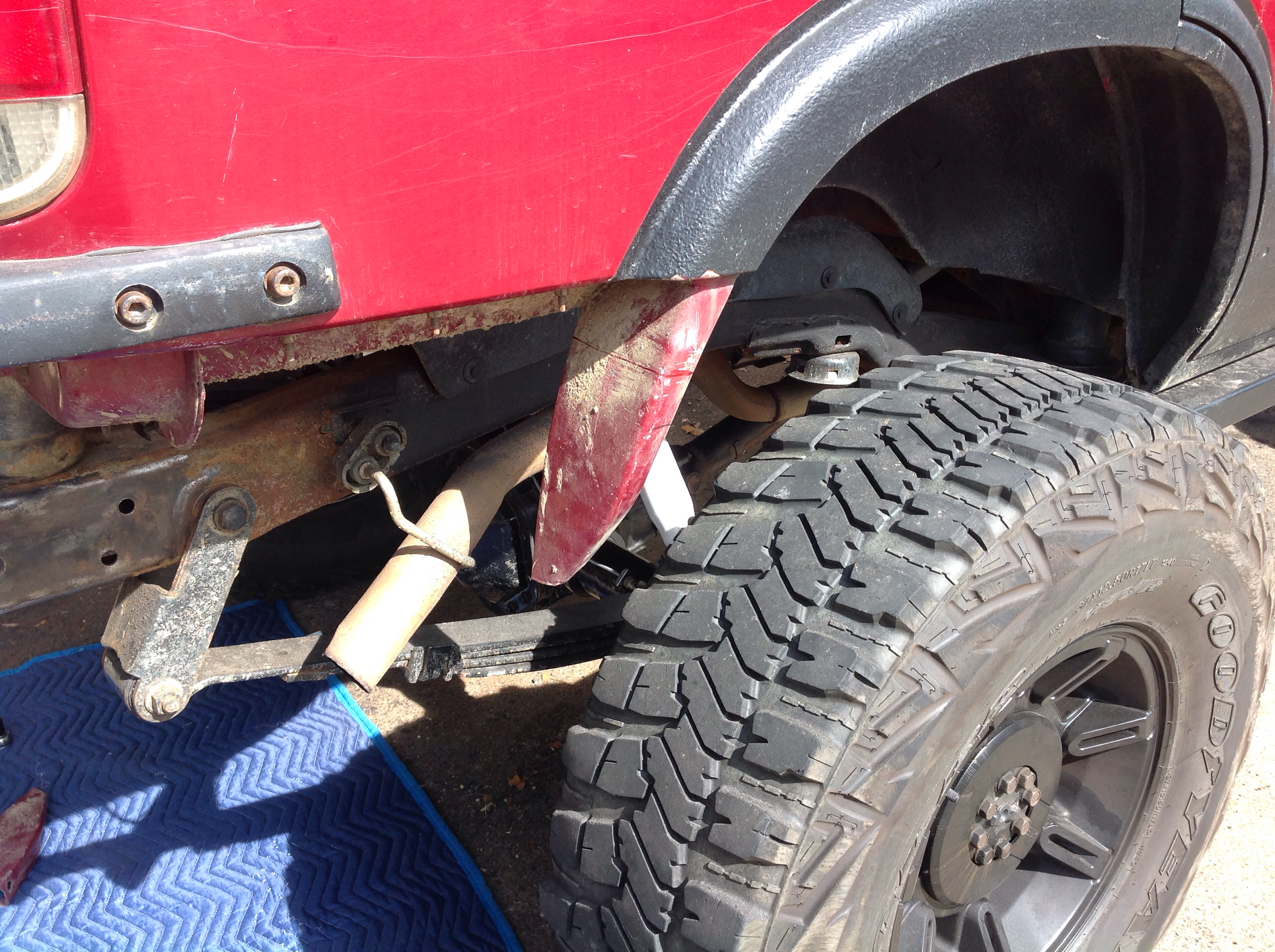

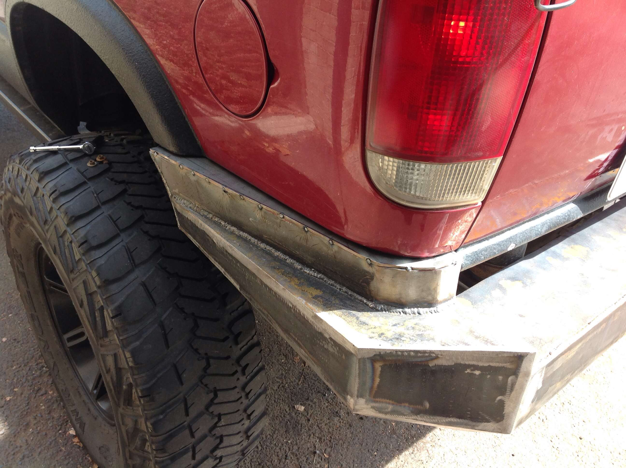

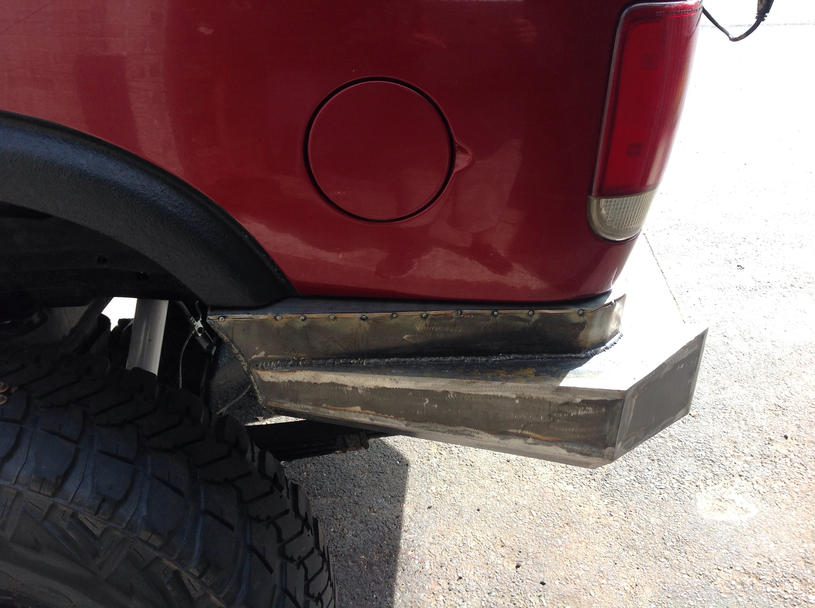

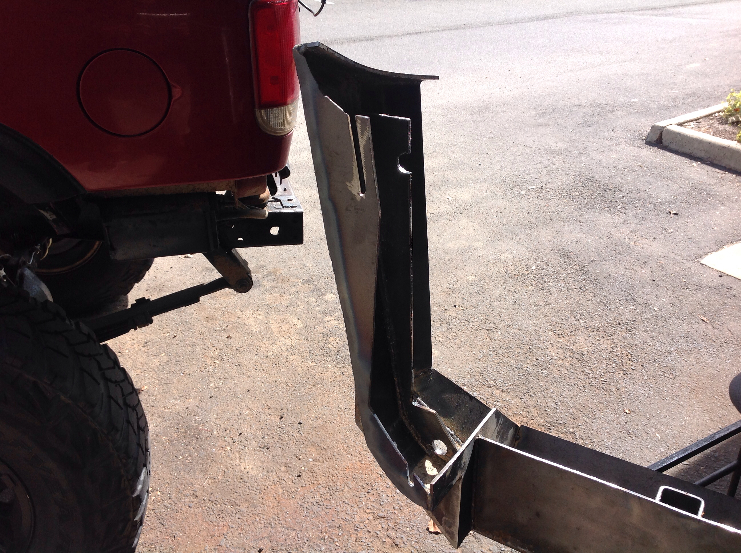

Got a good bit done on the bumper today. I've still got to cap the ends, trim along the fender line, gusset, add a strip below the tailgate and build mounts but you can pretty much see what it's going to be when finished. Overall I'm very happy with it.
