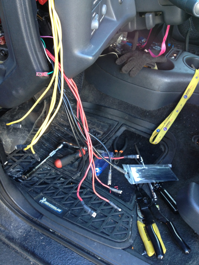

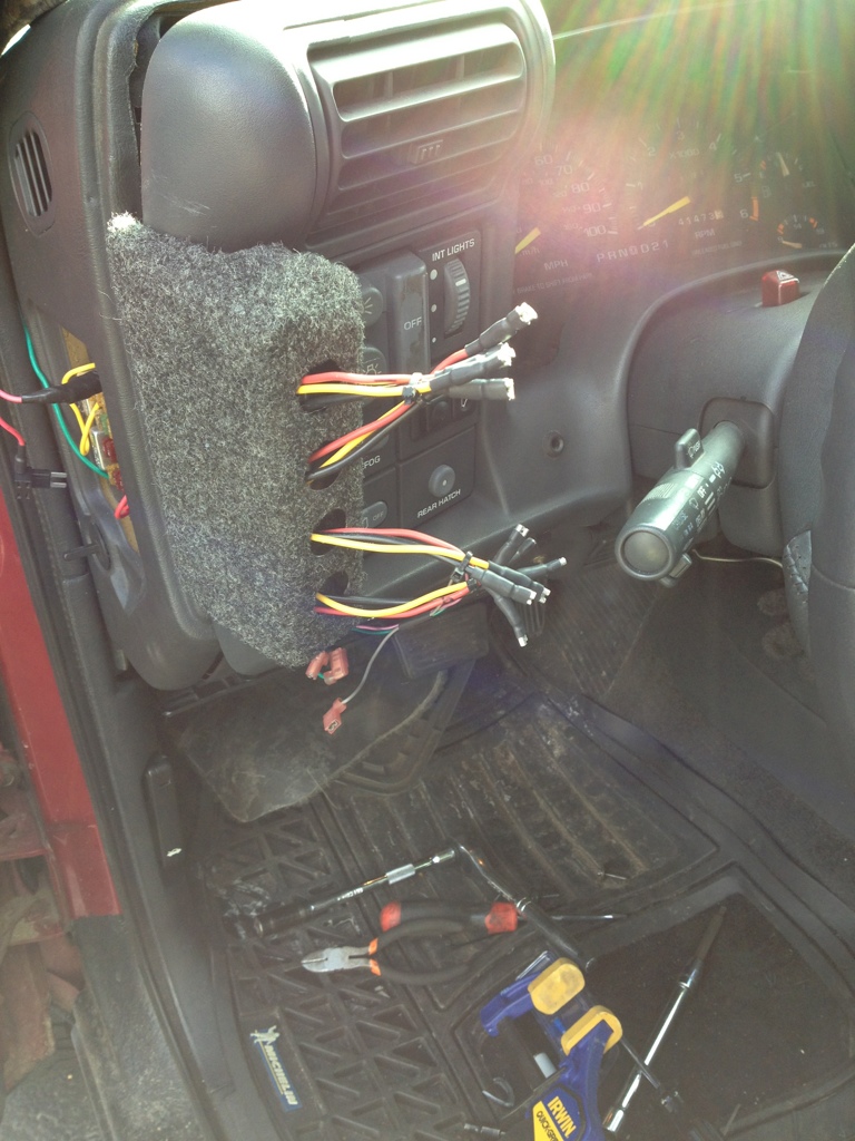

Well its only taken me most of the week working on it here and there but I finally have all of my wiring complete!! I made a total of 6 wire harnesses for the project but it was well worth it cause everthing is nice and tidy and looks nice. I didn't get pics of all the harnesses I made cause it was cold and I didn't even think to take pics

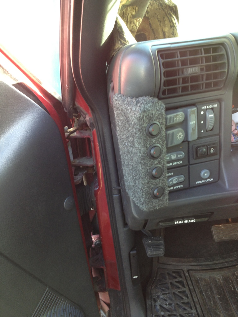

We will start with the switches I suppose.
And then I also restretched and fixed the top of the switch panel so it looks better. This is with all the wires attached and tucked away

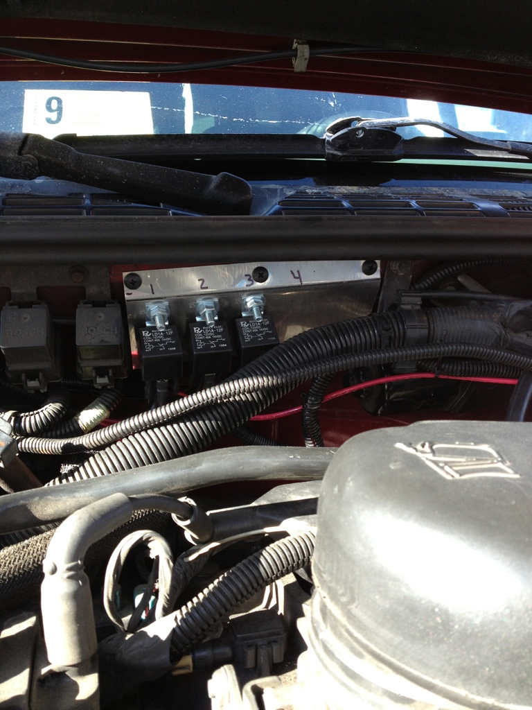

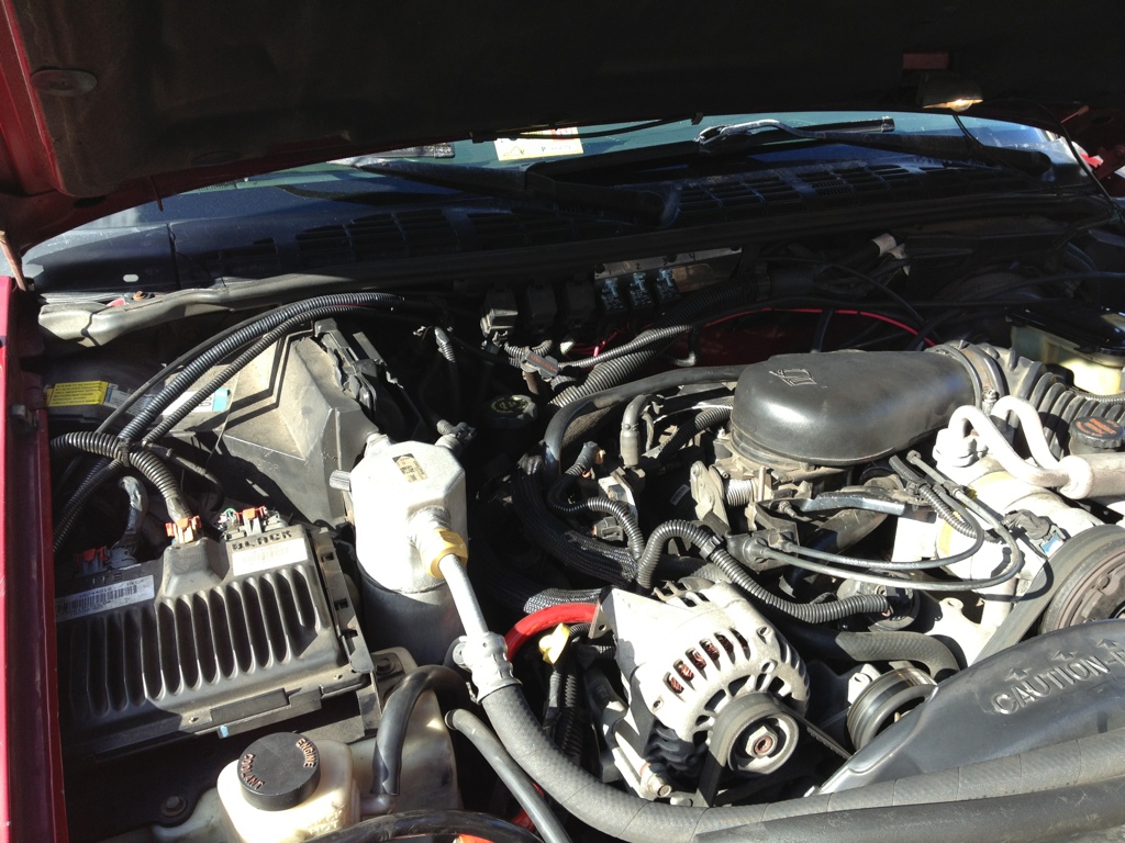

Then under the hood I made up a small spot to mount some relays and keep them out of the way. They are all wired and all I have to do is run one power wire to the relay and whatever I connect to it and I'm done for the additional two relays I am going to add one more relay I just didn't have one at the time but it will be coming and the wiring is already there from the swtich for it as well.
And heres a shot of the whole engine bay after everything is wrapped and cleaned up

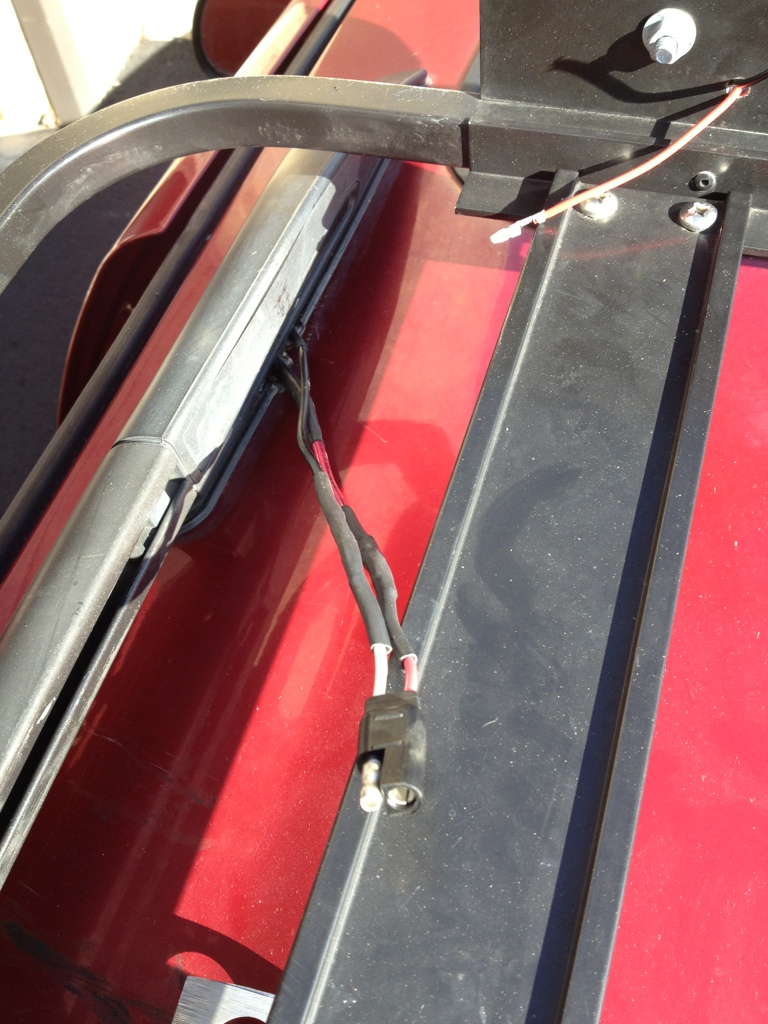

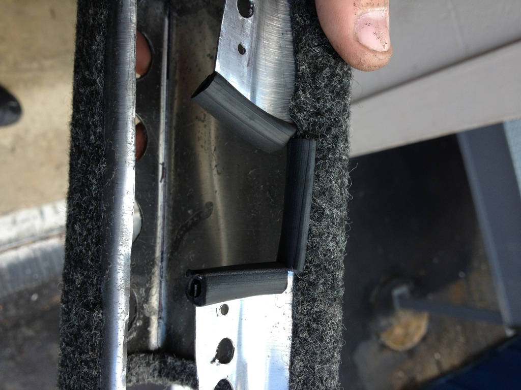

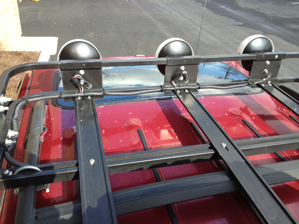

Then on the roof I ran the wires through a hole I drilled under the support leg for the factory roof rack so that no wires would be running through doors and looking out of place. I decided to use "2 flat" connectors on everything cause they serve their purpose and they were only $3 a piece at Advance Auto.
I used the same connectors for all of the lights as well so now it is set up that I can remove my enitre roof rack by just unplugging one connector or I can remove lights individually if necessary.
The connector tucks away nicley inside the rail and is hidden away a bit.
And after all of that this is what I ended up with.

Looks good! Any plans to label the switches, or just going to remember which is which?

Yeah I'm searching for a non cheesy way to label them. For right now I only have two things running off of them so I know which is which but I will need to do something for sure I'd hate to have the wife throw on the roof lights at night and blind someone lol!

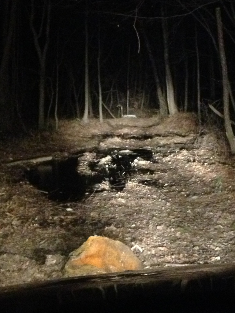

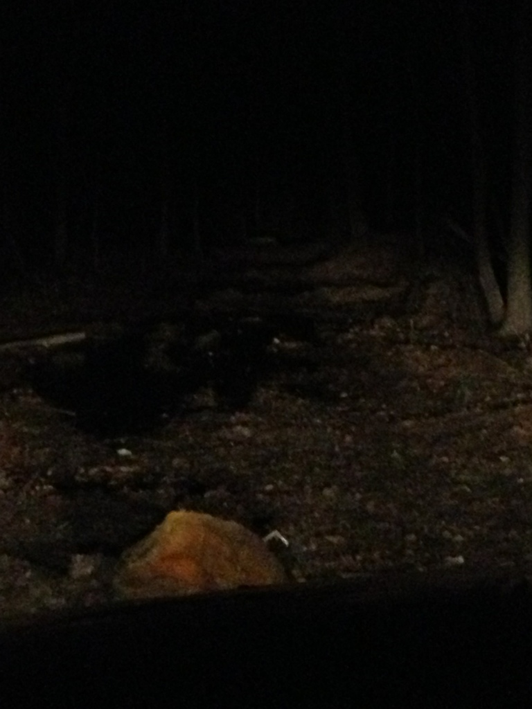

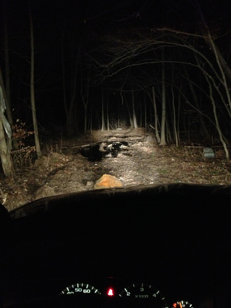

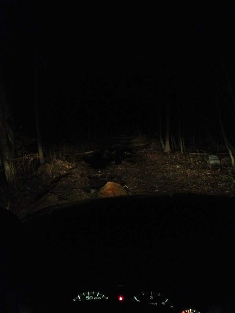

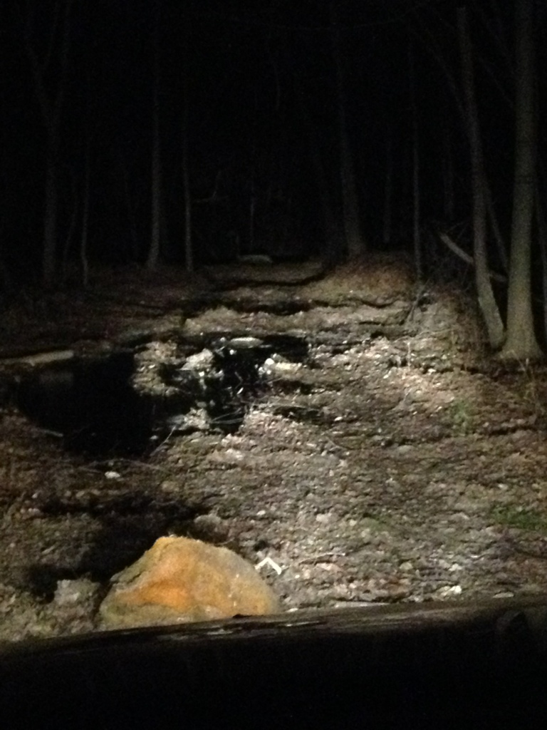

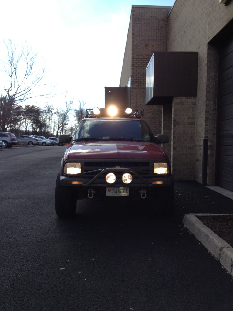

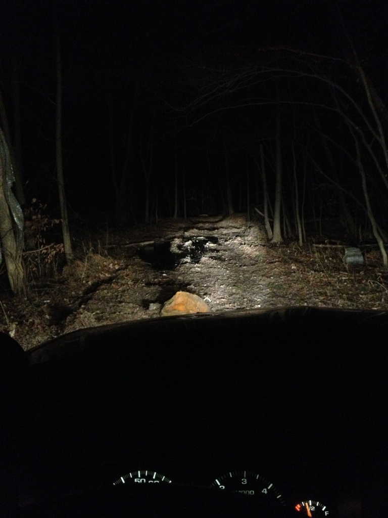

Well I came back to work late last night to drop off my work truck and decided since it was dark out I would drive down in the woods and see how well my new lighting setup worked. Heres a couple pics.
Sorry for the crappy iphone pics! The manhole is about 50 yards away.
Factory high beams
The same zoomed in a bit
2 Prerunner bar lights and factory highs
2 prerunner bar lights factory highs and three roof lights
I want to add two flood pattern lights to the roof in between the two outer spots but I'm happy for now.
