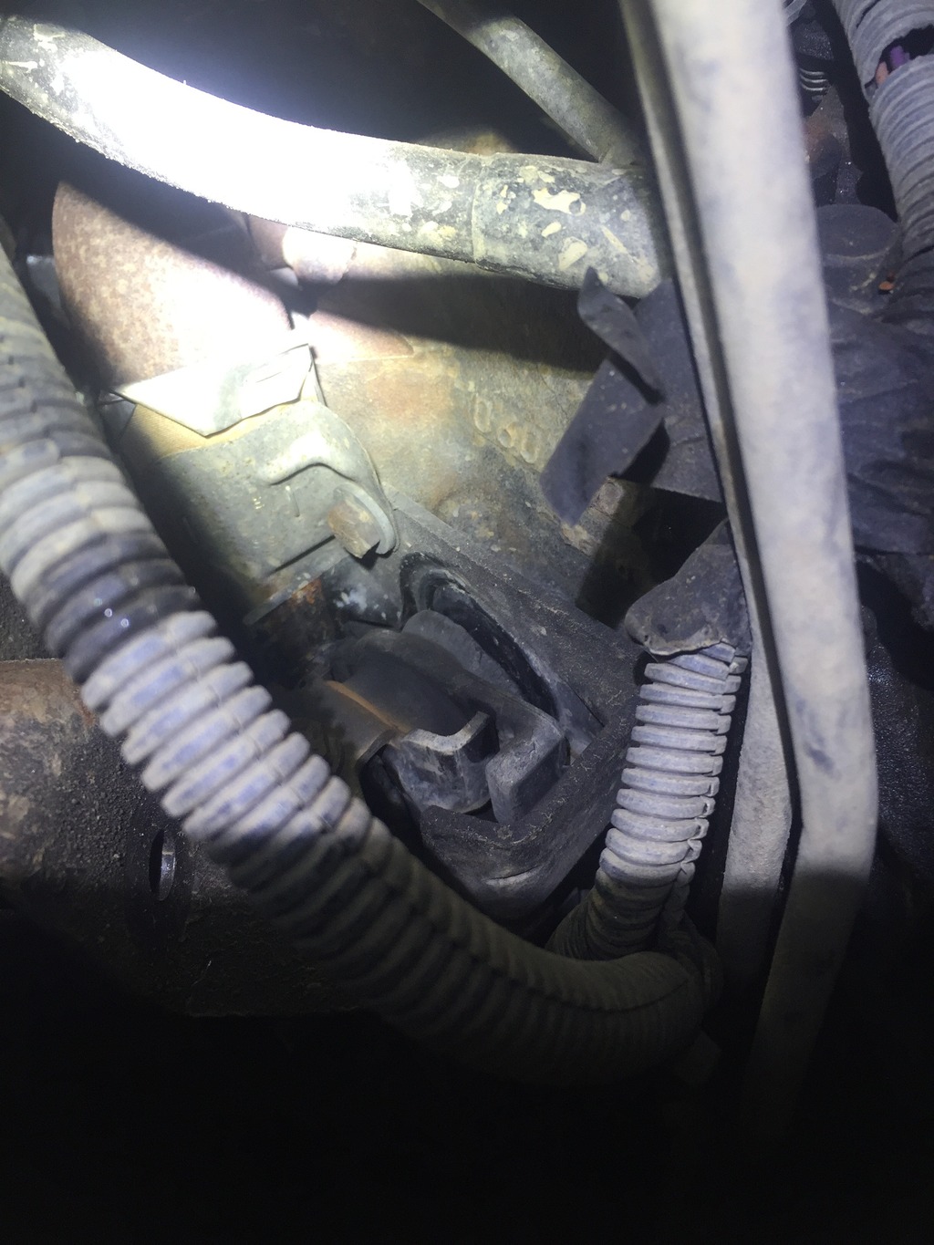

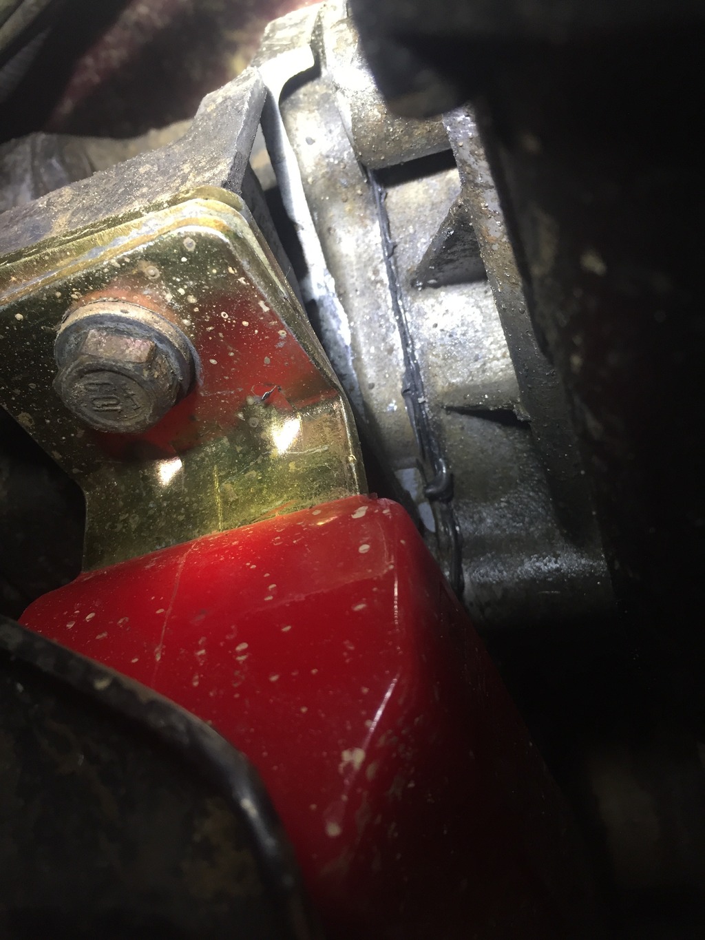

Today a swapped my motor mounts. I'd say they were very long over due! The motor was about an inch forward of where it should be so I used a porta power and pushed it back in line.
I replaced them with new poly mounts and everything went easy and well until it came time to put the bolts back into the trans mount (i had removed them before pushing the motor back) and that's when I found that my new poly trans mount was doing its job a little too well without any motor mounts holding everything in place lol!
Luckily it is only the adapter between the trans and tcase that's broken and I've already got a spare for some unknown reason but it is more work that I wasn't counting on.

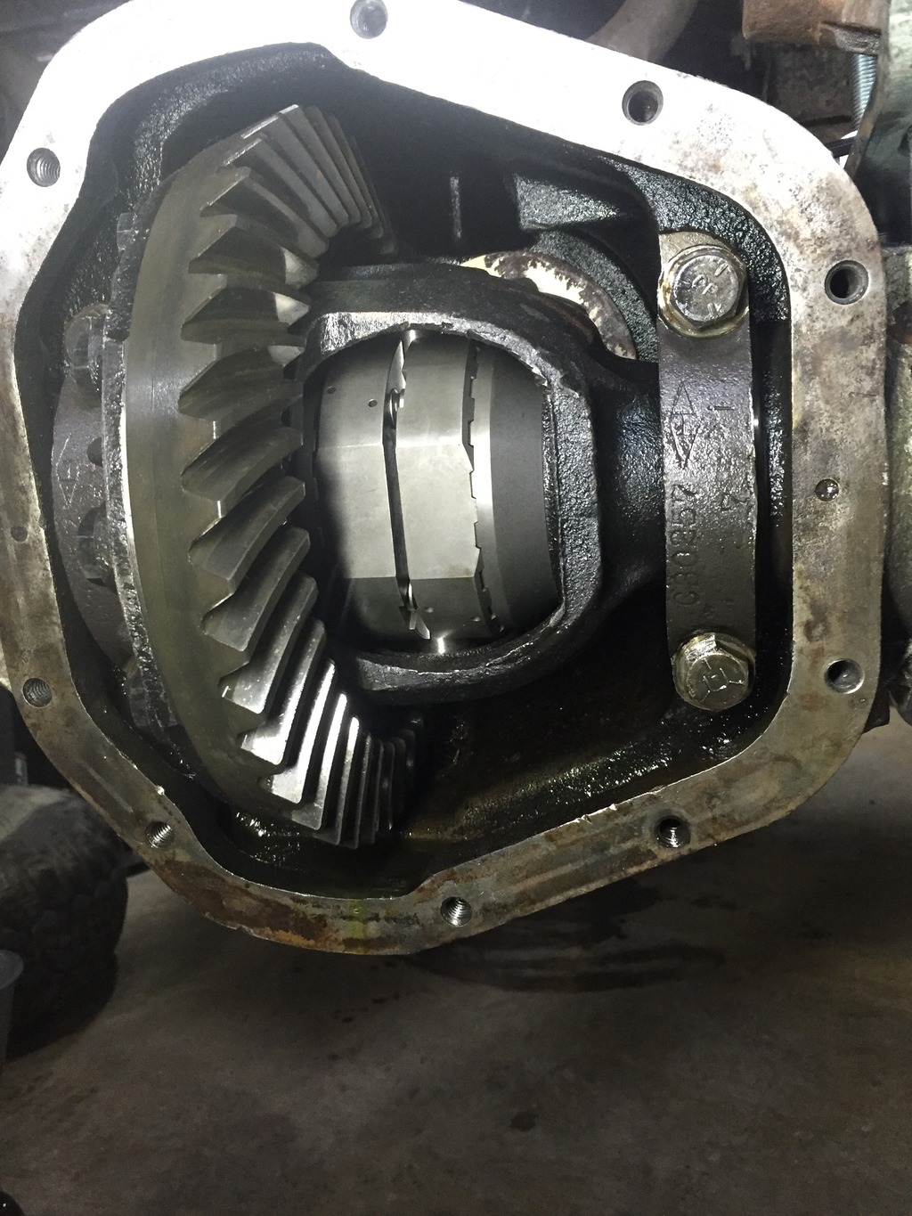

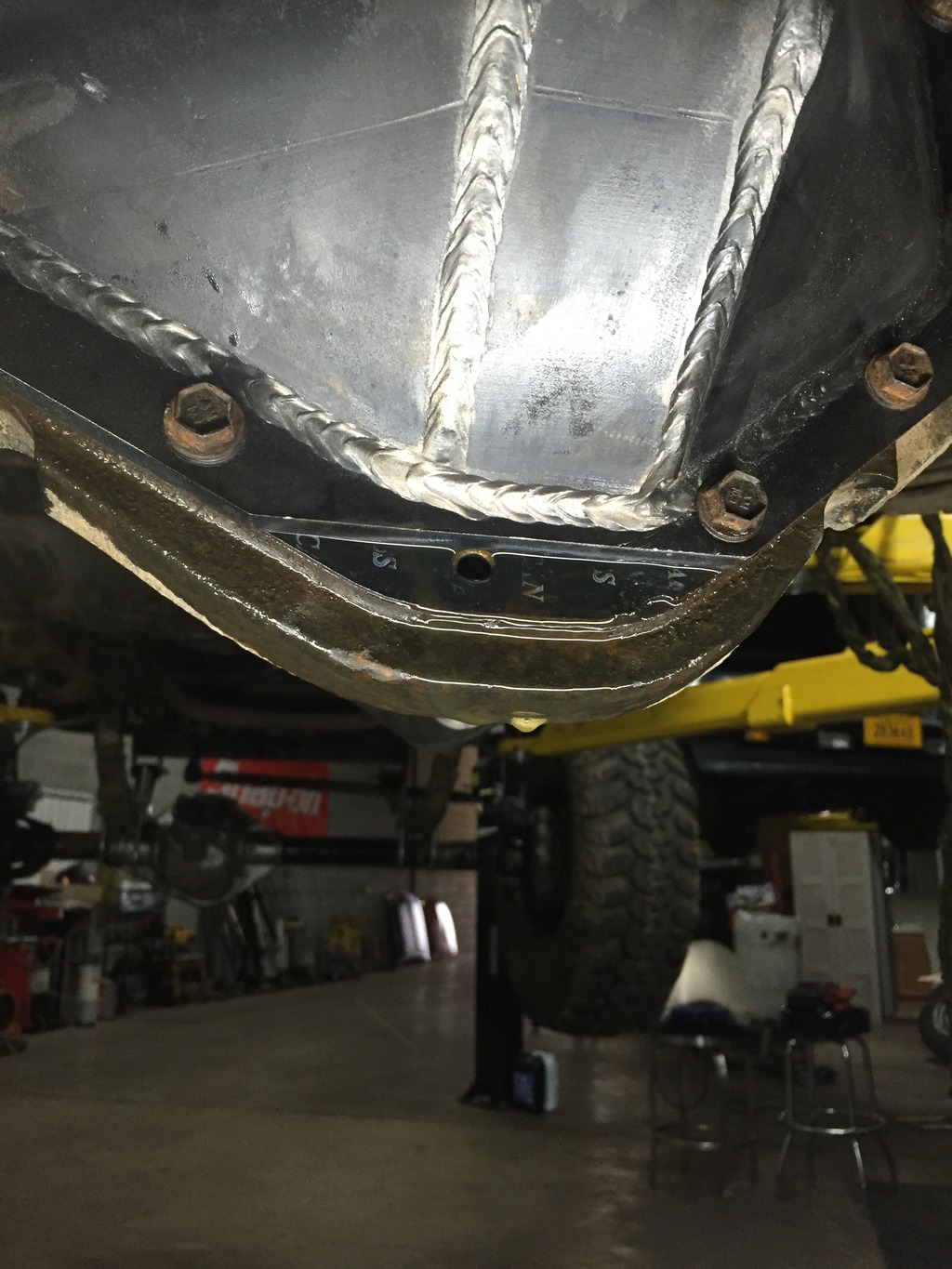

Got some goodies installed today!
Pinion guard along with drilling out the yoke to run u bolts instead of straps
Spartan locker up front and the rest of the axle is fully assembled.
14b shave cover is installed but may be coming off in favour of a full cover as the newer axle that I have has a drain built in to the bottom of the pumpkin that would leave a big hole if I were to shave it as much as the cover allows. I'm going to look it closer tomorrow and make a final decision.
Here's a test fit pic
