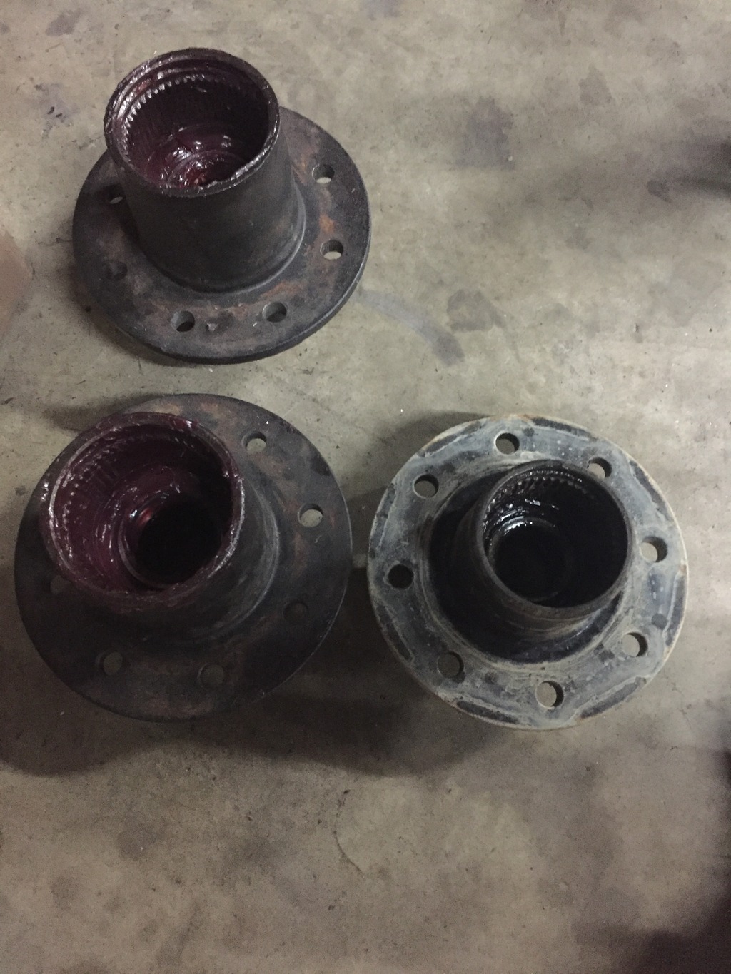

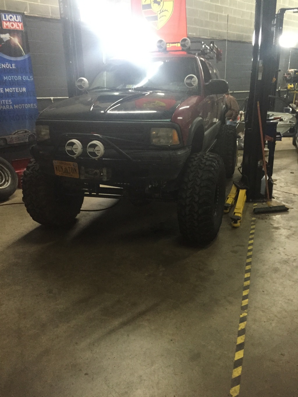

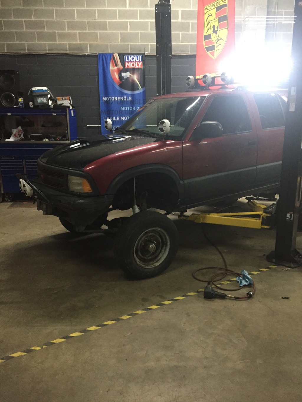

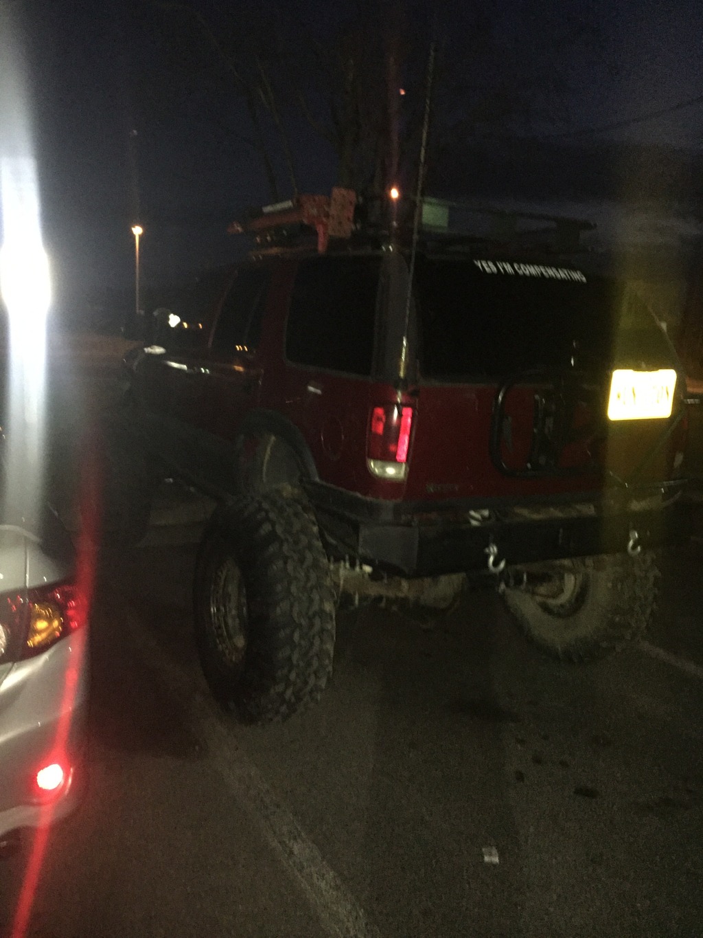

Well it's official I am officially on tons!! I pulled into the shop about 2:15 this afternoon and drove it out at 5:30. I ended up pulling the rotors off my 44 and swapping them to the 60 since my buddy still hasn't had time to cut the other ones. I've got all matching studs at all for wheels which is really nice. My tie rod ends are shot so I just put them on enough to move it out of the shop and I have some ruff stuff 3/4" heims ordered so I'll swap all that out when they get here. I've still got allot to do but I'm stoked to finally have a 60 up front. I also have to order a new u joint for my front shaft cause I learned yesterday that the yoke on the 60 is a 1350 yoke.
Back on its own weight got he first time
Back on the 40s
And outside to prove it moves lol!
It's crazy how much bigger things are on the 60 compared to the 44. Look at the difference in the hubs
