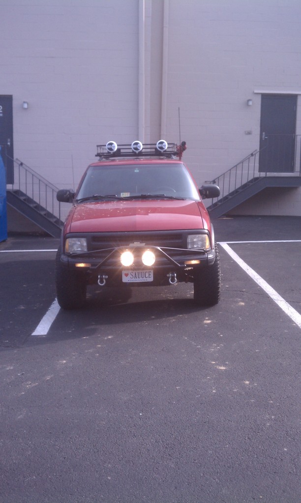

I got the two center lights properly wired up all purty like today and pulled the fuse on the the DRL's. I wired them to come on when I turn the truck on but I also threw a switch in there so that I can turn them off if I so choose.

I want to wire up the roof lights but I am going to wait till spring cause that is going to be a big project. I was going to reuse the wire I already had but it was only like 14-16 gauge and wasn't really sufficient for the three lights so I'm going to run 10 gauge up there this time. I'm also going to pull the factory roof rack off and put a proper grommet under it to run the wire through to the roof with disconnects right there so I can remove the Surco rack and lights by just unpluging the lights rather than having to cut wires. While I have that all apart I am also going to pull my sagging headliner down and use some longer bolts with steel "straps" on the inside of the cab and reinforce the roof rack rails so that they are a little sturdier. I already have one of the bolts that the tack weld on the nut came loose so its not holding much and another that is about to go so I'm gonna fix that. And then I'm going to redo the headliner so its not saggy anymore.
