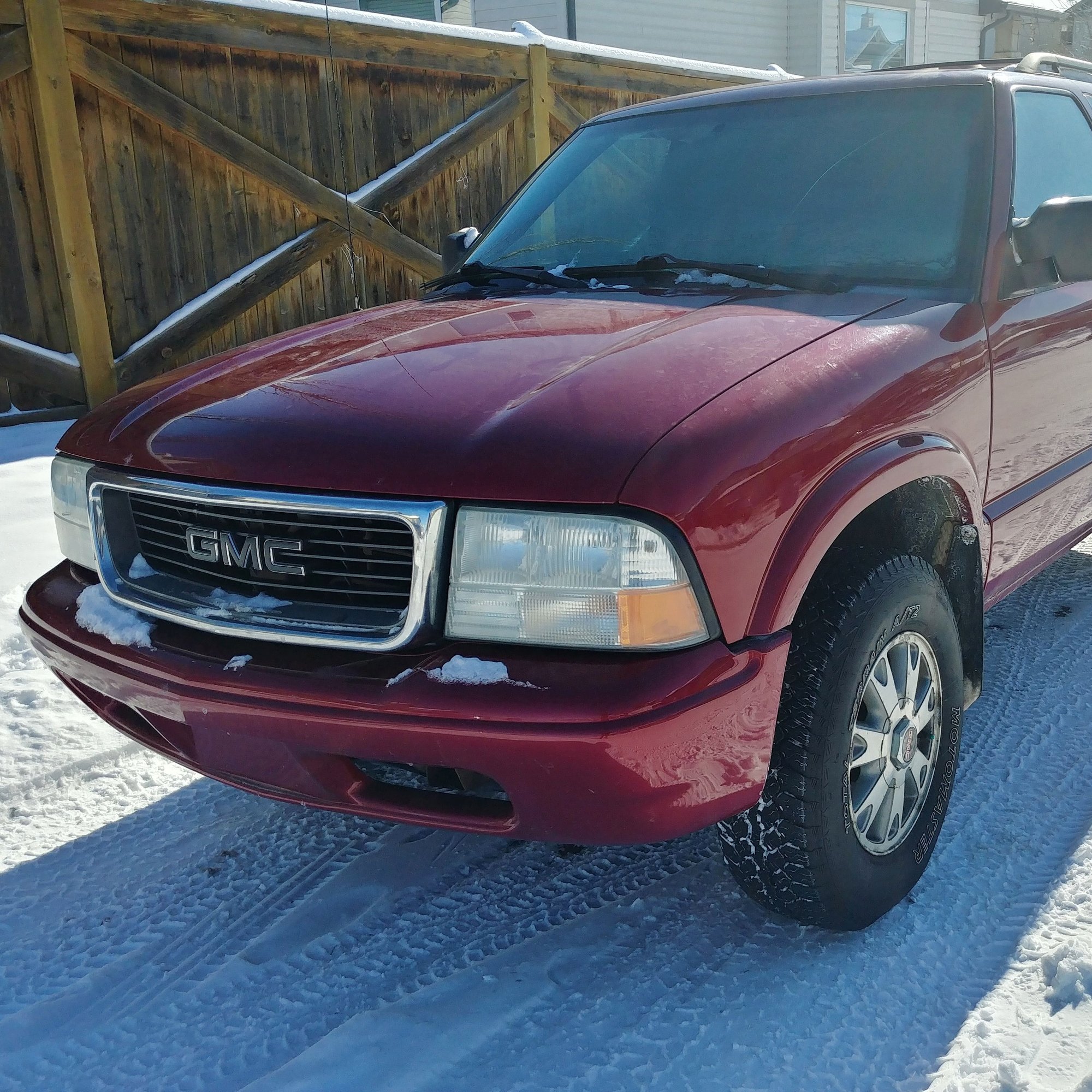

Badges removed and front gmc logo blacked out. Already put in new spark plugs, distributor cap, rotor and also new ball joints
Rims are getting sand blasted, and painted black

Looks good... what plans do you have for her?

DonL, thanks, the plan at the moment, is to get the rims painted black.
and when the time comes i will hopefully be getting some bf goodrich ko2 tires.
i am also going to be getting a new gibson cat back exhaust in summer,
any suggestions of things to do or look over?
Old Apr 9, 2019 | 08:46 AM
Depending on mileage, keep an eye on your antifreeze level. The lower intake manifold gasket tend do go, time consuming job but not the hardest. Hubs and steering components, if you spend more time on pavement you should be good. A lot of blazer get "back end sag", new leaf springs/add a leaf kit/lift shackles will solve this. Try not to adjust your front ride height with the torsion keys, you will cause more wear on parts...
I for one would look into hub centric spaces for the rear, 1.25"-1.5", a lot of people(including myself) have noticed better handling, and you have a few saying they are not recommended.
If you do want to do some light offroading with a little more clearance, the rough country 2.5" lift is good, or a body lift will accomplish the same.
Skid plates is a must as well for offroading, look for aluminum ones, but if carbon fiber ones are all you can find, it's better then nothing.
Old Apr 9, 2019 | 08:59 AM
Kylegloer's Avatar
Joined: Dec 2018
Posts: 4
Kylegloer is on a distinguished road
DonL, thanks for the suggestions man, i would love to do that 2.5 inch lift soon, i live in canada woth lots of snow and i think that would really help out.
and the issue with the rear offset will be fixed with the new rims, i got 2 with a deeper offset to help push out the wheels just alittle bit, and the other 2 rims are the normal offset
