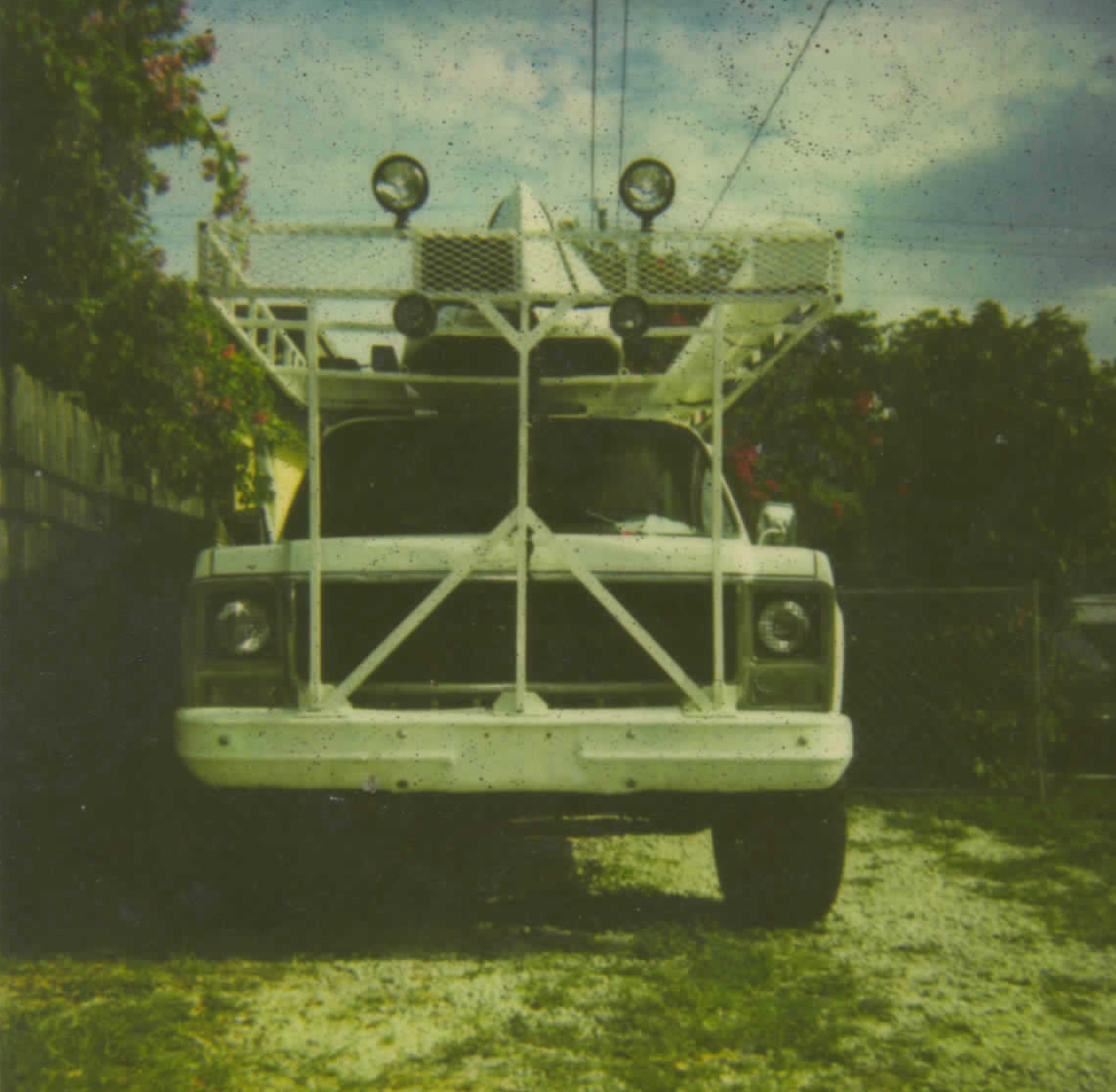

First mod: roof rack.
I found a plumbing roof rack with a basket front, rails above the deck and stakes at the rear. This was a direct "bolt-on" with bumper included from a Chevy pick up at a local salvager yard. Next stop – Steel. Plenty of heavy duty screen to keep the fiberglass roof from any serious injuries from firewood, lawn mower and whatever nasty things we did not want inside. We could not figure out how to secure the back of the rack so we ran some large square tubing down to a huge round steel pipe that my friend acquired. They weren’t giving out awards for neatness or the good use of fasteners back then so we just welded everything with no thoughts to protecting the glass or paint from the heat and sparks.
Second mod: Lighting
Since my friend had a habit of always being late we often did not get out there until after 9PM on a Friday. We had to set up camp before making dinner so it was hurry hurry hurry every other Friday. The OE headlight were just not enough to “read ahead” very well. It wasn’t the thought of hitting something at 70 mph that concerned me. It was the possibility of running over a slippery gator – or even a slippery turtle. The total width of driving area was 12-15' before dropping off. Enter the KC Dayliters! I bought a pair of the brightest lamps available at the time 250000 candle power (I think). First I mounted them just behind the windshield on a cross member. I really could see over 2 miles away. Unfortunately The roof rack and my white hood were illuminated so much that it created a “feedback” effect inside the cab, It was like trying to drive while your passenger is using a handheld spotlight to read a map. I moved the lamps 16” back to put the hood in the shadow of the KCs. The feedback issue was reduced but not fixed. Finally I put them on the very nose of the rack. Incredible light with no feedback. Daytime ahead and only darkness behind! The draw from the switched 12v was too much; so we added a bigger alternator and switched power directly from the battery via a heavy duty Ford Starter solenoid.
