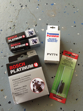

Been having issues with the Jimmy starting up lately. For awhile it would take a while to crank before it actually started. Then while driving, it felt underpowered. Also, gas mileage was horrible...about 8mpg!
In the last couple weeks, Jimmy would not start at all. Figured the first thing I could do was check the spark plugs. After checking two and seeing they were black, I decided to try replacing them. Went with some
Bosch Platinum 4's Bosch Platinum 4's
. Also noticed the PCV valve grommet was torn and open, so decided to replace that as well.
After changing the plugs and replacing the grommet, Jimmy lives!

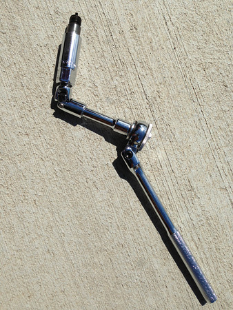

Also, this combo of tools helped tremendously in changing the plugs out. Picked up the "Toolworks Tune Up Set" from Advance Auto Parts for $12.
