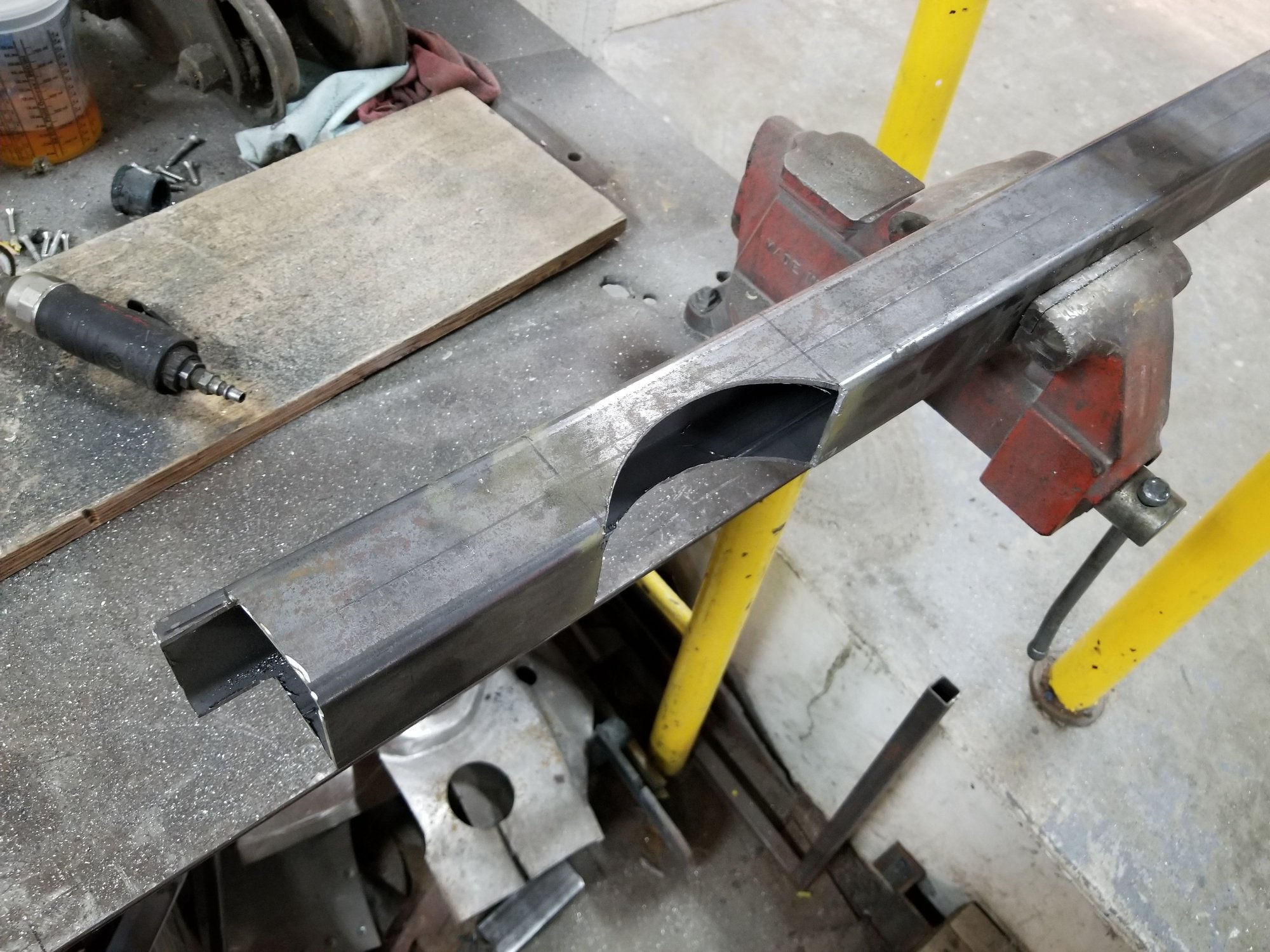

Alright, so I finally started building my new tranny crossmember after I broke the last one when my driveshafts let loose at mountain madness a couple months back.
Here's a pic of the broken old one
Got the square tube cut to fit between the framerails, and notched around the front drive shaft CV joint

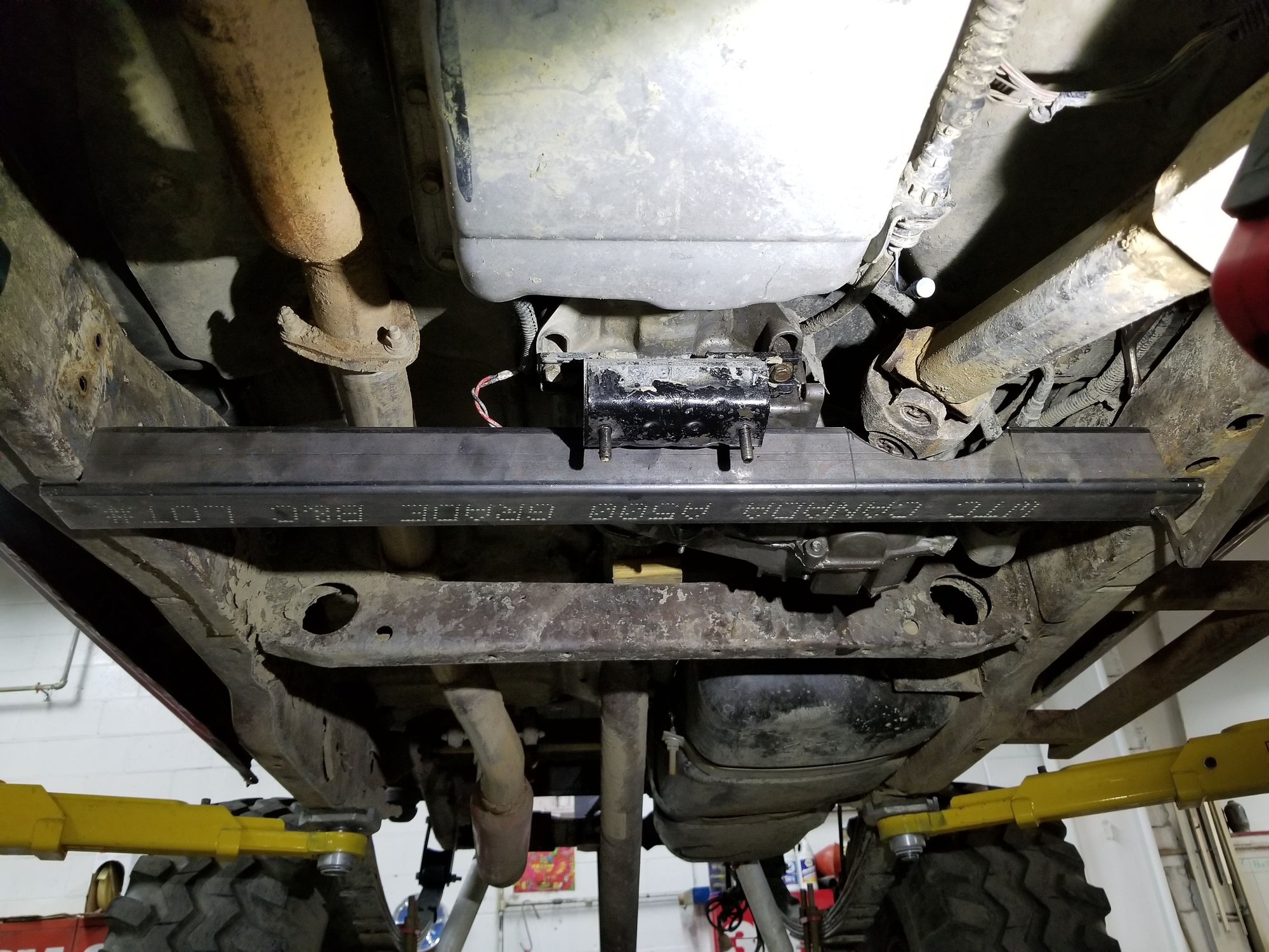

Mocked up
Now I have to make the cradle for the tranny mount, and weld the plate that will actually mount the crossmember to the frame.

I've been plugging along on the tranny crossmember, still not done, but it's getting there.
I got the driver side bracket formed, the nut welded on the inside, and welded to the crossmember.
I welded a angle iron rib inside the cv notch, to strengthen it since it's so thin there.
Then I plated over it

Almost got the tranny crossmember all done.
Just have to gusset the plate that the mount bolts to.
Got all the holes set and drilled for it to mount to the frame.
Also gotta weld a piece of sheet metal over that opening on the side, just so mud and dirt can't get in the crossmember.
