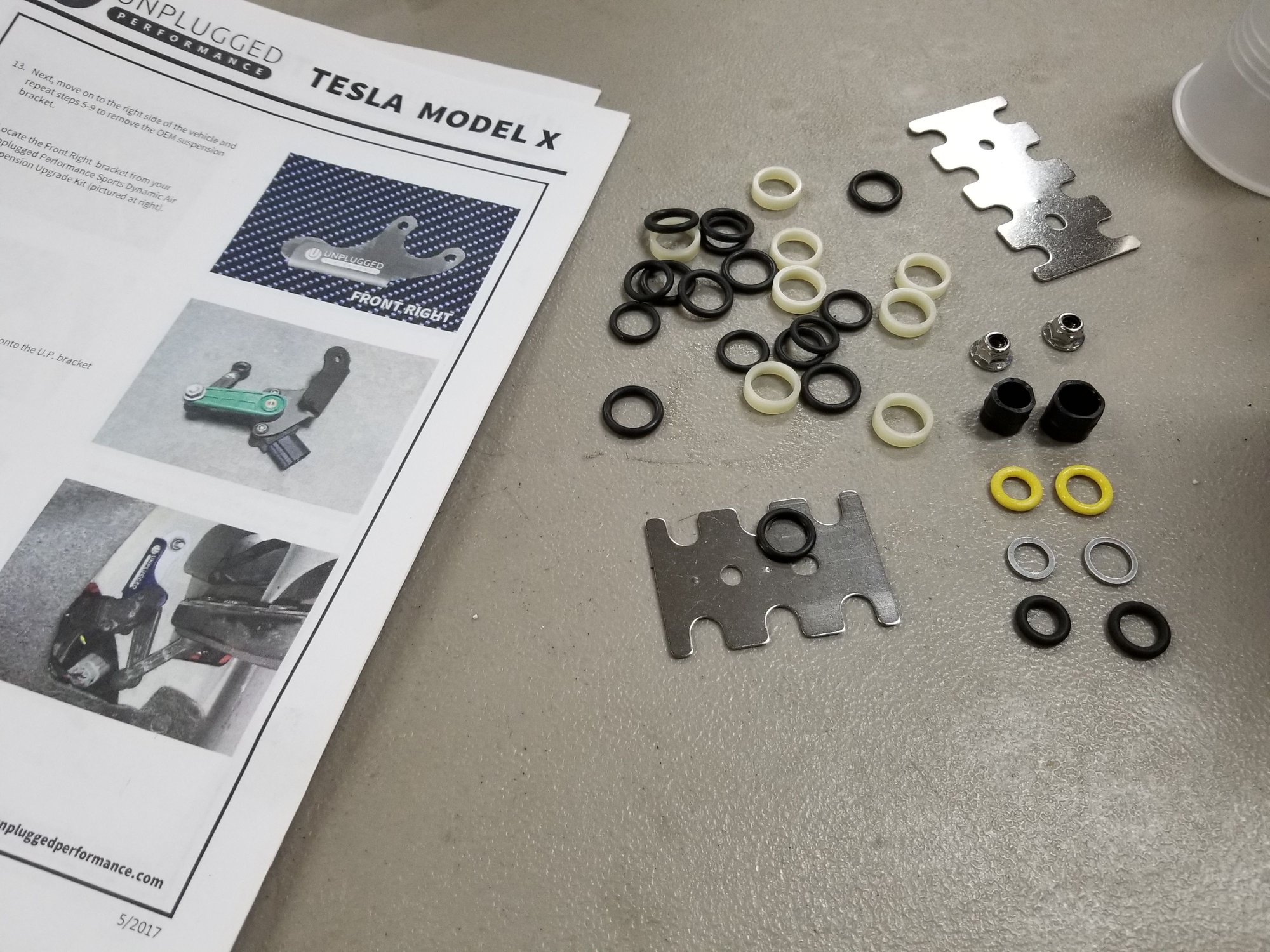

Had some fun with fuel lines today
Got the new seals in, and it didn't fix my fuel pressure/ leakdown issue. Looks like the problem is in my injector assembly itself somewhere...I peeked in thru the port that feeds the vacuumn booster and saw a bit of raw fuel in there- so that kind of confirms it for me. I'll have to pull the upper intake off to figure out exactly where the leak is. Hopefully it will be something repairable because I'd rather not spend the 250 bucks to replace it.
