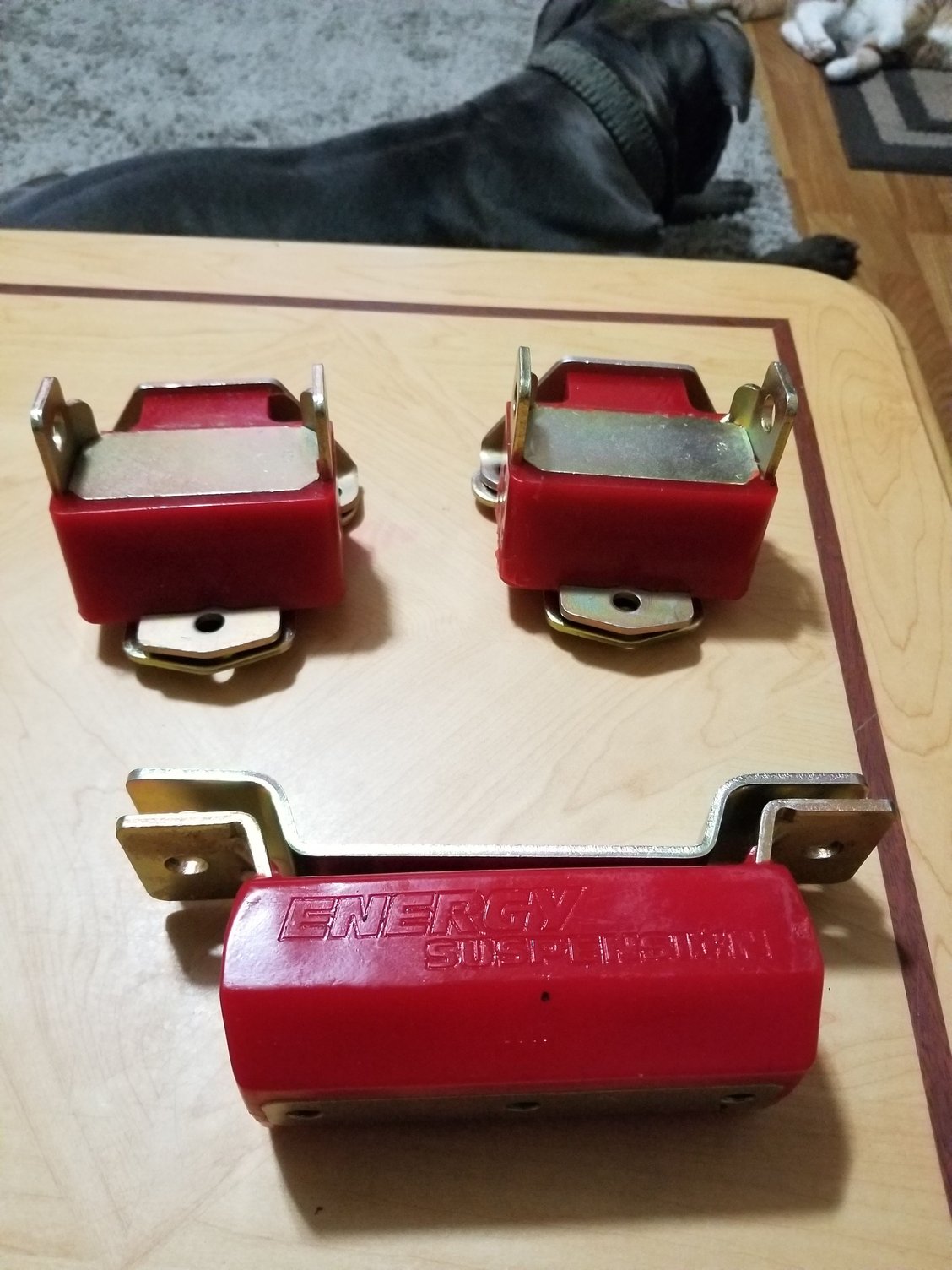

Well, at the off road event a couple weeks ago the Transfercase held up well. I blew a wheel cylinder going down the side of the mountain, so but was able to get it turned around and back to camp without brakes.
Did both new rear wheel cylinders and brake shoes and springs in the field and got it going again.... only to have both engine mounts and tranny mount let loose on me... right around this time:
after some research I found out the factory style mounts are problematic for everyone running more power or bigger tires/lockers on s-series trucks. Solutions were chaining the factory mounts so they couldn't pull apart, or running polyurethane mounts. I chose to get these mounts from energy suspensions because they have internal hoops to protect the mounts from pulling apart, so they're even more reliable than regular poly mounts, and I shouldn't have to worry about chaining them.
