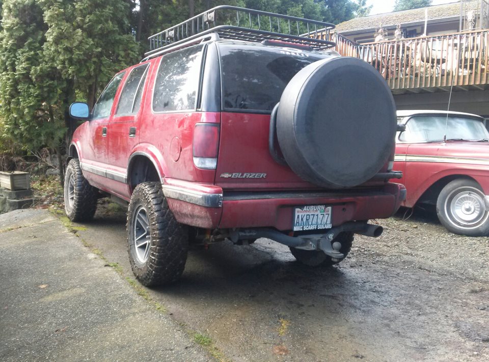

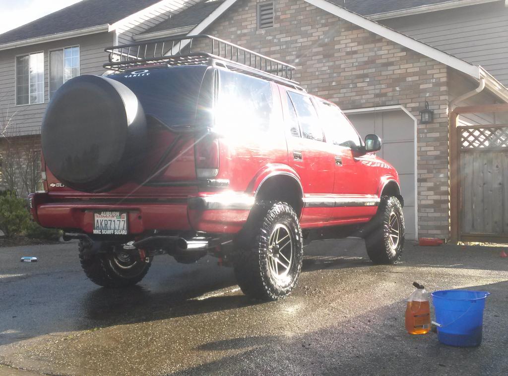

So i have been holding out on you guys... Over the weekend i was walking through pick in pull and saw new looking Chevy 63's on a Silverado and got a wild hair then decided to get them and make a bastard pack with mine because my truck was starting to sag bad.
So i took the second longest leaf from the 63's and cut some off to go under my longest leaf almost to the ends to support it all, then under that i put my second longest leaf then under that i put the third longest leaf out of the 63's which i had to cut some off of both ends to fit. And i removed my overload spring because it did nothing. so now instead of having 3 leafs each side supporting me i have 4 with two new ones and boy did it make a HUGE difference.
I measured my fender lip height from the ground before and it was 34" both sides then after the new pack they are at 38" off the ground. so that gave me 4" of lift! and i cranked the torsion bars about 1.5" and the back now sits about an inch higher than the front which i like.

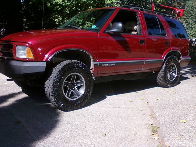

So here is a before picture
After but before a wash lol
Washed
heres the only picture of the leafs i have
Over all im extremely happy with how it turned out, i think the flex in the back is perfect. Those leafs support my truck really well but are still super soft. My truck doesnt float all over the road when i hit a bump and now i actually sit above most cars

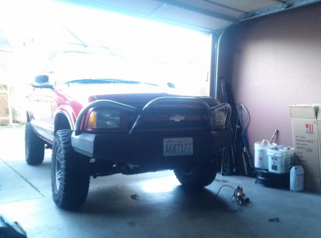

I also got started on the tube for my bumper.

Another update. Got the first side piece bent last night which was the hardest because we had to guess and check so much and there are 2 bends going in different directions. Idk how high up on the middle piece i want it to go, i still have room for adjusting but i kind of like how it is in the picture. i think it will look pretty bad *** when done!

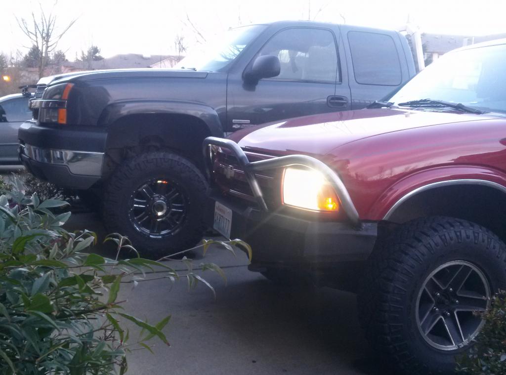

And the tube is done. Im really happy with how it looks tell me what you guys think! By the way that beast next to my truck is what my friend bought after we sold our Blazer..
