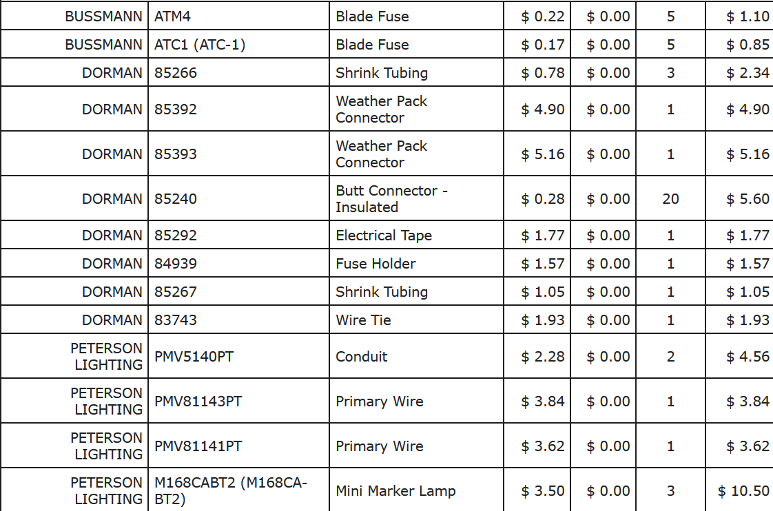

the fun stuff arrived
Grille Lights, first actual Modification im going to do
Spoiler
basic layout, top row of the grille for now, left and right ones will act with turn signals and running lights while the center im going to tap off the drivers side running light circuit for the lower housing. for the left and right im not sure how to power them for running lights, would need some sort of flasher on the circuit and a relay to trip it, and since these are LEDs i'd need a ballast also. anyone care to chime in? i might just be over thinking it.

re-thought out what i was going to do with the grille lights, i'll look at options for integrating a flasher later but for now im going to add an accessory fuse and relay panel under the hood, and use the running lights power feed as the control side for a relay to power the lights, and i will use a similar scheme for wiring accessory lights in the future since i plan on adding a good few more. have to order some good Delphi Weatherpack connectors since the Dorman ones i ordered are absolute hot garbage, dont know why i keep tricking myself thinking "this time it wont be garbage!" ..delphi ones are cheaper as well, just some assembly required.
