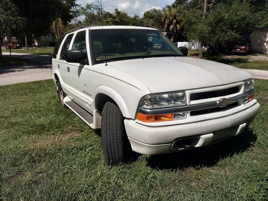

replaced the drivers info display in the overhead console, going to pull the old one apart and see if i can find the failure but for now it works, though its just displaying ~~ for all modes i think it just needs some drivetime/a few ignition cycles to recalibrate itself.
also got a more recent-ish picture.
