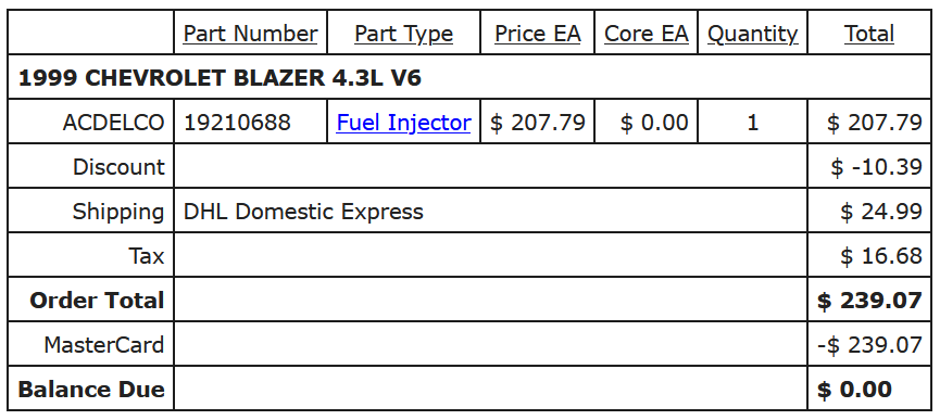

Found yet another leak, and a reason as to why not to buy DORMAN anymore, PCV L-boot split down the seamline, only a few hours of runtime since installing them... patched it with some 3/8th vinyl tube for right now until i can order a proper replacement. also have all of the parts for the vacuum system redo, and found washout on the intake runners around the #3 injector, so i guess that spider is my fuel pressure loss source.
