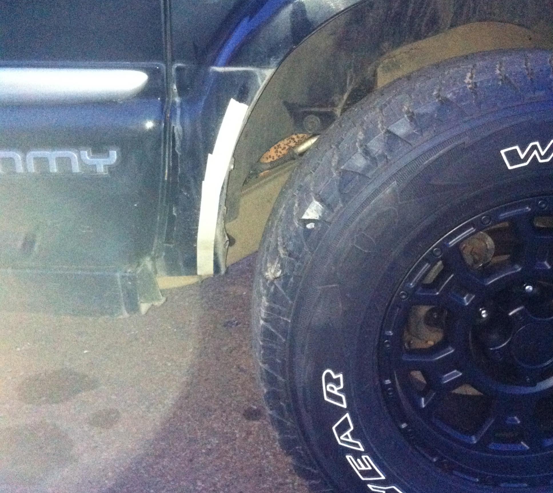

Secondly I am doing a terrible hack job on my body trying to make room for the tires.
So far i've upgraded from a 7 point turn to park to a 3 point turn. But the real genious idea I had was to just take off the tires to cut everything out!! so that will happen this weekend.
