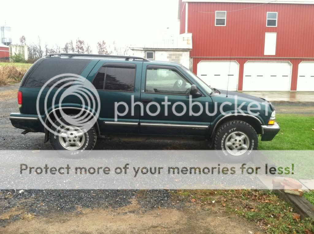

would i still be able to tuck 31's under the back? Right now im running stock 235/7515 but i really want to run 31x10.5 15 in the back and the front and I know I wont have a problem in the front because I'm getting fiberglass front fenders and hood similar to this s-10

31's should fit the rear with no lift (or very minimal lift) as an example i have 30's under mine with no lift (just a torsion bar crank on the front), Where you run into more problems with the 31's is in the front with no lift, they'll rub when you turn (but with the rough country lift up front you shouldn't have that problem)

i put a "3" inch lift on mine, which worked out to a 2 inch lift. by getting new keys and shackles on ebay, able to fit the 31 inch tires and they only rub on the frame when turning. just need to get new shocks or shock extensions depending on my budget and prob some spacers, then the ZR2 fender flares
