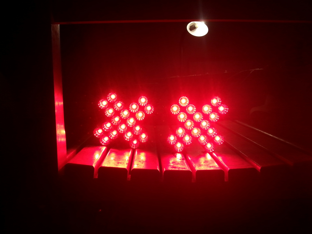

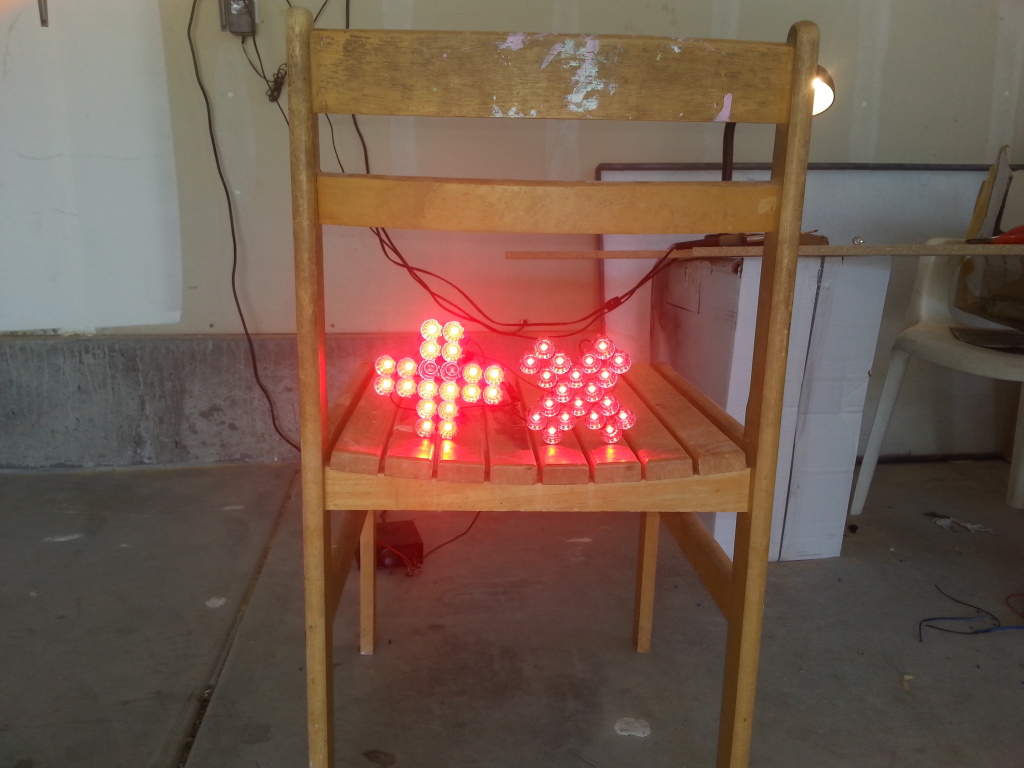

Decided to take another crack at it tonight. I tried checking voltages and continuities anything I could think of to figure out the problem, but really found nothing except that the one led that went out (which took out the other) was drawing over 3v somehow while the rest are all pulling 2.7 (just a hair higher than the manufacturers specification.) So I replaced it and the resistor (again) and it seems to have done the trick.
Sensing a change in my luck, I decided to do the second one as well. Thankfully the second one went together in about an hour (including de-soldering and re-soldering.)
And now pics.
Now I just need to actually install the pwm, open up the light housings put them in (which will be a pain as I found the inner reflector is actually smaller than the lens ) and wire it all up.

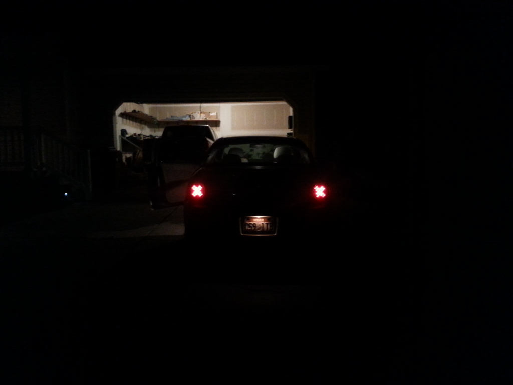

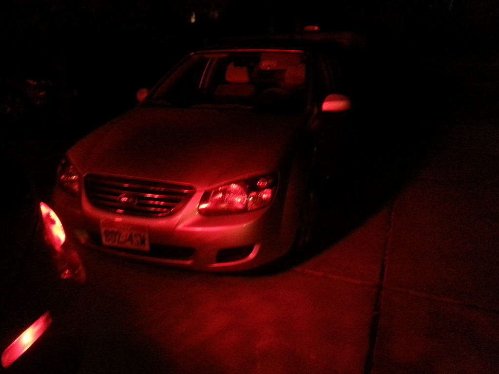

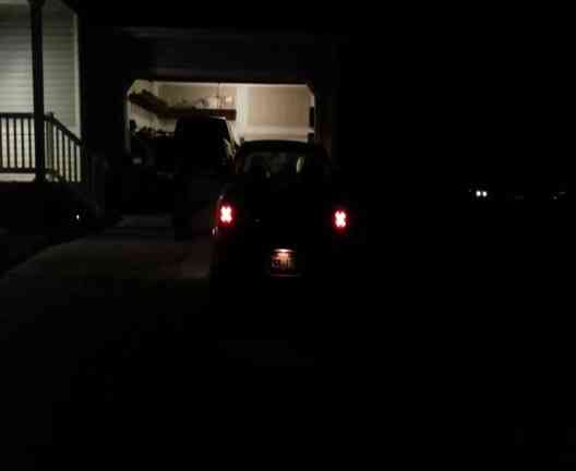

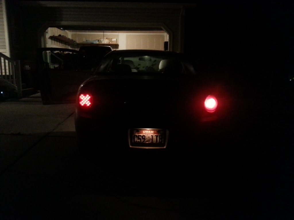

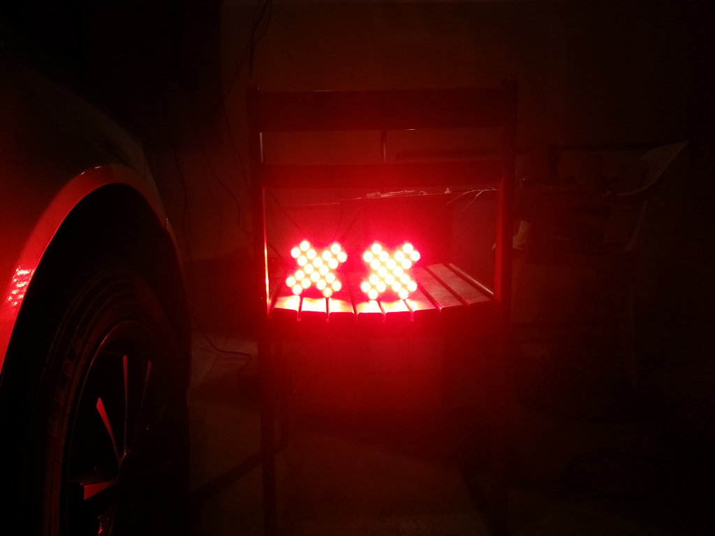

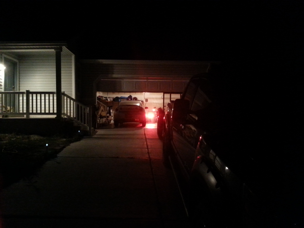

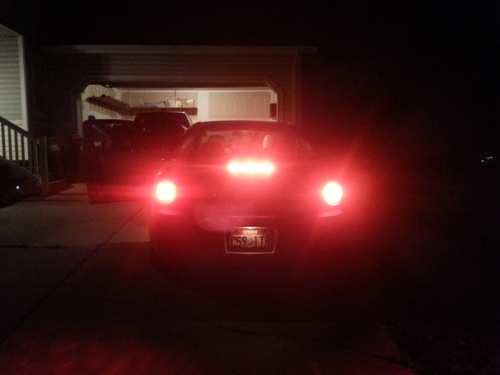

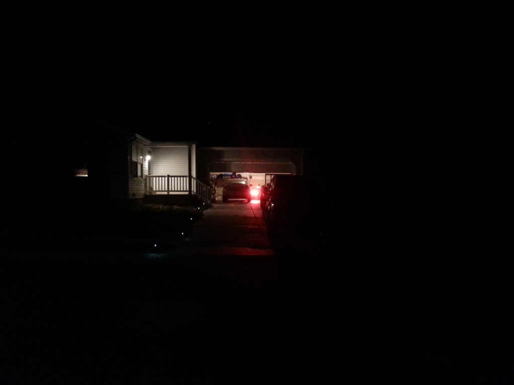

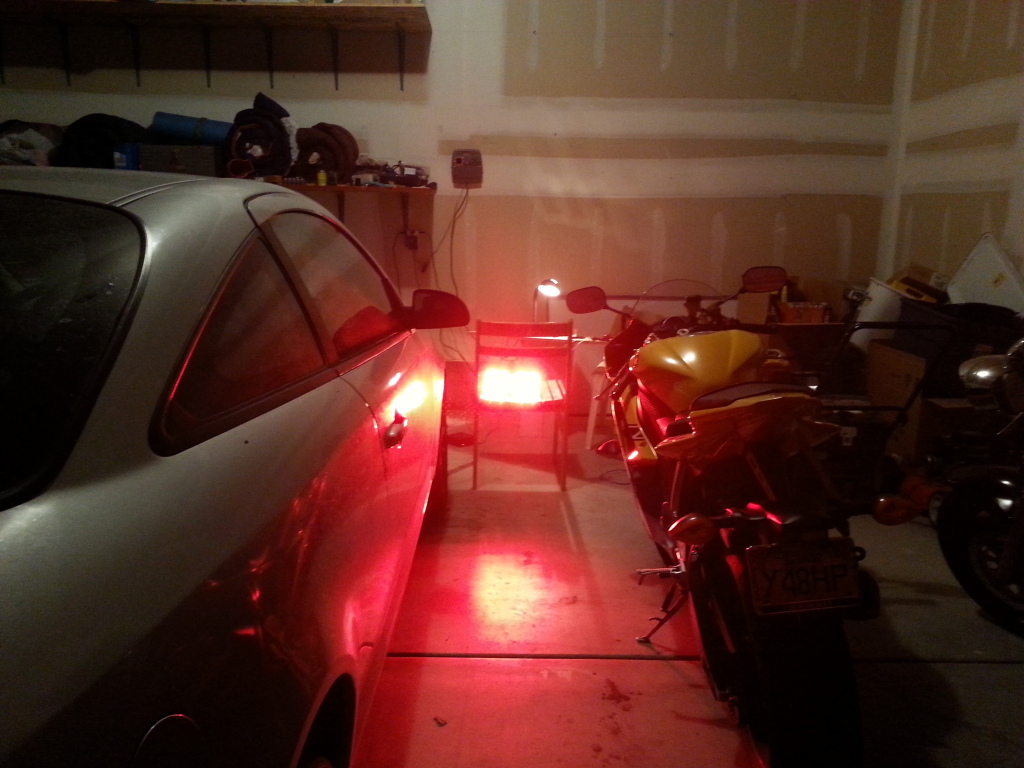

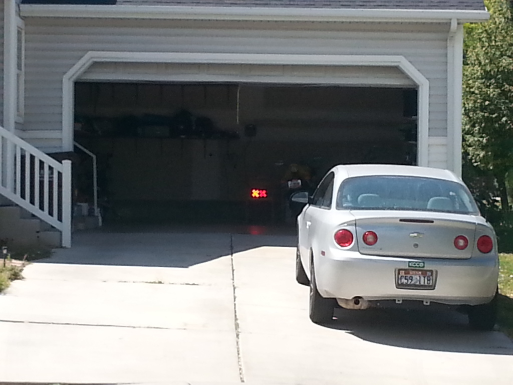

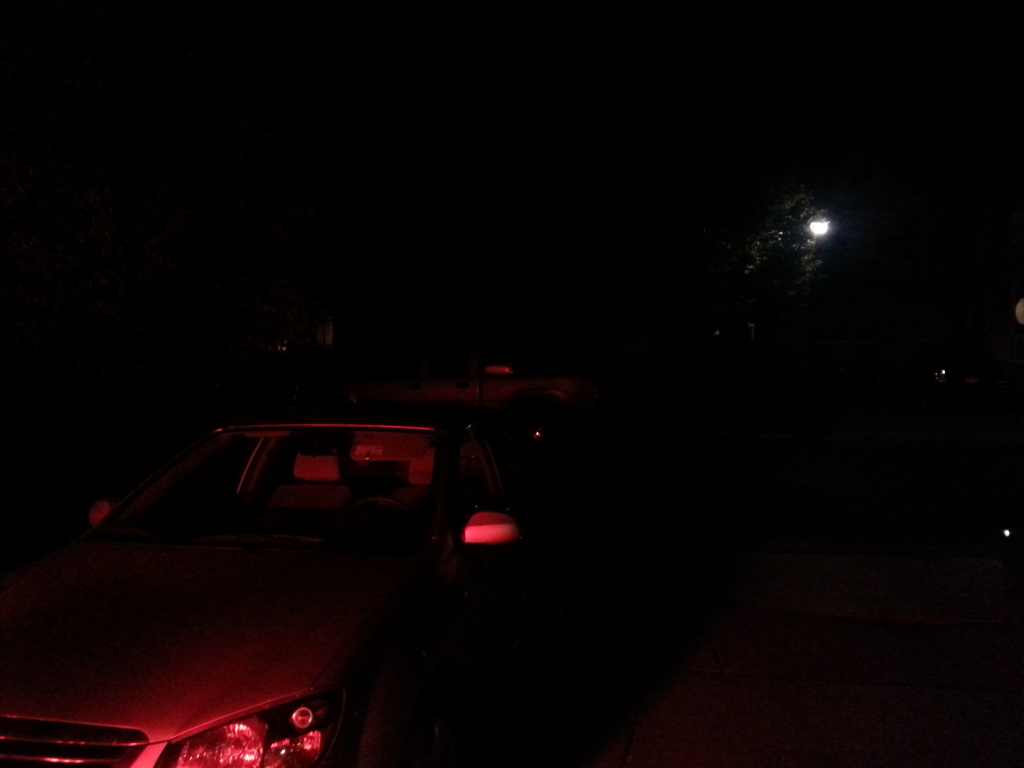

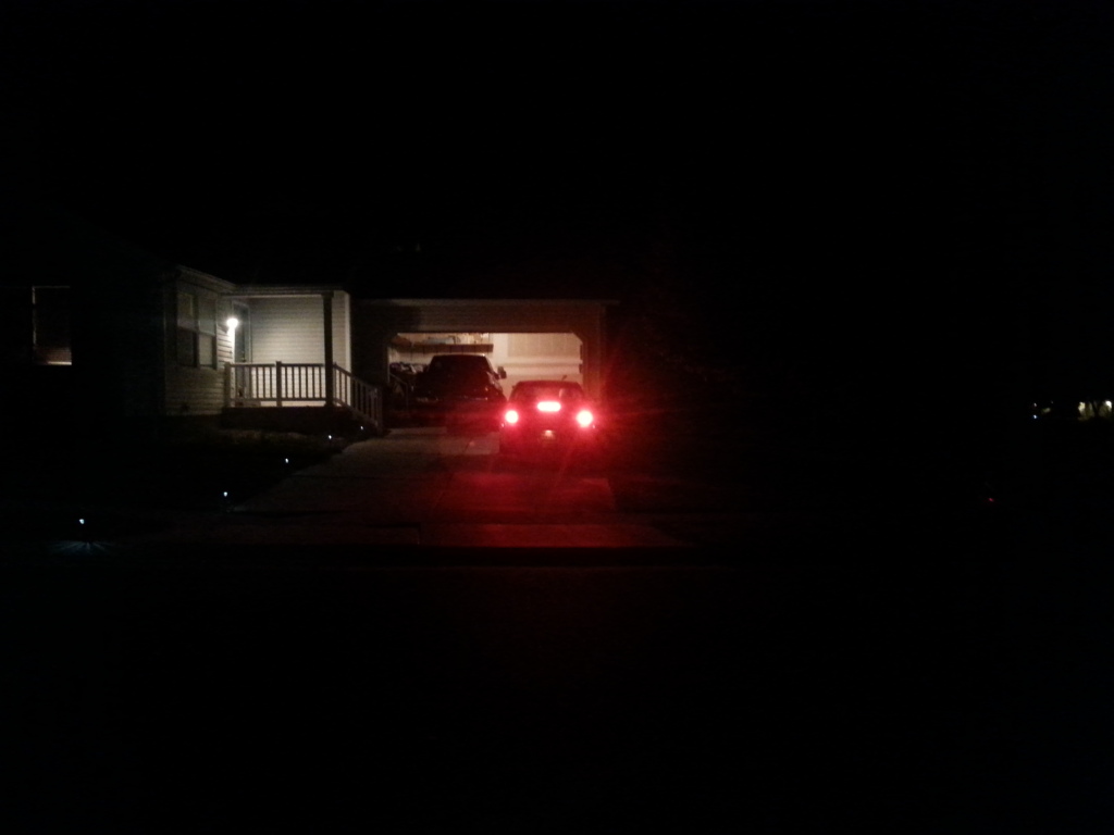

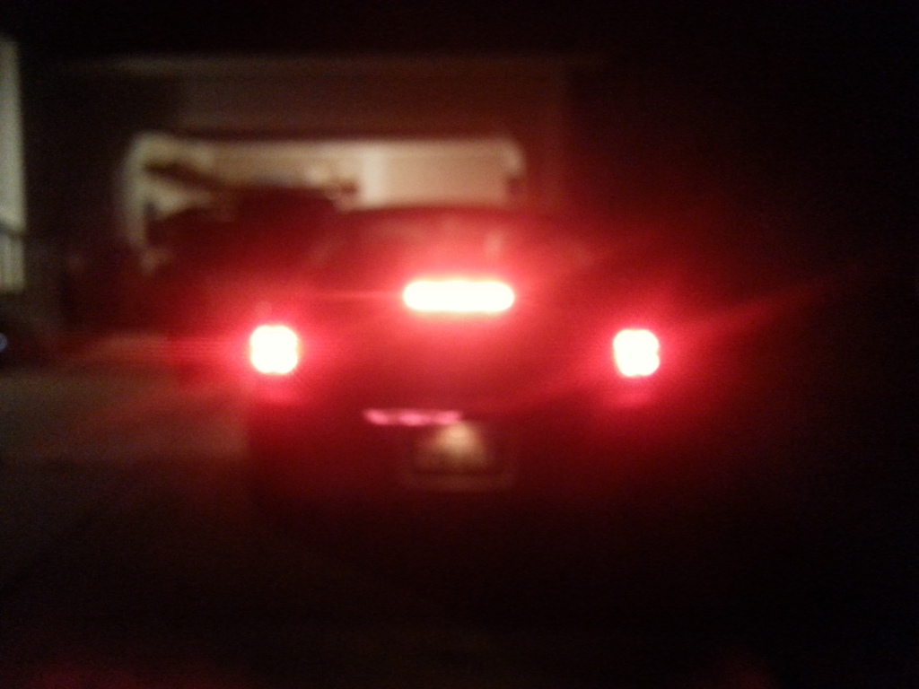

Well got them in the housings and temporarily mounted and wired up.
Here's one done with the other side still stock to compare brightness and look.
Parking lights.
Brake lights.
And here's a friends car parked behind when only one was done.
And a truck across the street.
And here they are both done.
Yes I noticed the one led out, but it came back on with a tap. Good thing I haven't actually sealed these up yet.

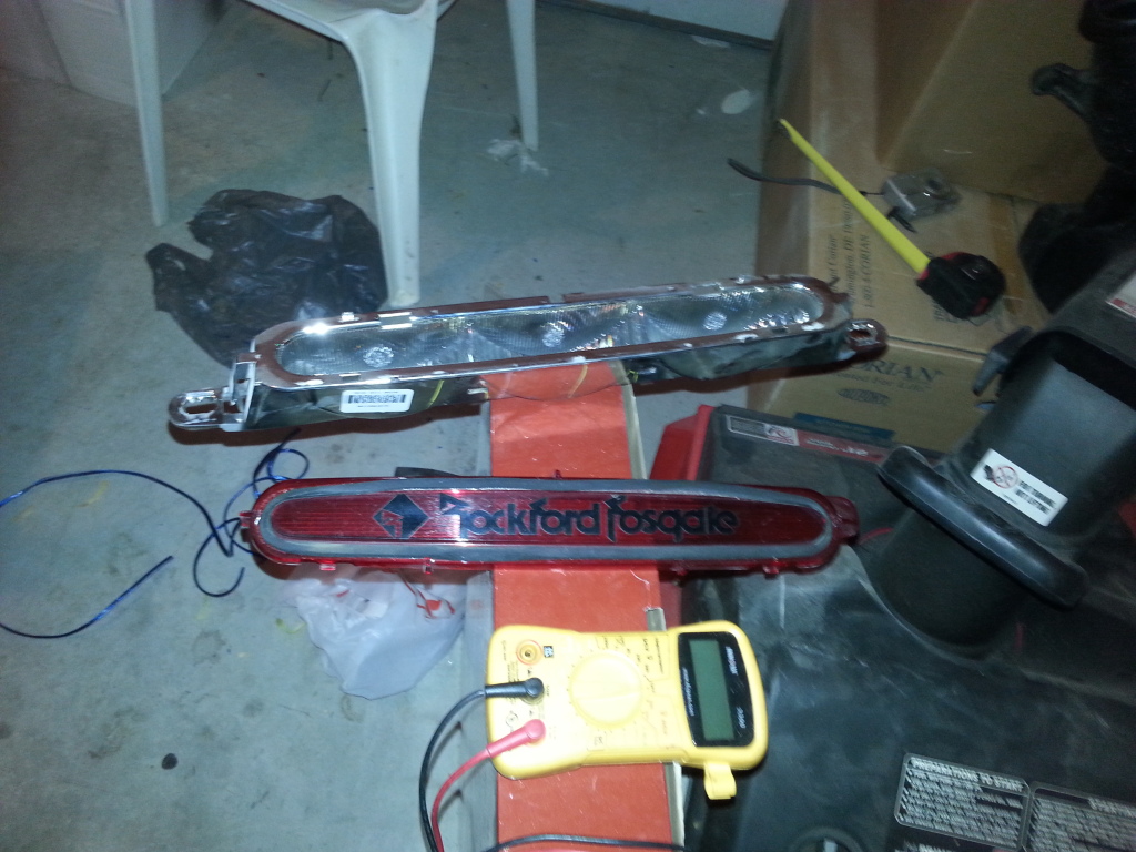

Yeah they are. I'll be ordering the reflectors for the 3rd brake light on friday, seeing as I still have about 75 of them left over.
