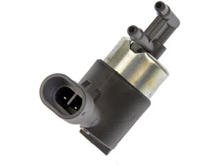

If that's the case, the switch on the transfer case is stuck and needs replacement. It's located on the driver side, inboard and slightly above the front output shaft. This is what the switch looks like: Dorman Help! 49315 - TRANSFER CASE SWITCH | O'Reilly Auto Parts

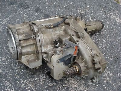

And this is where it's located:
You can use a 7/8" deep socket on a 3/8" drive ratchet to replace it. 15 minute job.
