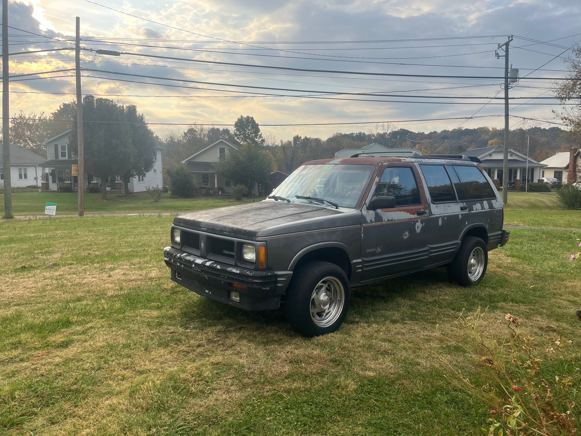

Need some help tracing down a problem for my old man, hes got a 91 bravada, it randomly stopped running, its got air and fuel, old man has gotten it apart enough to realize there’s no power going to the coil although the problem doesnt seem to be the coil itself.
edit: should be obvious but its a tbi 4.3 it has in it
