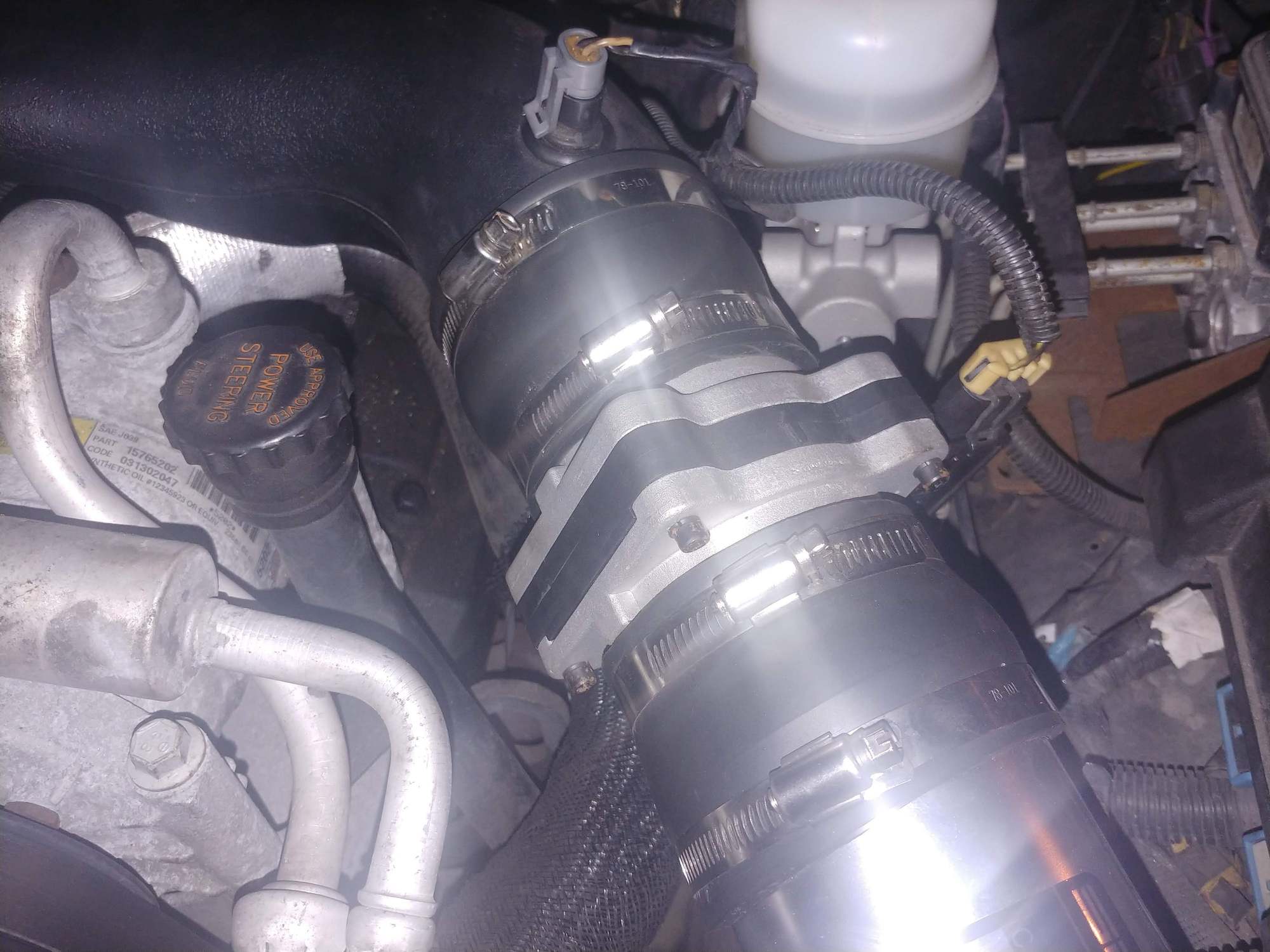

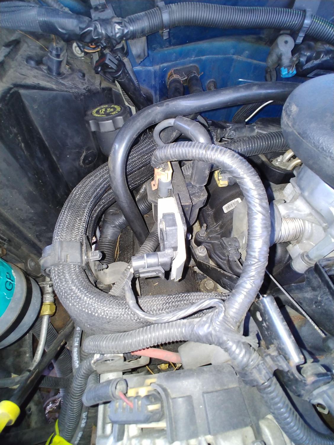

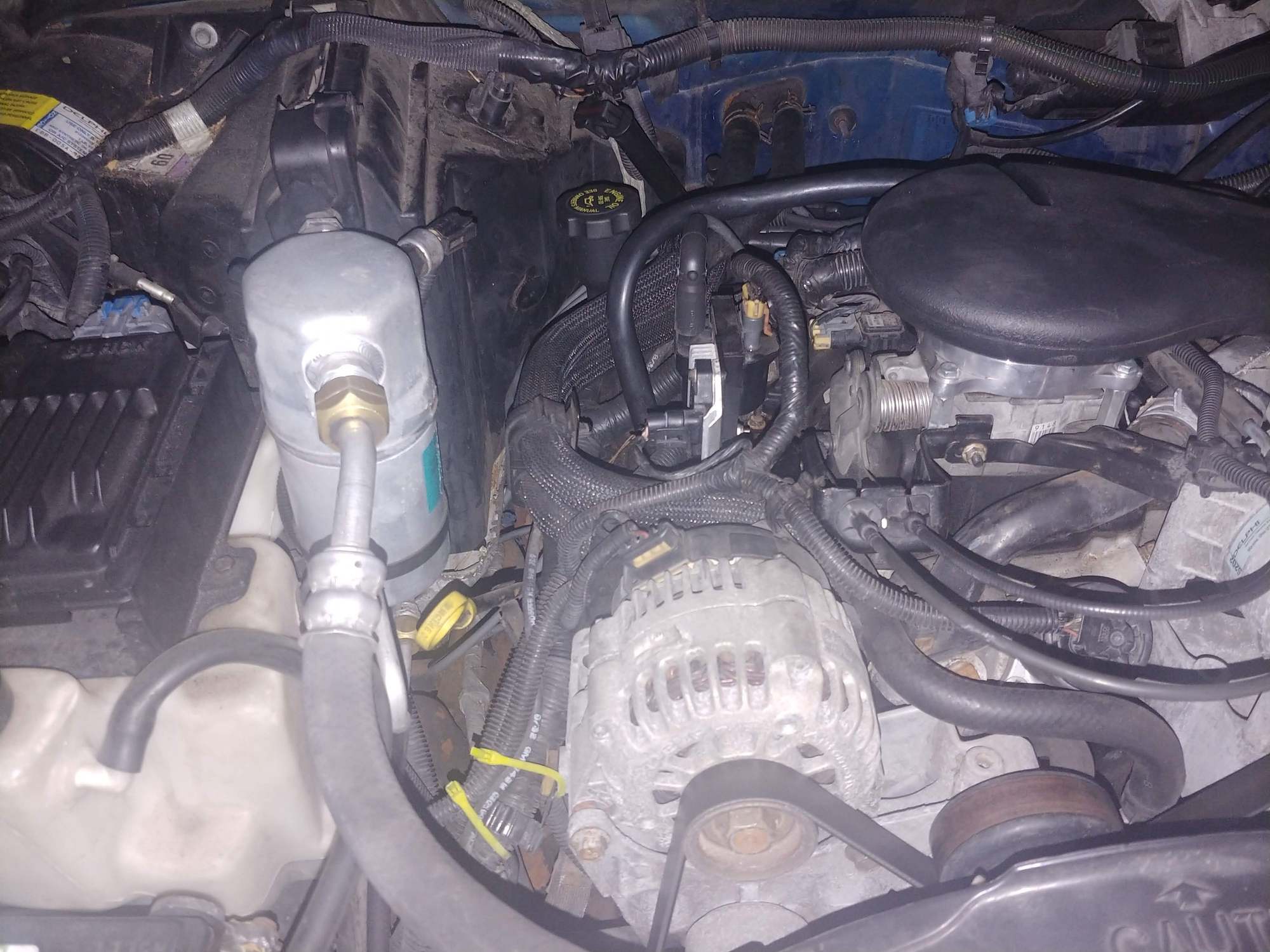

Over all, the truck was running fine and just one day, it started having power issues. I took it to a friend who has an advance OBD2 diagnostic computer who told me that it was saying too much air. I refuse to believe that a CAI could do that. I'm going to reinstall the old MAF and see if that has any effect. I've even checked to make sure that I didn't put it in backwards or something stupid. LOL. I've attached some pictures for reference. Thank you for all of your help.

Also make sure all the CAI connections after the MAF sensor, particularly the head. Mine came loose one time and acted the same as you are describing.

You say the MAF is brand new, but what brand is it? I've seen numerous accounts of these trucks not liking off-brand air flow meters and only running right with original equipment. Sometimes a 20 year old used OEM one from a junk yard works better than a brand new one off the shelf from a parts store that was made in China last year when it comes to these.
It'll run with it disconnected, it'll just go into open loop mode, get terrible gas mileage, hesitate and stutter on acceleration, and throw another code at the check engine light (open circuit).
Old May 17, 2020 | 03:26 AM
The MAF's have very specific calibrations. If the signal is off - your fuel delivery will be off.
The usual GIGO principle in computer systems. (Or any system for that.)
They are very sensitive and blazen_red_4x4 is right in pointing that out. Can cause all kinds of problems. If the MAF also has the IAT (intake air temp) sensor integrated another source of problems. These computers really need these two sensors do deliver proper information as most of the fuel is based on that input.

Or "The Hat." I went through that for months. Until I finally saw the light...
.... aaaand....
OP, Do you have a massive vacuum leak at the part of your CAI that replaced "The Hat" ? Mine was so bad I ended up putting the stock one back on, after becoming unwilling to buy the FULL kit (with the stand-off bolts) that cost a few hundred dollars. Just put the old one back on and it runs very very well, maybe a K&N will run better, okay, but I am not spending $400 on a brand new kit to find out...
It barely runs at all without that thing on TIGHT! Can make or break whole engine. Really one zcrew and proper fitting piece. How yours look..... ?
