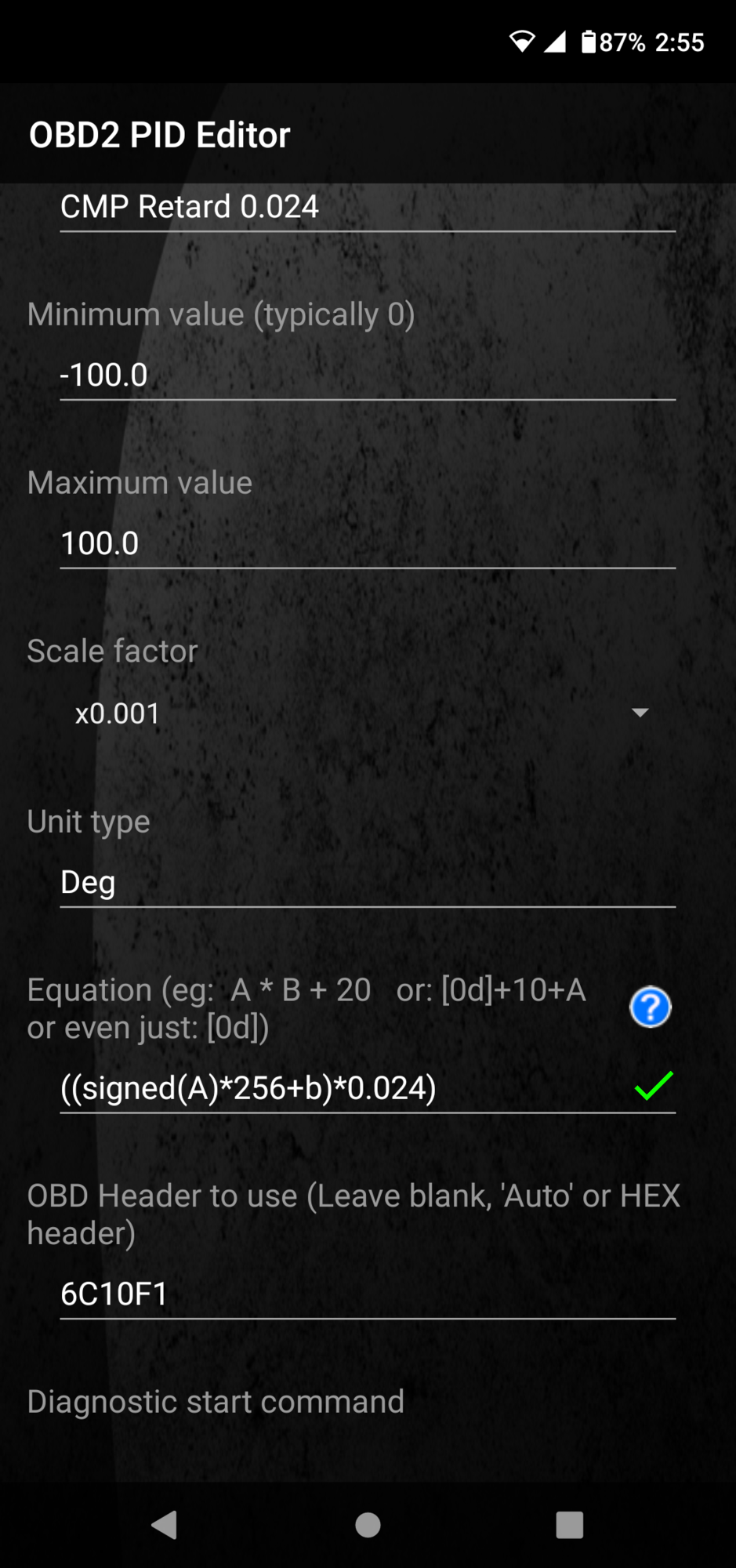

Originally Posted by LesMyer
Yes sir, got it all punched in correctly. It registers between 1.6 and 1.9 at 1500 rpm
What does spec 0 +/-2 degrees mean
Sorry just understood your request. Yes it drops to 1.2 when I rev above 1500 and let off
Excellent job!! Now you are done with that distributor!! The spec means that anywhere between -2.0 and +2.0 is just fine.
Now do a "Clear Faults on ECU".
then evaluate and report
Is SES light off?
is Security light off?
How does it run?
No security light or check eng
But p0300 comes and goes as i refresh the screen. Which is consistent with how it runs. It runs smooth but then it will start vibrating with a slight drop in rpm not on the gauge but the sound.
Im not concerned though. You fixed it.
