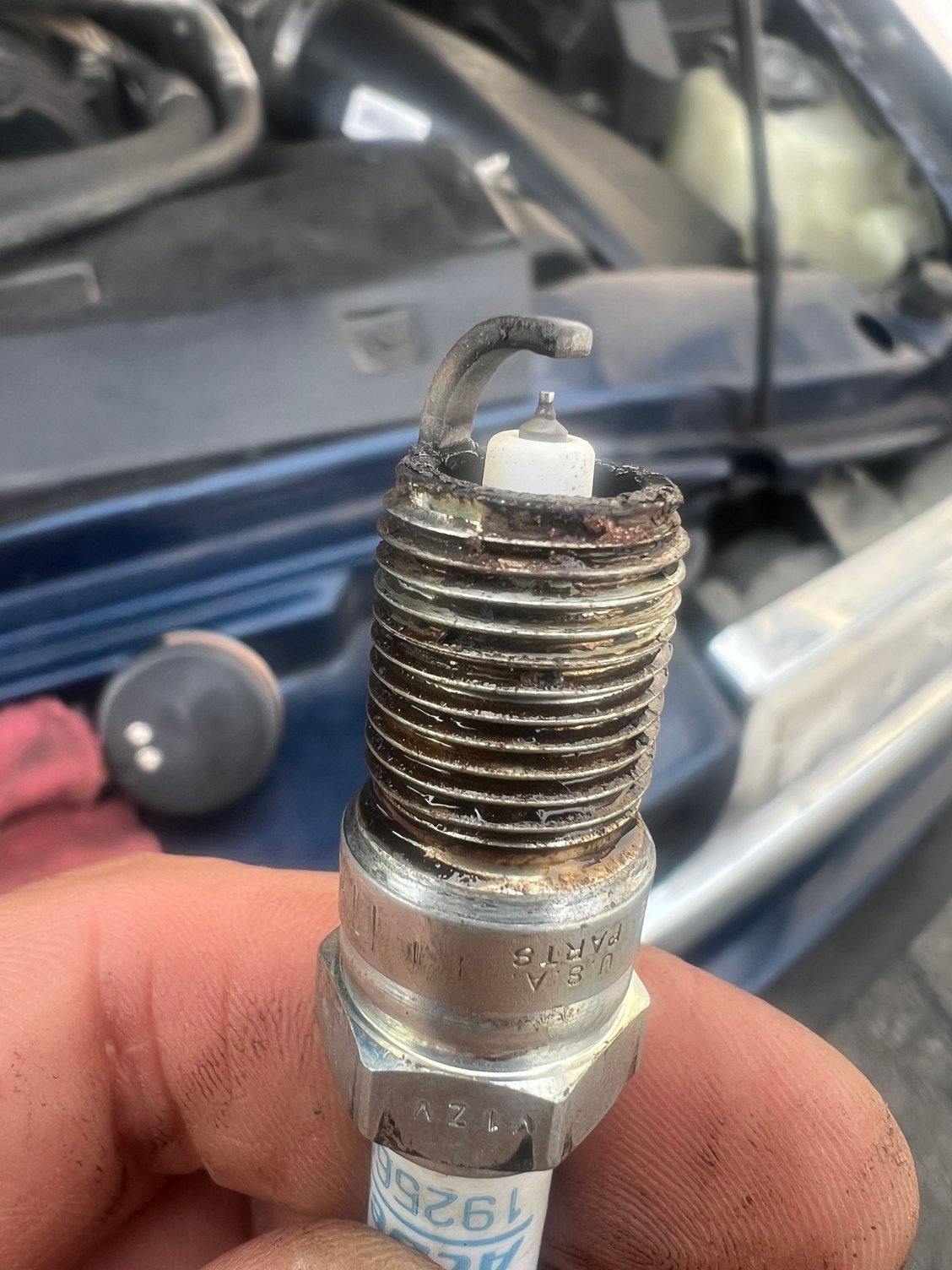

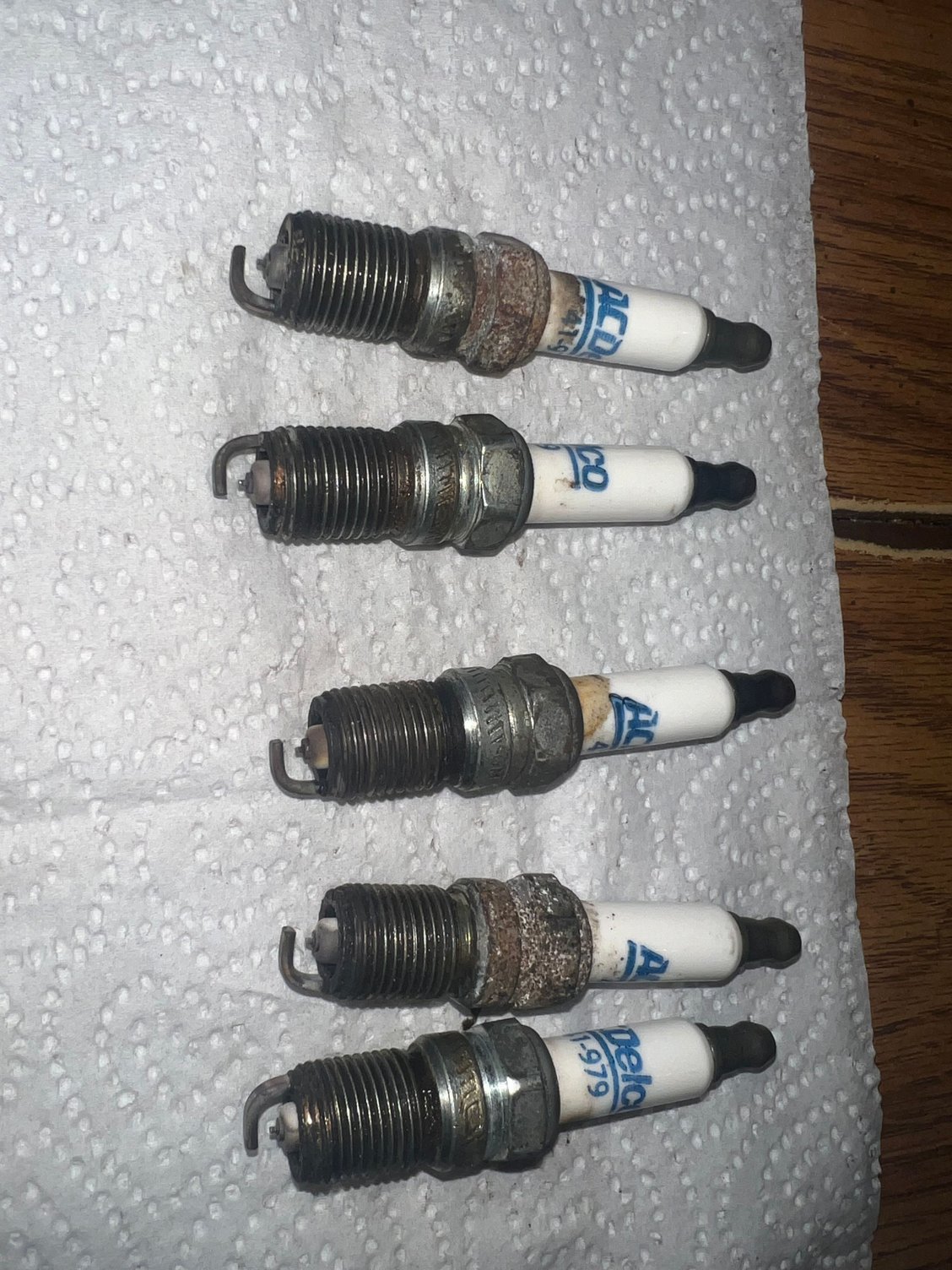

B) I did a compression test when it was warm and all the cylinders were like 2psi less than the previous cold test that I performed in which all the cylinders were 180-183 psi. Attached is a picture of one of the spark plugs from cylinder 1 and the other 5 remaining

B That’s a remarkable compression test result for an older engine. That said something dramatic is going on with cylinder one because that plug is so clean. Either it’s not fire correctly or there’s a problem with fuel delivery. Swap that plug with one of the other ones and see if it stays clean in the new hole. I would also look at the routing for spark plug cable number one. then check the spark on cylinder one and see if it’s strong and regular.. Do you have any carbon traces under that distr cap? If I had to guess I would say it’s fuel delivery and the injection on that cylinder.
