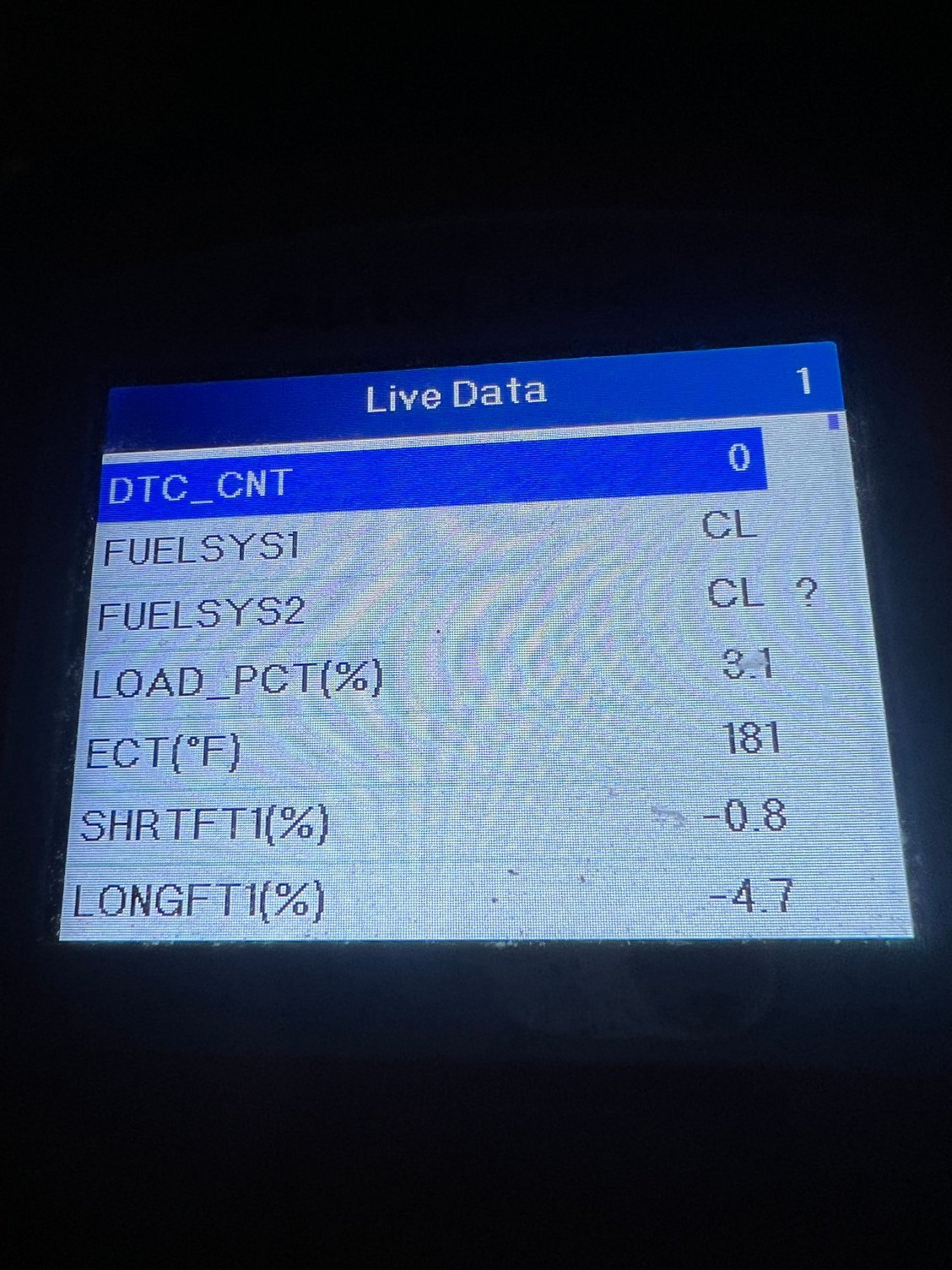

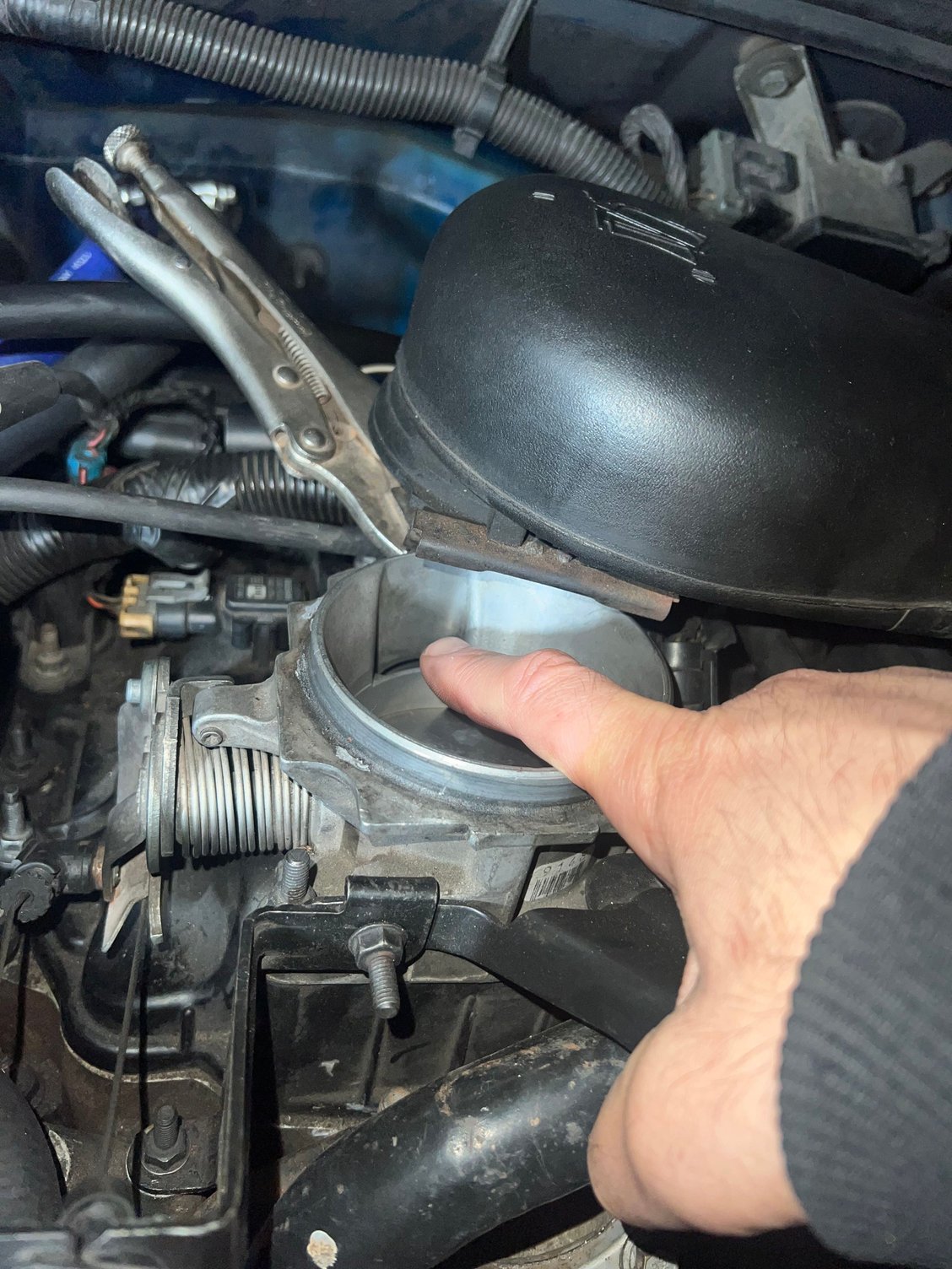

I took the snorkel off and smoked it again and it is coming directly out where my finger is pointing. I put the snorkel back on and smoked it some more. It is coming out underneath right at seal of the snorkel. Also here are the fuel trims at idle when warm, they are staying at around + or - 5%.

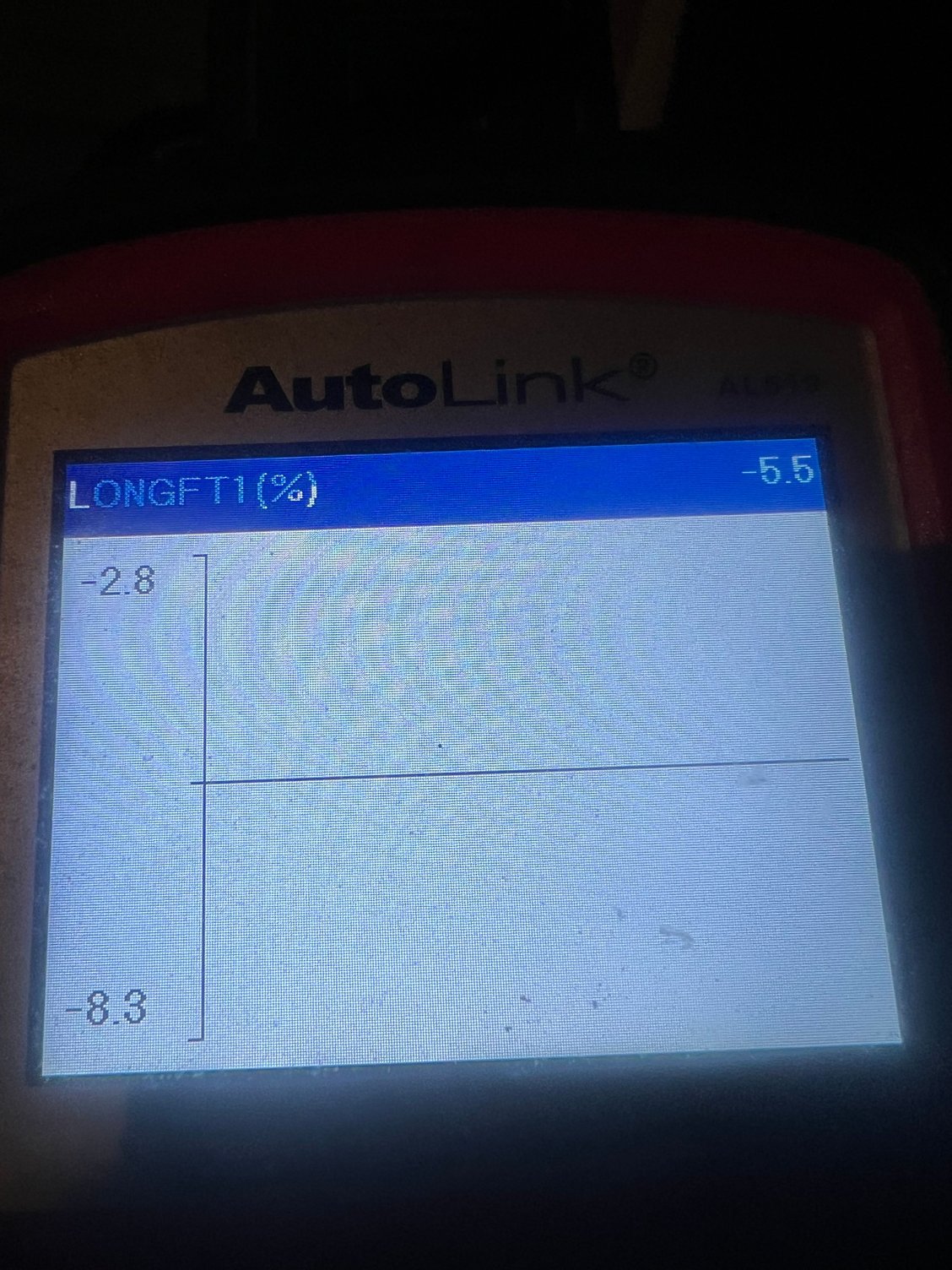

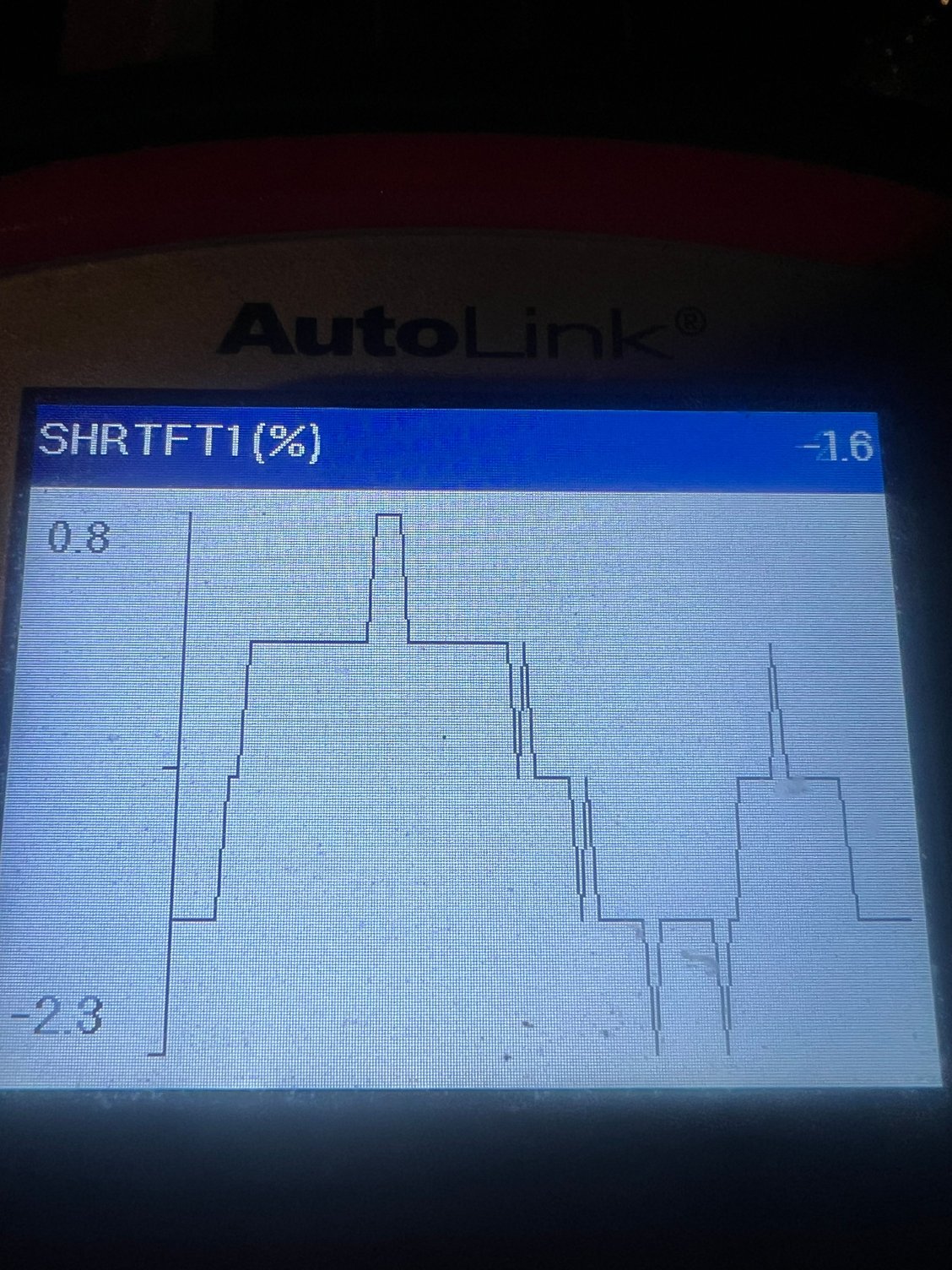

I am attaching graphs of the fuel trims at idle when engine warmed up
Those FT values are good but you only show bank 1. What does bank 2 look like? That snorkel seal leak will cause unmetered air to enter the intake but it must not be a significant leak because it would make the fuel trims go positive.

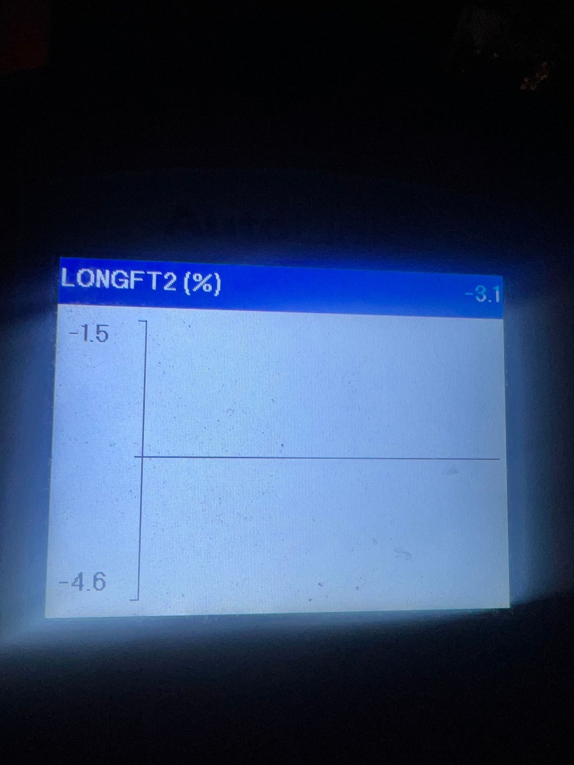

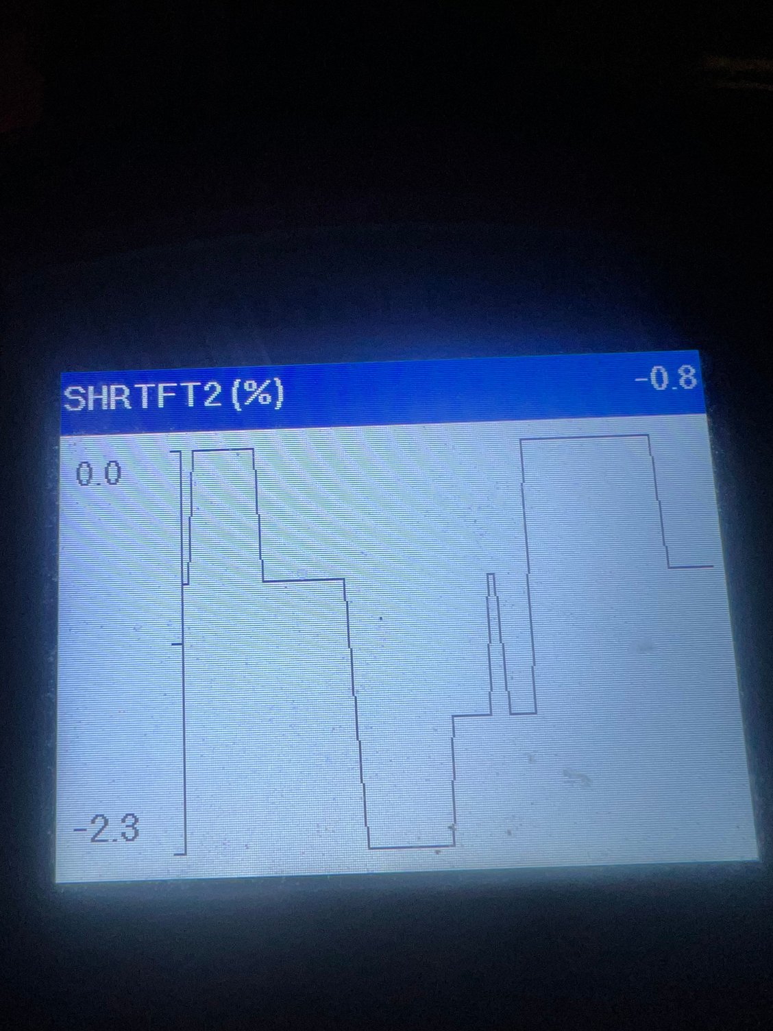

It must of not attached, here it is again
Old Nov 13, 2025 | 09:13 AM
  #35
GeorgeLG's Avatar
Posts: 4,659
From: Florida
Graphing has its place but on fuel trims we just need the values like the screen shot on bank 1.
George

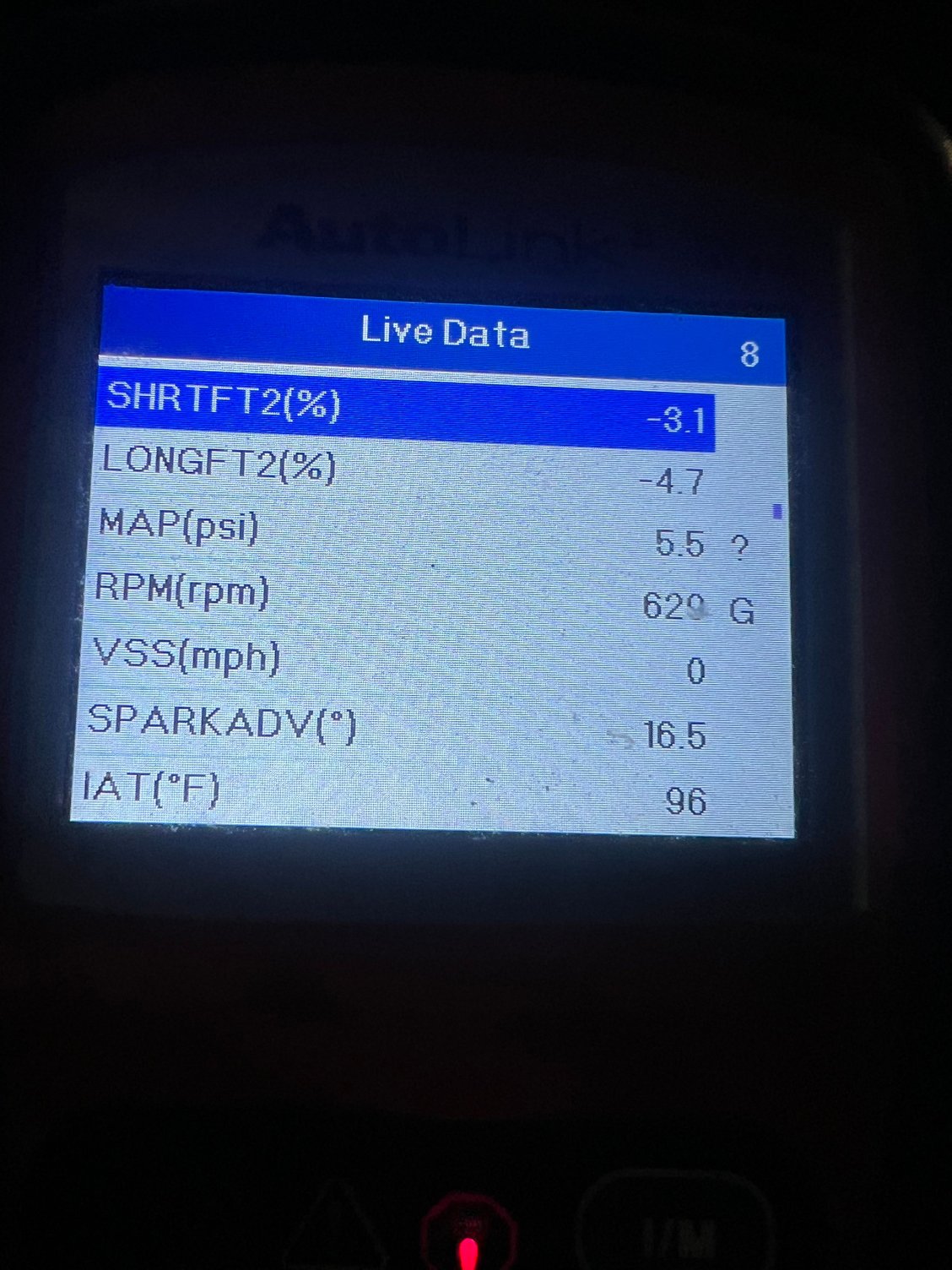

Okay here is bank 2 at idle when warm

Your fuel trims are typical for an engine of this age and the values are negative which means that the computer is reducing fuel delivery based on a perceived rich condition, the opposite of any unmetered air/vacuum leak.
