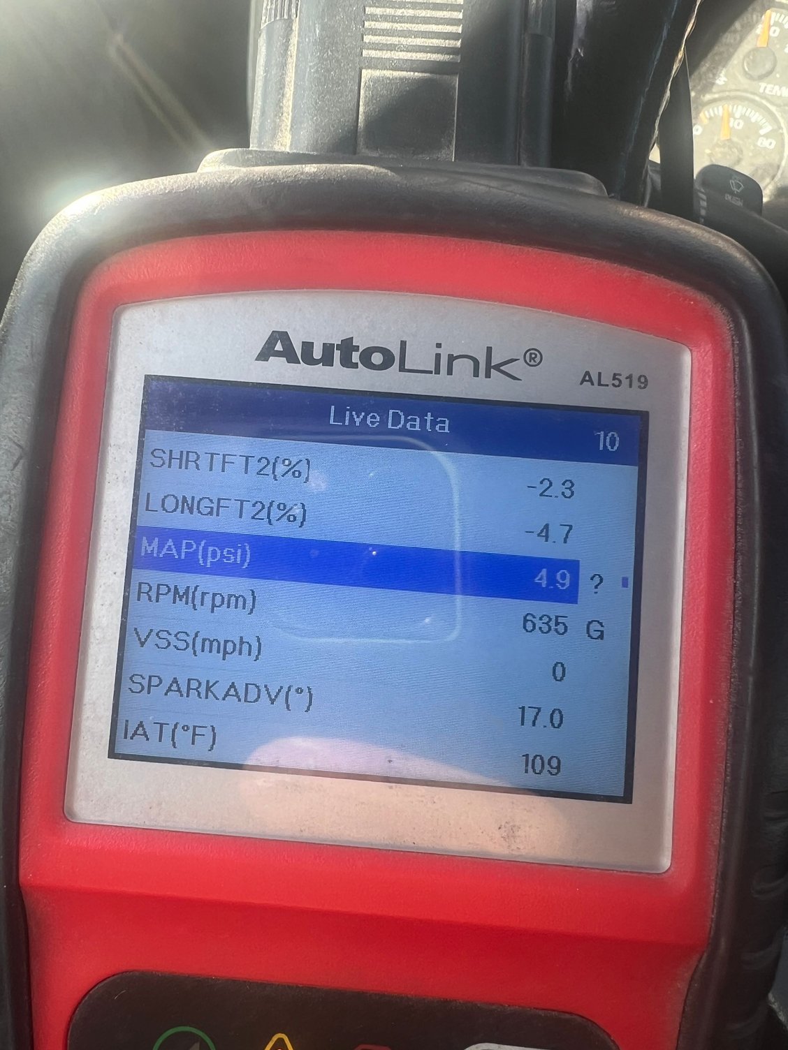

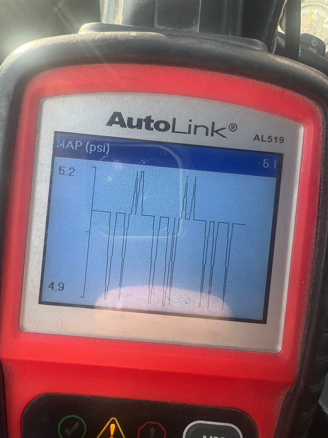

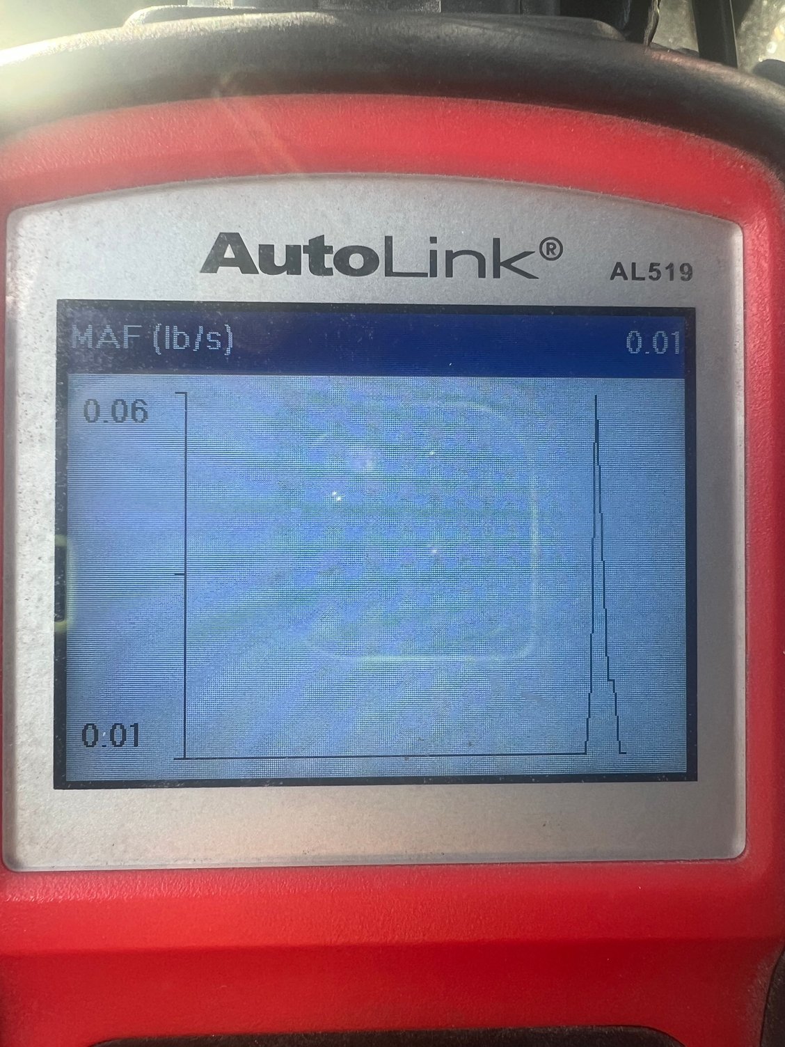

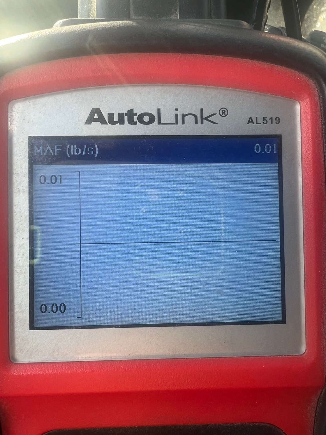

Here is also some graph pics from my scanner of the MAP sensor at idle and the MAF sensor at idle along with just revving the throttle. I think the graphs look a little weird or maybe I’m not interpreting them correctly.
I would greatly appreciate some thoughts.

The vacuum test is OK. The definitive test is an exhaust back pressure gauge in a front O2 port. A shade tree test is remove a front O2 sensor and see if it runs better.
If you want to get good MAF numbers. Record at idle and either the full throttle 1-2 shift or Les' brake torque method (not in front of the garage door).
Compare your MAP reading at key on to the local weather report.

Default MAF and MAP values are normal
I went ahead and did some more research and converted the values for MAP and MAF and they are about right where they should be at idle. I also hear that it could very well be a lower intake manifold gasket as opposed to a plenum gasket leak which would make a more general vacuum leak that would hiss loud at idle. I was thinking about smoke testing the engine. I don’t want to buy a an expensive pressurized smoke machine, I heard about using a cigar. Also, I might even be tempted to pull the heads and redo the valve stem seals and hand lap the valves. As I recall when I did a 350 vortec it wasn’t much more to pull the heads and it might already have the horrible abs plastic intake manifold gaskets that like to fail and mix oil with antifreeze. I will be using the Felpro steel and rubber Permadry plus intake gaskets.
