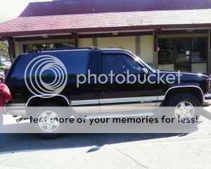

My name is Nathan. I am new to this forum and look forward to talking to all of you. I have a nice 93 blazer that I have done a lot of work to all ready.
Well today some thing new happened to my car. I was driving out in the country and lost all oil pressure. I was told it looked like my oil pump went out on it. This is one thing I have not had to mess with. I would love to know how big of a job I am getting into. If you know how to do this any info would be great. Here is a list of every thing I have done to my blazer so far.
