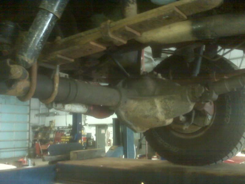

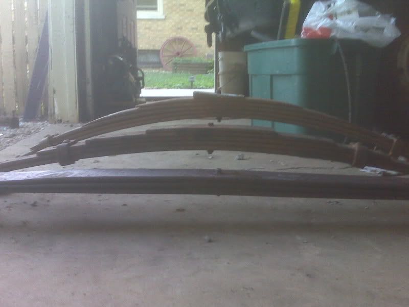

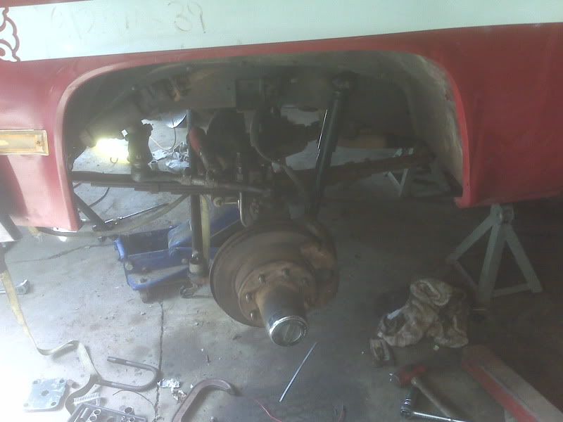

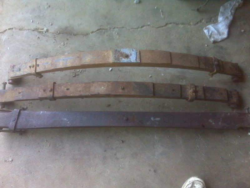

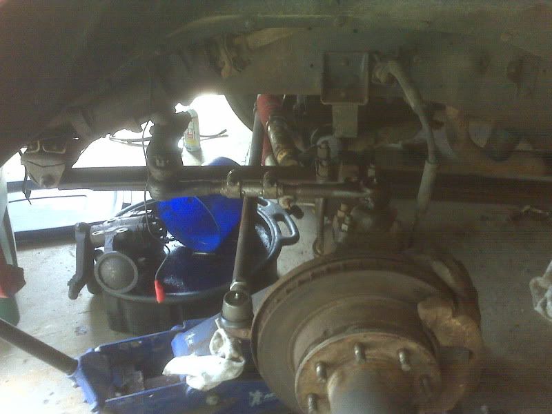

heres a bunch of pictures that should clear things up
heres 3 different front leaf springs. goes from 0 lift to 4inch lift to 6 inch lift
heres some stock springs under a 85 k5 blazer thats that frowny face you were talking about
and then heres my saggy 4inch lift kit under my 86 k30 pick up

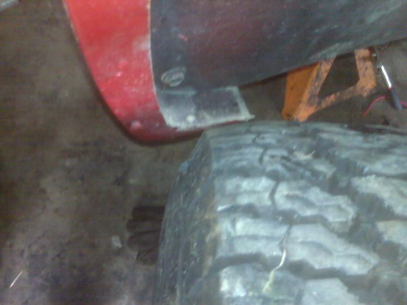

and heres the tire clearance i have when i turn, cant get no closer then that. its 33/12.50/15 tires on 10 wide rims with 3.5 backspacing
