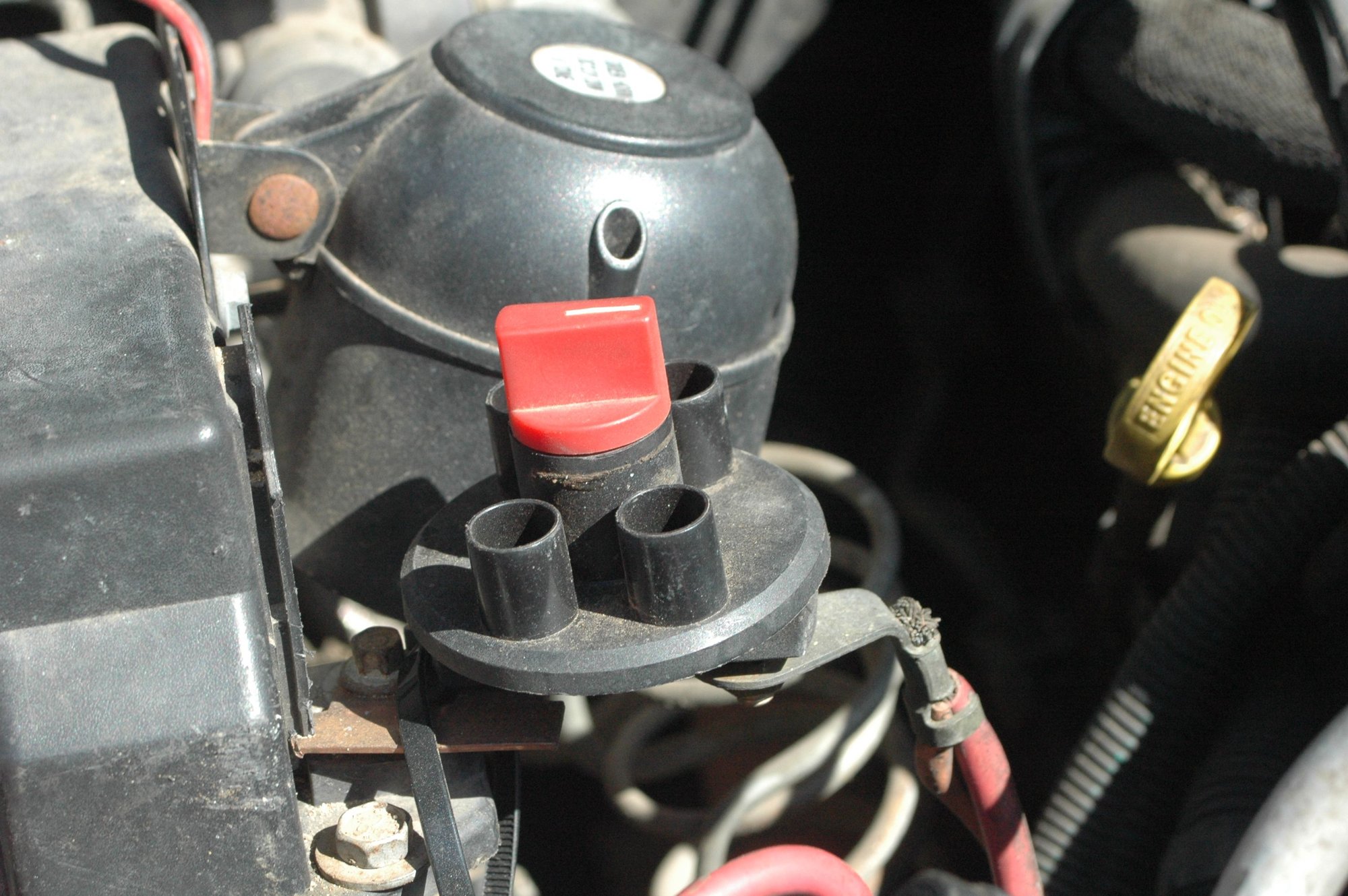

Old Aug 25, 2019 | 11:19 PM
John Riley's Avatar
Joined: Jul 2019
Posts: 24
John Riley is on a distinguished road
get some copper pipe squash it only has to be around 4 inchs long drill a hole so it will go over the fuse box post and just get a simple red topped switch around 40 or 50 amp put that in line will accept your terminals and if you want it to act as a kill switch sorry but you open the bonnet and turn the switch off it will kill all power there so you will have to unlock it with the key.. then open bonnet and turn it on but its a simple fix and no ones going to flog your wheels hopefully
I have also changed my battery to the top post style rather than the stupid on the side style, mine corroded up something shocking
