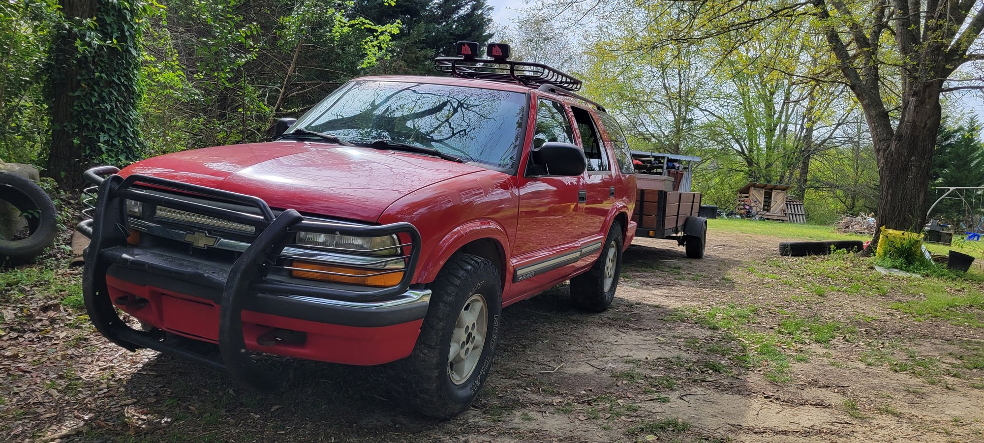

Got 31's on with only a lil hammer on the inside of front wheel well
